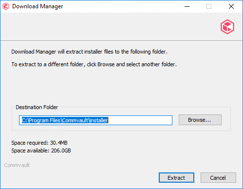

  2. Launch the Commvault software installation package.
    The Download Manager dialog box appears.
    embd_Installing the Standby CommServe Host procedure (9)
  3. Click Extract.

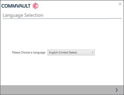

  4. Select the language from the Please Choose a Language list, and then click the arrow to proceed.
    The Welcome page appears.

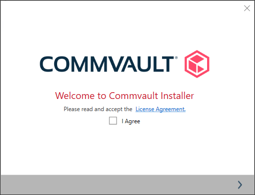

  5. Select the I Agree check box, and then click the arrow to proceed.

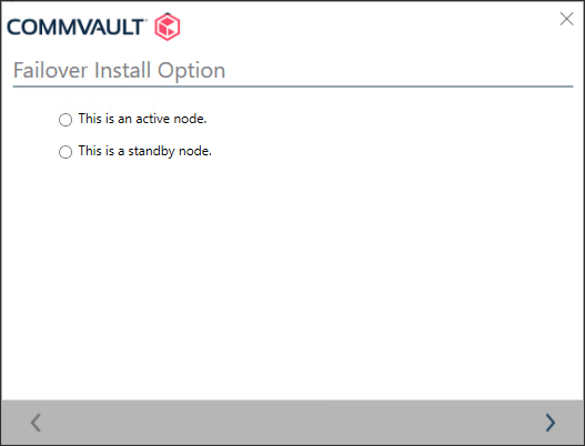

  10. The Failover Install Option page appears.
    embd_Installing the Standby CommServe Host procedure (14)
  11. Select This is a standby node, and then click the arrow to proceed.
    The Installation Path page appears.

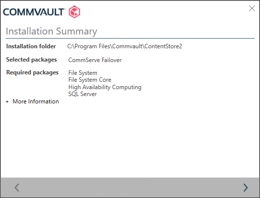

    The Installation Summary page appears.
    embd_Installing the Standby CommServe Host procedure (16)
  13. Verify the list of packages, and then click the arrow to proceed.

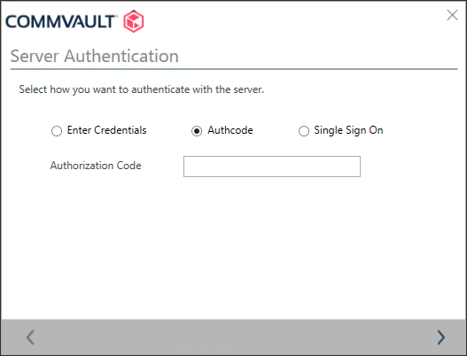

  16. Select an authentication method for accessing the production CommServe host, and then click the arrow to proceed.
    This completes the SQL Client installation and the following prompts are displayed for installing the standby CommServe client.

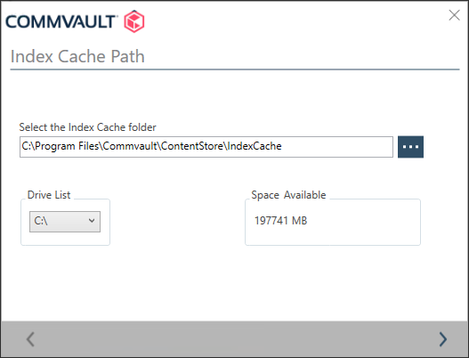

    The Index Cache Path page is displayed.
    embd_Installing the Standby CommServe Host procedure (23)
  19. Verify the index cache path (or specify a new path), and then click the arrow to proceed.

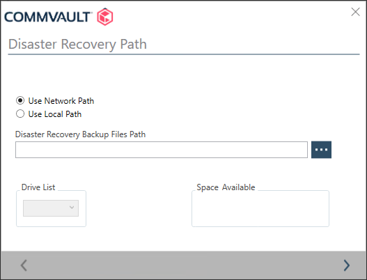

    The Disaster Recovery Path page appears.
    embd_Installing the Standby CommServe Host procedure (25)
  22. Select Use Network Path or Use Local Path, enter the path in Disaster Recovery Backup Files Path, and then click the arrow to proceed.

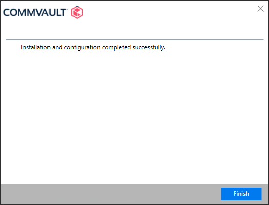

    The software creates the databases and services. This process may take a few minutes.
    A message similar to the following appears:
    embd_Installing the Standby CommServe Host procedure (27)
  24. Click Finish to complete the installation.
