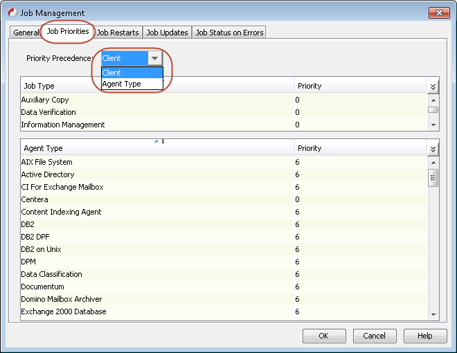

For a Client
On selecting Client priority precedence, the second digit represents Client priority and third digit represents Agent priority.
Use the following steps to set Client Priority Precedence:
  1. From the CommCell Console ribbon, on the Home tab, click Control Panel.
  2. Under Data, click Job Management.
  3. Click the Job Priorities tab.
  4. Select Client from the Priority Precedence box.
  5. Click OK.
set_prty_prcdnc_cnt

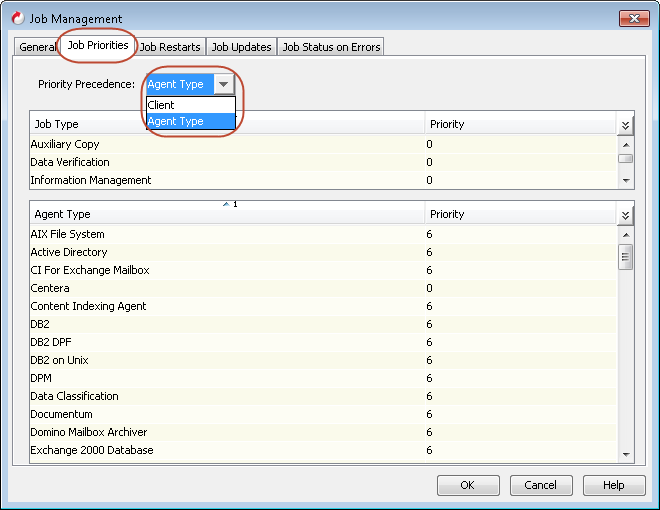

For an Agent
On selecting Agent Type priority precedence, the second digit represents Agent priority and third digit represents Client priority.
Use the following steps to set Agent Priority Precedence:
  4. Select Agent Type from the Priority Precedence box.
  5. Click OK.
set_prty_prcdnc_agt

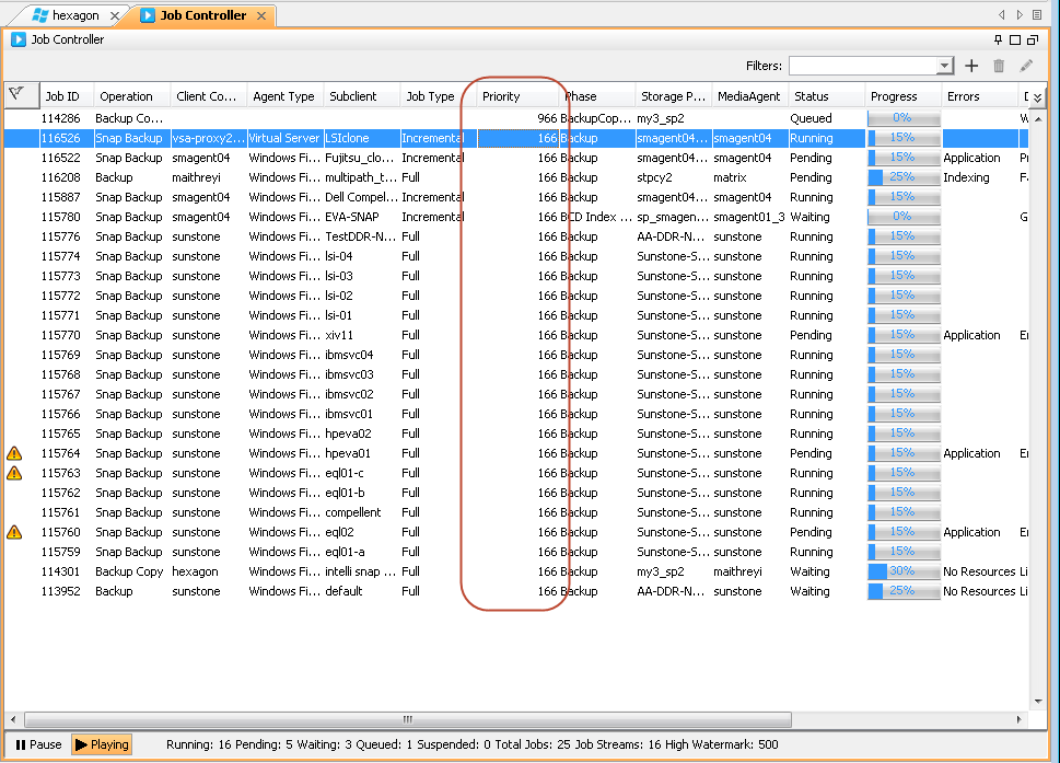

You can view the priorities of all jobs in the Job Controller window. By default, the Job Controller window does not display the priorities of running jobs. To view the job priorities for all jobs, you need to enable the Priority column.
Use the following steps to view all job priorities:
  1. From the CommCell Console toolbar, click Job Controller.
  2. In the Job Controller pane, right-click any table header or click the double arrows located on the extreme right to display table menu.
  3. Click Choose Columns and then select Priority.
  4. In the Job Controller window, the Priority column indicates the priority numbers for all jobs listed.

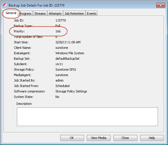

You can view the priority assigned to a specific job by viewing the details of the job.
Use the following steps to view priority of a specific job:
  2. In the Job Controller pane, right-click an active job and select Detail.
  3. You can view the Priority of the selected job under the General tab.
prty_onejob

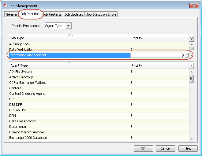

Use the following steps to change the priority of administration jobs:
  4. Select a Job Type and enter the priority value in the Priority column.
    The lower the value, the higher the priority of the agent.
  5. Click OK.

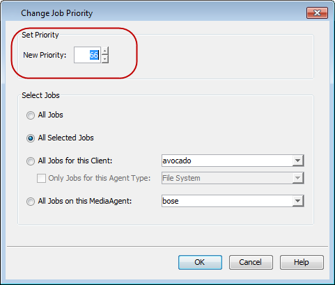

For an Active Job
Use the following steps to change the priority for an active job:
  1. From the CommCell Console ribbon, on the Home tab, click Job Controller.
  2. In the Job Controller window, right-click an active job, and then click Change Priority.
  3. In the Change Job Priority dialog box, enter or select a value from 0 (highest priority) to 999 (lowest priority) in the New Priority box.
  4. Click OK.
change_prty_job

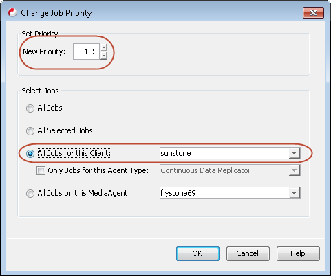

For a Group of Active Jobs
Use the following steps to change the priority for a group of active jobs:
  4. In Select Jobs pane:
    • Select All Jobs to change the priority of all active jobs.
    • Select All Selected Jobs to change the priority of all highlighted jobs.
    • Select All Jobs for this Client to change the priority of jobs of a particular client and then select the client. You can also change the priority of jobs for a particular agent by selecting the Only Jobs for this Agent Type checkbox and then select the agent.
    • Select All Jobs on this MediaAgent to change the priority of jobs of a particular MediaAgent and then select the MediaAgent.
  5. Click OK.
change_prty_alljobs

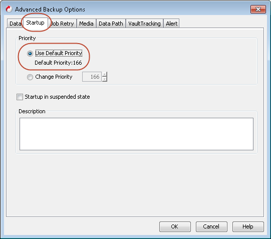

Setting the Default Job Priority
You can change the priority of a scheduled job from user-defined value to default value.
Use the following steps to set the default priority for a scheduled job:
  1. From the dialog box of an appropriate operation (such as backup, restore or auxiliary copy) click Advanced.
  2. From the resulting dialog box click the Startup tab.
  3. Select Use Default Priority.
  4. To start the job in a suspended state, select the Startup in suspended state check box.
  5. Click OK.
change_prty_dflt
