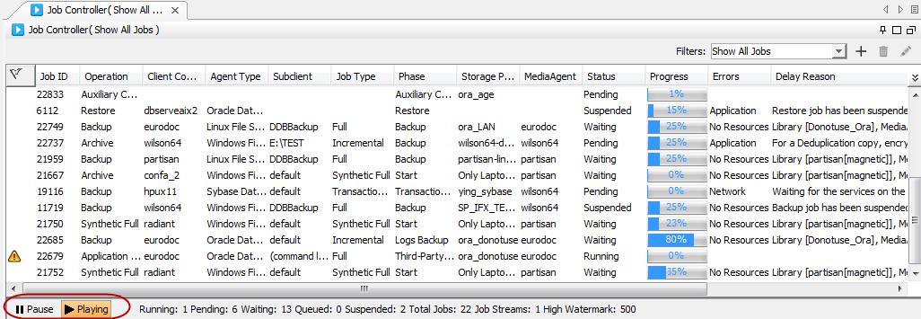

Real Time Information for Active Jobs
The Pause pause and Play play buttons allow you to control how the Job Controller displays real time information from active jobs. The Pause button stops the Job Controller from displaying real time information collected from jobs. The Play button allows the Job Controller to display real time job updates.
To see all the columns in the Job Controller window, use the scroll bar at the bottom of the window.
Use the following steps to view the real time job updates from Job Controller window. This is a default setting:
  1. From the CommCell Console ribbon, on the Home tab, click Job Controller.
  2. In the bottom left of the Job Controller window, the Play button is selected and displays the real time job updates.
