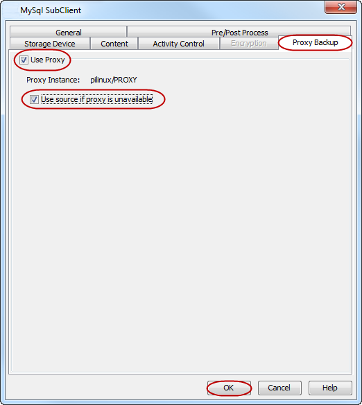

Enabling the Failover to Source If Proxy Is Unavailable
By default, the backups will be performed on the proxy server. However, you can opt for the backup to be performed on the production (master) server, If the proxy server is offline or unavailable.
Use the following steps to enable the backups on a master server, if the proxy is unavailable:
  1. From the CommCell Browser, navigate to Client Computers | <Client> | MySQL | master <Instance>.
  2. Right-click the <subclient> and then click Properties.
    config_sub_01
  3. Click the Proxy Backup tab.
  4. Select Use Proxy.
  5. Select Use source if proxy is unavailable.
    adv_source_ifnot_proxy - backupklzzwxh:0039ysqlklzzwxh:0040roxybackupklzzwxh:0041dv_source_ifnot_proxy.png

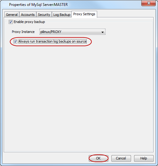

Performing the Transaction Log Backups at Source
If you are using multiple proxy servers in a multi-level replication environment, it is always better to perform the transaction log backups on a master server. Also, the proxy sever might contain some events related to proxy-only operations such as the creation of non-replicated tables, temporary tables and their queries. You may not need to backup these transactions. Hence, you can choose to perform the log backups on a master server.
Use the following steps to set and perform the log backups on a master server:
  1. From the CommCell Browser, navigate to Client Computers | <Client> | MySQL.
  2. Right-click the master <Instance> and then click Properties.
    config_instance
  3. Click the Proxy Settings tab.
  4. Select Enable proxy backup.
  5. Select Always run transaction log backups on source.
    adv_trans_logs - backupklzzwxh:0062ysqlklzzwxh:0063roxybackupklzzwxh:0064dv_trans_logs.png

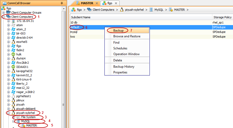

Use the following steps to delete the logs on the master server:
  1. From the CommCell Browser, navigate to Client Computers | <Client> | MySQL | <Master> <Instance>.
  2. Right-click the <subclient> and then click Backup.
    The Backup Options for Subclient dialog box appears.
    proxy_bkp_proc_01 - backupklzzwxh:0089ysqlklzzwxh:0090roxybackupklzzwxh:0091dv_truncate_logs.png
  3. Select Truncate Logs on Source check box. You can view this option only if you enable proxy (Use Proxy) both at the instance and the subclient level.
  4. Click OK.

Use the following steps to enable the deletion of logs on proxy server:
    proxy_bkp_proc_01 - backupklzzwxh:0119ysqlklzzwxh:0120roxybackupklzzwxh:0121dv_truncate_logs.png
  3. Make sure to clear the Do Not Truncate Log on Proxy check box.
  4. Click OK.
