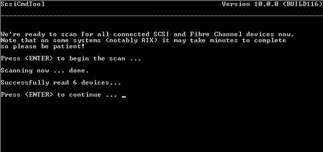

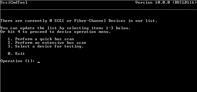

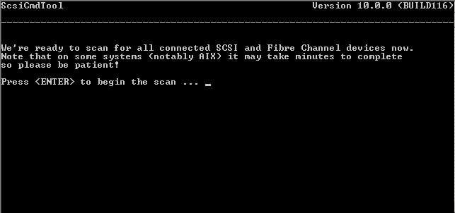

  3. Press Enter to read the devices.
    The tool detects the devices and a message similar to the one shown in the sample, will be displayed.
    scsicmdtool_03

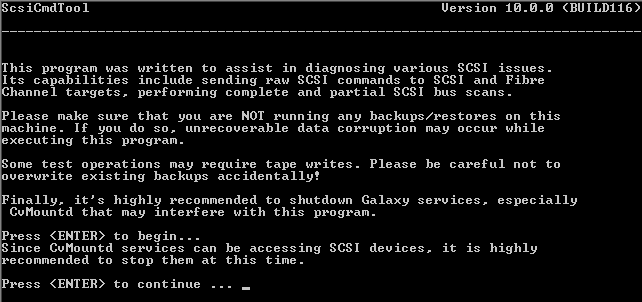

  4. Press Enter.
    scsicmdtool_04

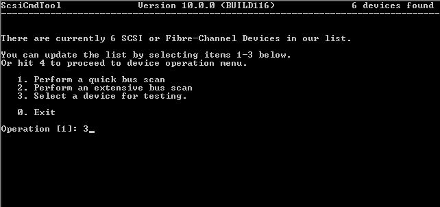

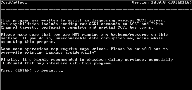

  5. Press Enter.
    scsicmdtool_06
  6. Type 3 to select a device for testing, and press Enter.
    scsicmdtool_07

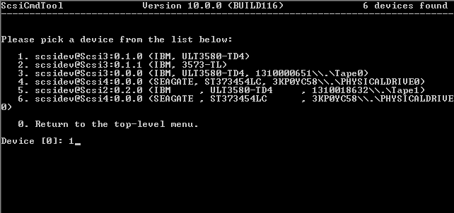

  7. A list of devices will be displayed. Type the device number to be selected and then press Enter.
    scsicmdtool_08

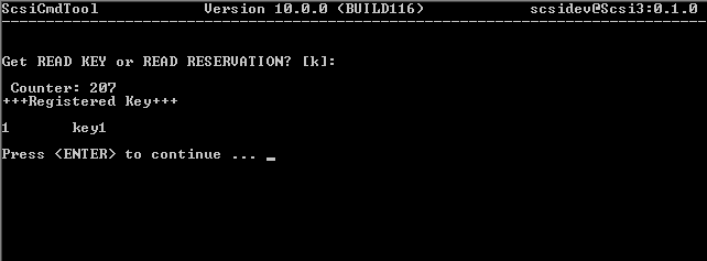

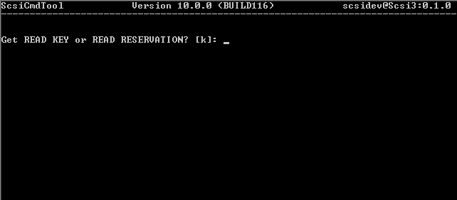

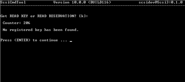

  8. Type the number associated with Persistent Reserve In. to query the data from the target and then press Enter.
    scsicmdtool_09
  9. Press Enter.
    scsicmdtool_10
  10. The tool should display a message similar to the one shown in the sample.
    Press Enter.
    • In some cases, a registered key may also be found.
    • If the tool displays a message similar to the following, SCSI-3 is not supported by the device.

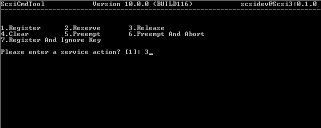

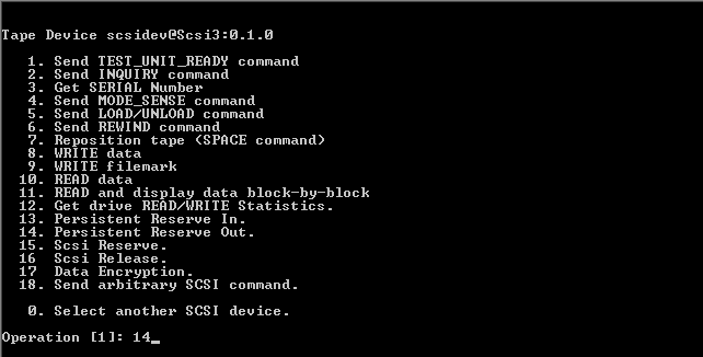

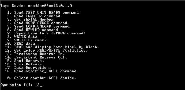

  11. Type the number associated with Persistent Reserve Out. to perform a task in the target device and then press Enter.
    scsicmdtool_12

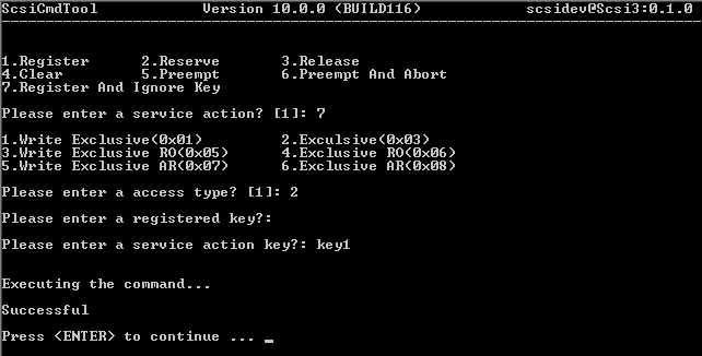

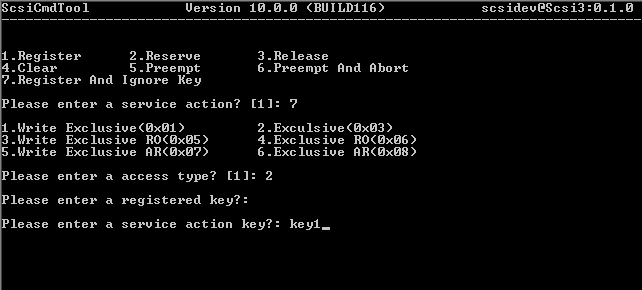

  12. Type the number associated with Register and Ignore Key and then press Enter.
    scsicmdtool_13
  13. Type 2 as Access Type and then press Enter.
    scsicmdtool_14
  14. Type key1 as Service Action Key and then press Enter.
    scsicmdtool_15
  15. The tool should display a message similar to the one shown in the sample if it has executed successfully.
    Press Enter.

  16. Execute the Persistent Reserve In. as described in steps above and make sure that the key is reserved.

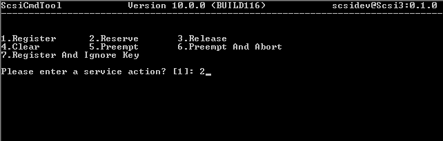

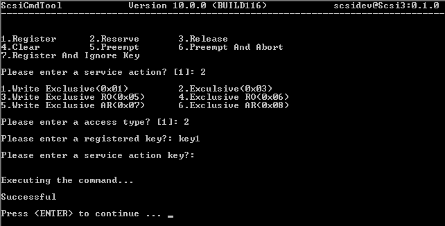

  18. Type the number associated with Reserve and then press Enter.
    scsicmdtool_18

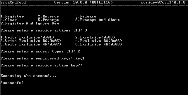

  21. Type the number associated with Release and then press Enter.
    scsicmdtool_20
  22. Press Enter.
    Type key1 as Registered Key and then press Enter.
    scsicmdtool_21
  23. The tool should display a message similar to the one shown in the sample if it has executed successfully.
