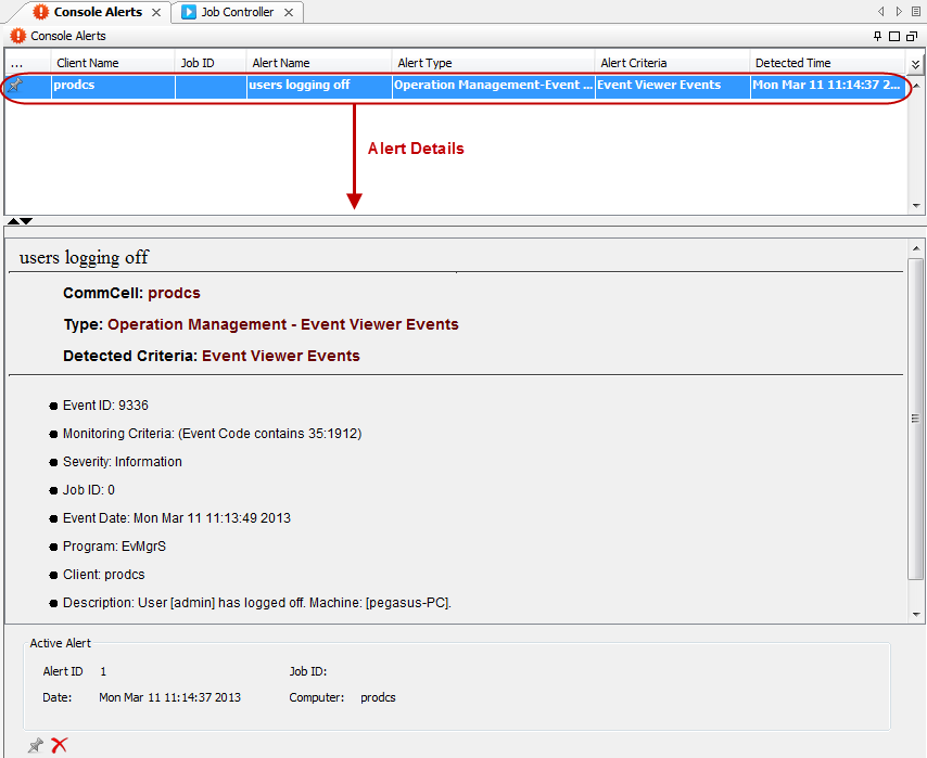

The following is an example of a Console alert:
test_console_alert

When the alert is triggered by the criteria you specified, a pop-up window is displayed in the CommCell Console. Click the pop-up window to view the console notification. For information about suppressing the pop-up window, see Suppressing the Pop-up Window for Console Alerts.
To view a list of previous console notifications, from the CommCell Console ribbon, on the Home tab, click the arrow under Alerts, and then select Console Alerts. From the Console Alerts window, the details of the latest notification are displayed in the lower pane.
