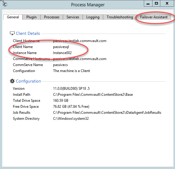

  3. Open the Process Manager associated with the SQL client.
    The SQL client will have the Failover Assistant tab as shown in the following sample image.
    Unplanned Failovers (1)
  4. On the Failover Assistant tab, select the following options:
