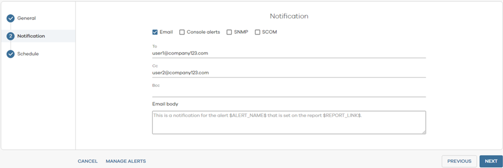

  10. Under Notification, specify the methods for sending alerts:
    • To send the alert in an email, select Email, and in the To, Cc, and Bcc box, type email addresses, and then enter any additional email text in the Email body box.
    • To send the alert through the CommCell Console alerts system, select Console alerts.
    • To send the alert using the Windows Event Viewer, select Windows event viewer, and then in the Description box, configure the alert message.
    The Event Viewer option cannot be configured for Linux CommServe computer.
    For more information on the alert types, see Alert Types.
    alert notification setting
