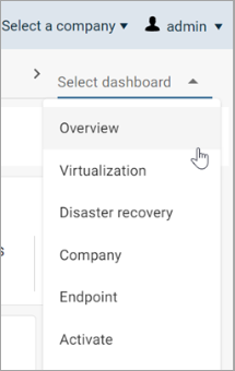

At the upper-right area of the page, from the list, select a default dashboard.
The dashboard appears.
