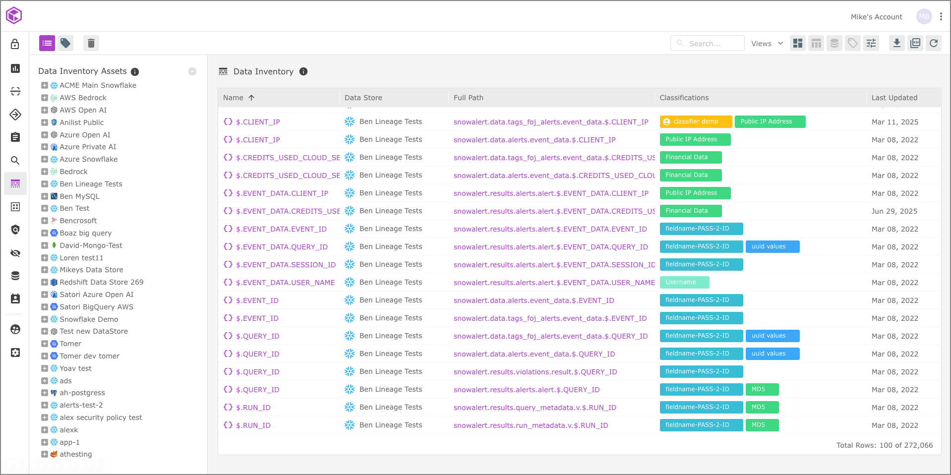

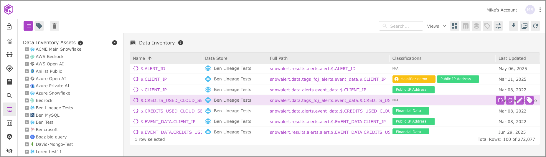

Data Inventory
Satori’s Data Inventory dynamically creates an inventory of the organization's data, featuring the built-in Satori classifications.
Screenshot
The data inventory provides a holistic view of the organization's sensitive data and access patterns and is augmented by powerful navigation, filtering and search functions
Learn more about Satori’s data classification & discovery capabilities and Schedule a demo meeting

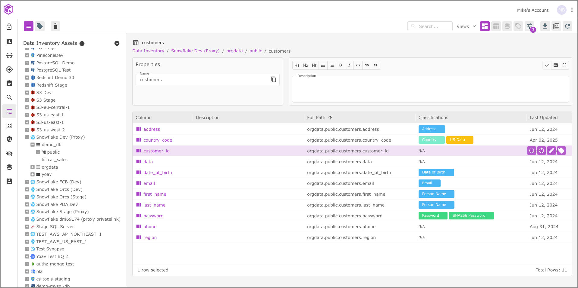

Viewing the Locations and the Classifier Taxonomy Trees
The Data inventory view provides you with two methods of viewing the inventory of your organization's data. You can switch between the locations tree and the taxonomy tree from the toolbar.
Clicking on a tree item filters the table to show the selected item, clicking clear resets the tree to show all the trees content.

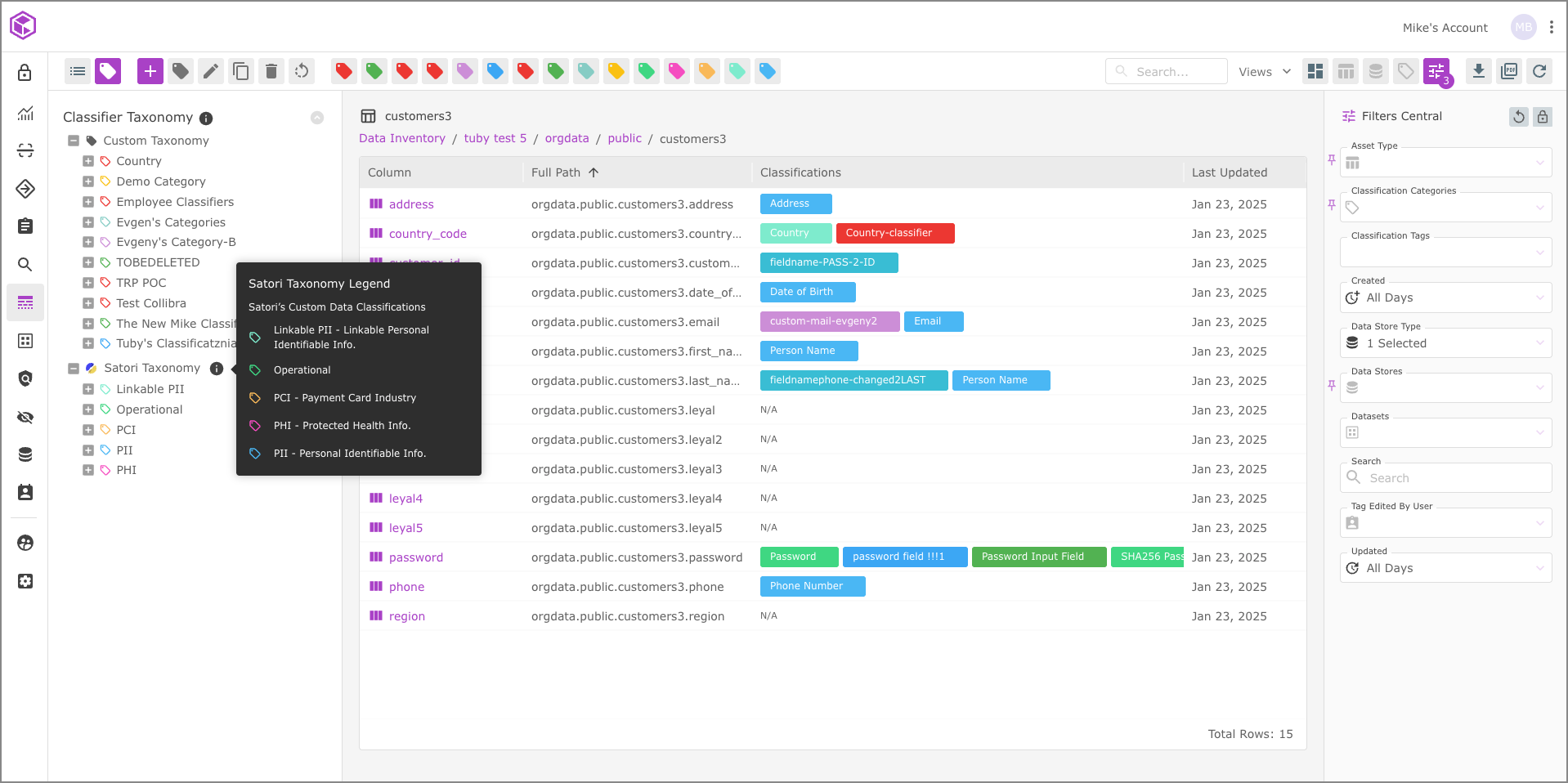

The Location Tree
Screenshot
The Classifier Taxonomy Tree
Screenshot

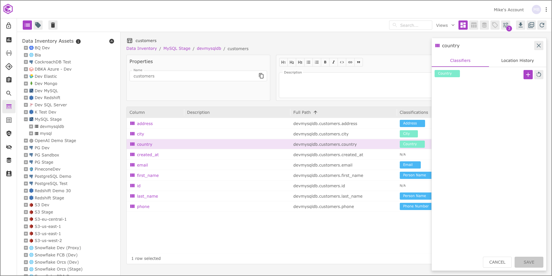

Making Classification Changes - Locations Details Pane
Satori enables you to make a classification changes. There are two methods for making classification changes.
If you decide to make a change to a classifier you are resetting its configuration. Thus your audit log will reflect the change only from the time of the change. All previous data for this classifier will be reflected in the audit log according to the previous classifier configuration.
  1. The first, is by clicking on the hyperlink for a specific classifier in the field name column of the table.
  2. The second, is by adding a new classifier to a dataset location by clicking on the plus icon to the right of each data field row.
The location details pane extends out on the right side of the Data Access Manager interface.
You must provide a reason for the classification change in the notes input field provided. The change is then audited and made available via the Satori audit view.

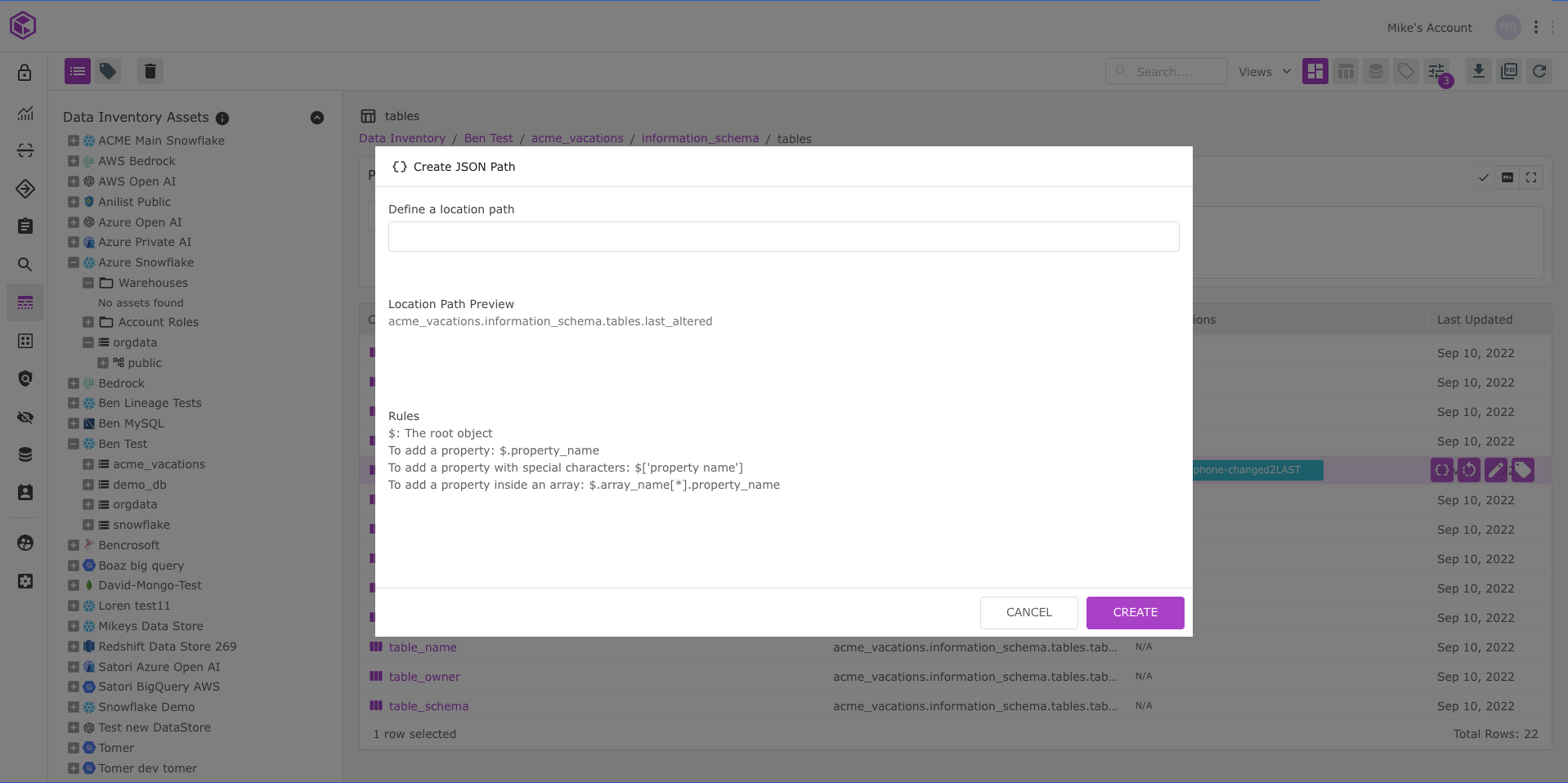

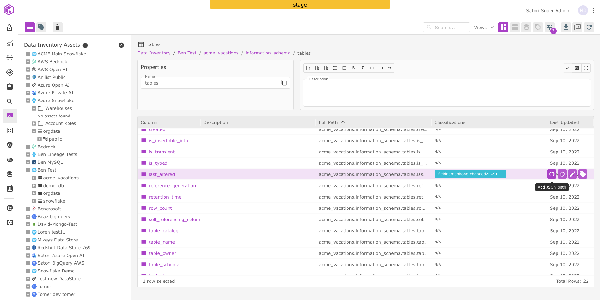

Adding a New Semi-Structured Location
To add a new semi-structured location, navigate to the table containing the column where the data resides. Hover over the row for the desired column and click the Add JSONPath {} button .
Screenshot
Specify a new JSONPath in the Create JSONPath dialog. Click the Create and a new entry will appear in the table representing the semi-structured location.
Screenshot

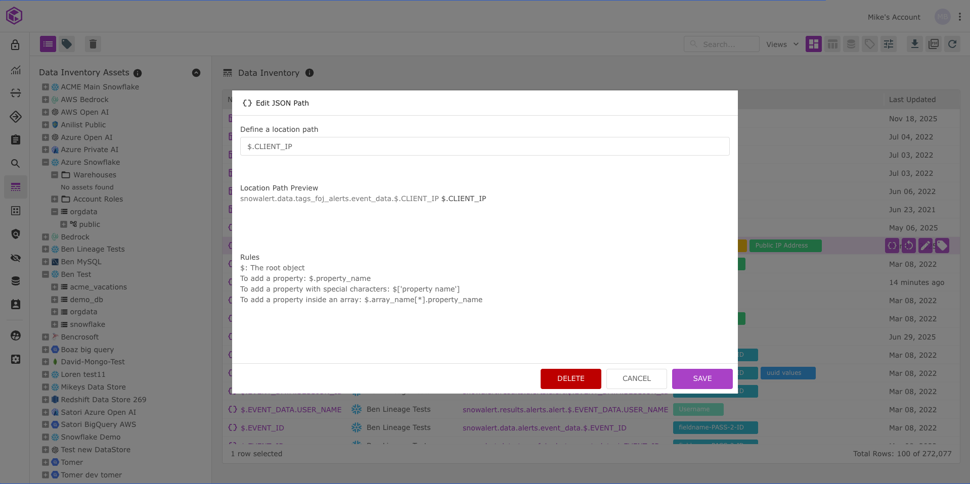

Editing an Existing Semi-Structured Location
To edit a semi-structured location, navigate to the table containing the column where the location resides. Hover over the row of the semi-structured location and select Edit JSONPath.

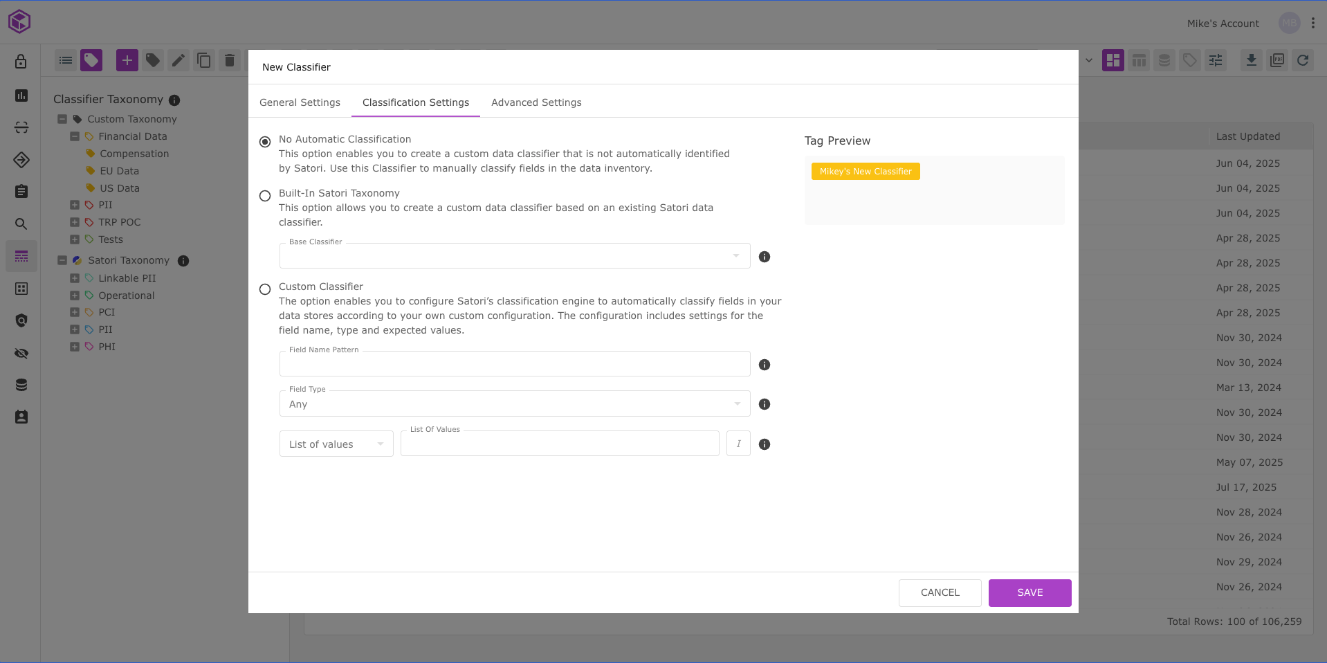

No Automatic Classification
The No Automatic Classification option enables you to create a custom data classifier that is not automatically identified by Satori. You can use this classification type to mark an inventory item regardless of whether it is recognized by Satori or not.
Built-In Classification
The Built-In Classification option is based on the Satori out-of-the-box classification taxonomy. By selecting the built-in classification option you couple your new custom data classifier to a Satori taxonomy category and/or data classifier.
This option leverages Satori classification algorithms to define this data classifier. By selecting built-in classification option you can further narrow the scope of the classifier to specific areas in the data store.
For example, if you assign an email data classifier to your new custom data classifier you limit the scope of data collection to a specific schema or table in your data store.
Custom Data Classifier
The Custom Classification option enables you to configure Satori’s classification engine to automatically classify fields in your data stores according to your own custom field name pattern.
You can define not only the field name pattern, but also its content and type. The field name pattern can be specified using the RE2 REGEX format. (Learn more about this format RE2 Notations Description).
The content can be set as a list of values or value patterns. In addition, you have to define the value type and can also define whether it is case sensitive or not.

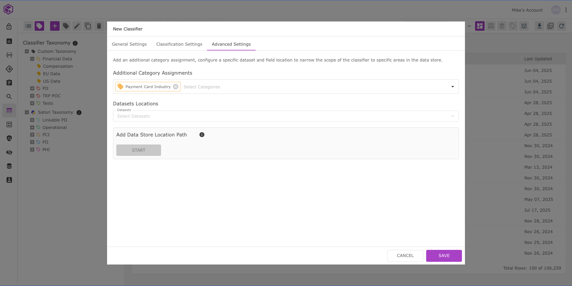

Advanced Settings
To further limit the scope of a classifier to a specific location in your dataset utilize the advanced settings tab options. There are there three available methods for limiting the classification scope. You can assign additional categories, select specific datasets and add multiple location paths.

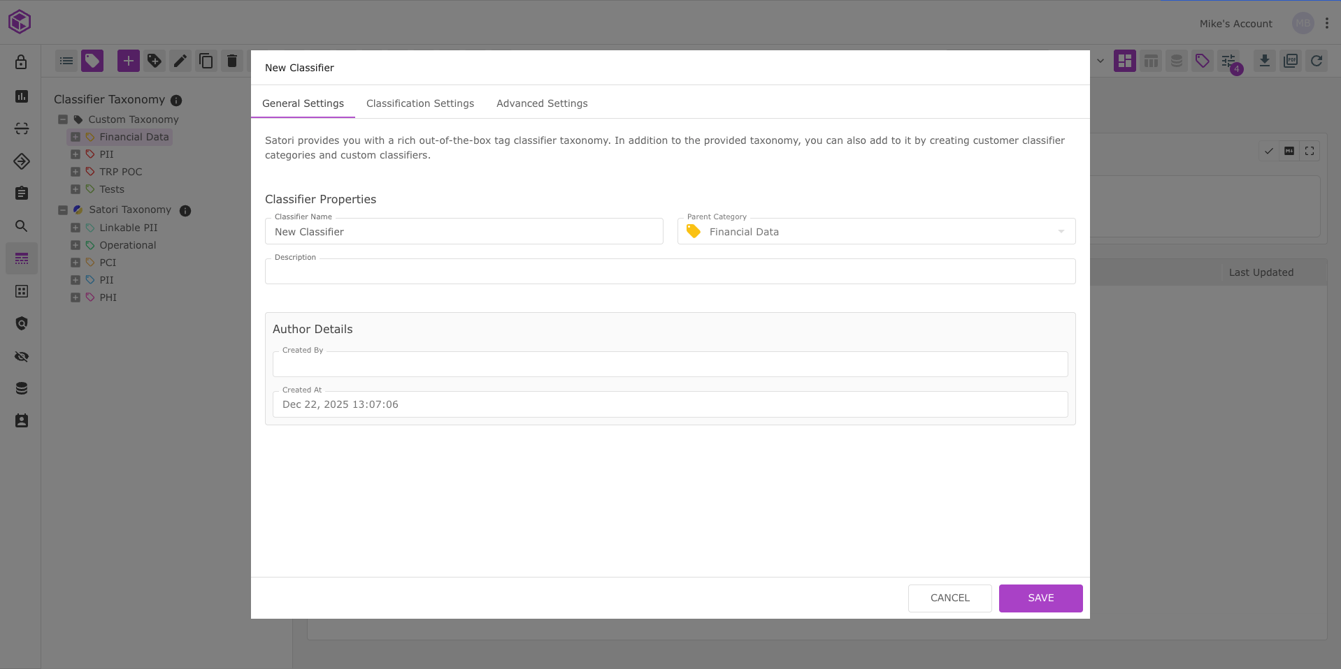

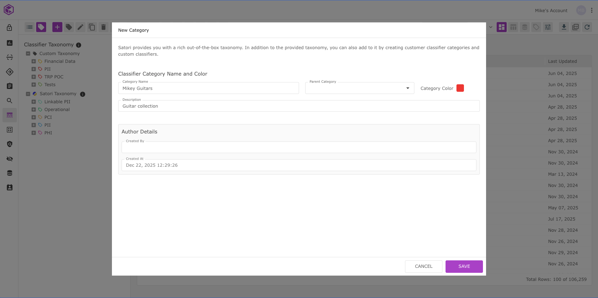

Adding a Data Category to Data Access Manager
To add a new Category to Data Access Manager perform the following steps:
  1. Go to the Data Inventory View.
  2. Click the Taxonomy view button.
  3. Place your mouse on the Custom Taxonomy list item and Right Click on your mouse or click the add Category button located in the Toolbar.
  4. Enter the new category name and provide a brief description.
  5. Select a custom color to use as your identifier for your new custom classification category. (Tip - Use a unique color not already in use)
  6. Click SAVE.

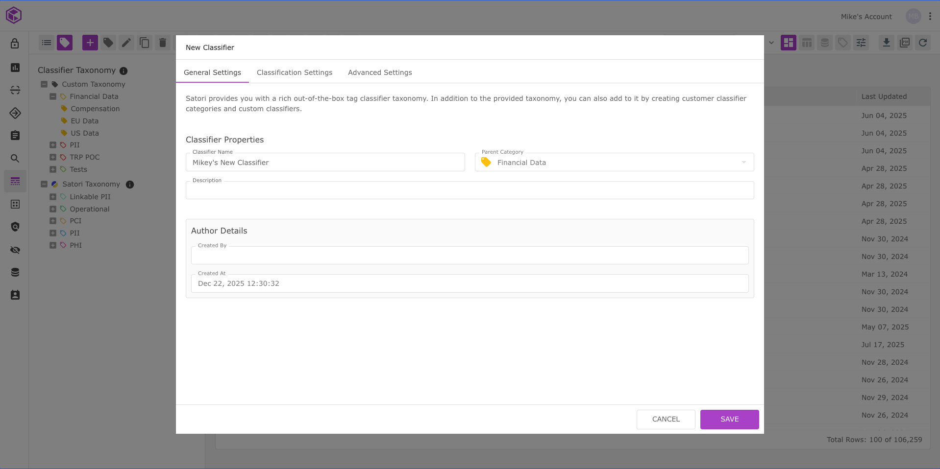

Adding a Classifier
Satori provides you with the ability to add new customer classifiers to your custom categories.
Screenshot
To add a new classifier to your custom category perform the following steps:
  1. Place your mouse on the Custom Taxonomy tree list item and Right Click your mouse or click the add Category button located in the Toolbar.
  2. Select the Add Classifier menu option or select the Add Classifier button from the toolbar.
  3. Provide your new classifier with a name and a brief description.
  4. Select the Classifications Tab.
  5. Choose one of the three available options based on your new classification requirements:
    a) No Automatic Classification - Use this classifier to manually classify fields in the data inventory.
    b) Built-In Classification - Use Satori's built-in classification algorithms for this classifier.
    c) Custom Classification - Configure Satori's classification engine to automatically classify fields in your data stores.
