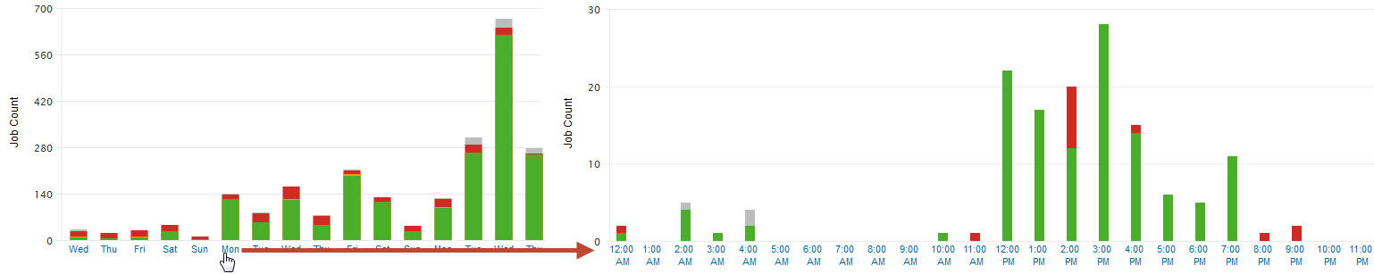

Hourly Backup Jobs
This report displays a table and chart that include information about jobs during each hour of the specified day.
After you first enable the Activity Report in the Control Panel, It can take up to seven days to retrieve the latest data for this report.
View this report by clicking on a day link under one of the bars in the Last 16 Days Backup Statistics Chart:
Hourly Backup Jobs on Date
This chart displays the number of jobs that completed, completed with errors or warnings, failed, or killed, during each hour of the specified day.
Hourly Backup Jobs
This table displays the number of jobs in each status during each hour of the specified date.

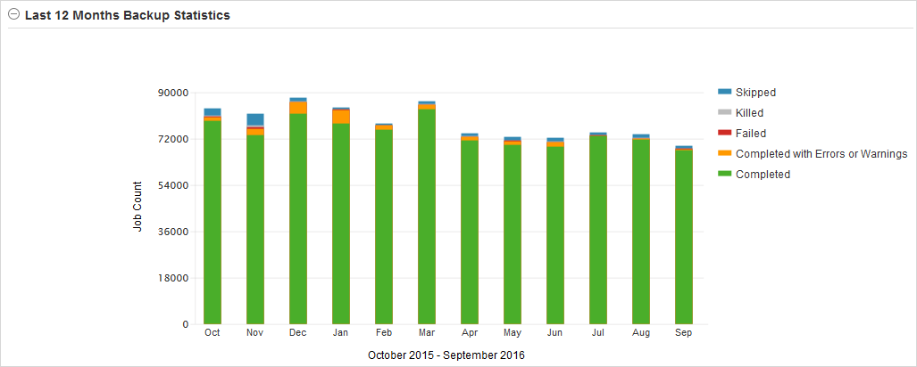

Last 12 Months Backup Statistics
This chart displays the number of jobs on each of the last 12 months that were killed, failed, completed with errors or warnings, or completed successfully. This chart can also display jobs that were scheduled to run but were skipped.
Job Status Table
This table specifies the total number of jobs in each status in each month, including the total number of jobs and the success percentage.

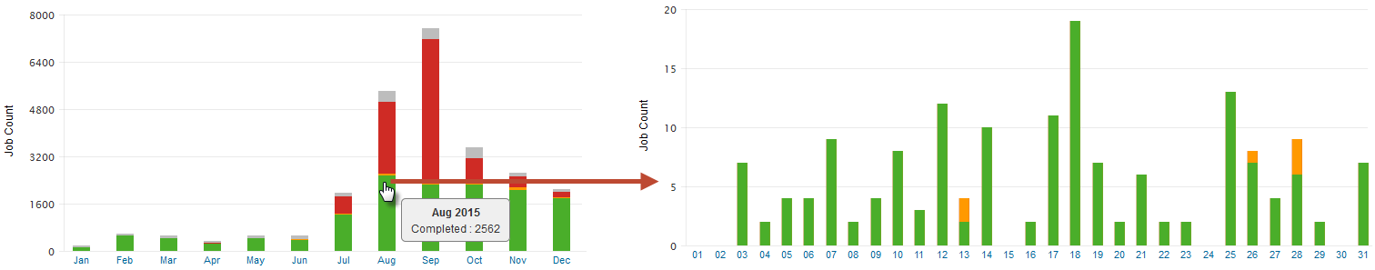

Daily Backup Jobs
You can view this report by clicking on a day or a bar in the Last 12 Months Backup Statistics Chart. You can view this chart only in the Activity Report on the Private Metrics Reporting Server.
This report displays a table and chart that include information about jobs on each day in the specified month.
Daily Backup Jobs on Month
This chart displays the number of jobs that completed, completed with errors or warnings, failed, or killed, on each day in the month.
Daily Backup Jobs
This table displays the number of jobs in each status during each day of the month.
