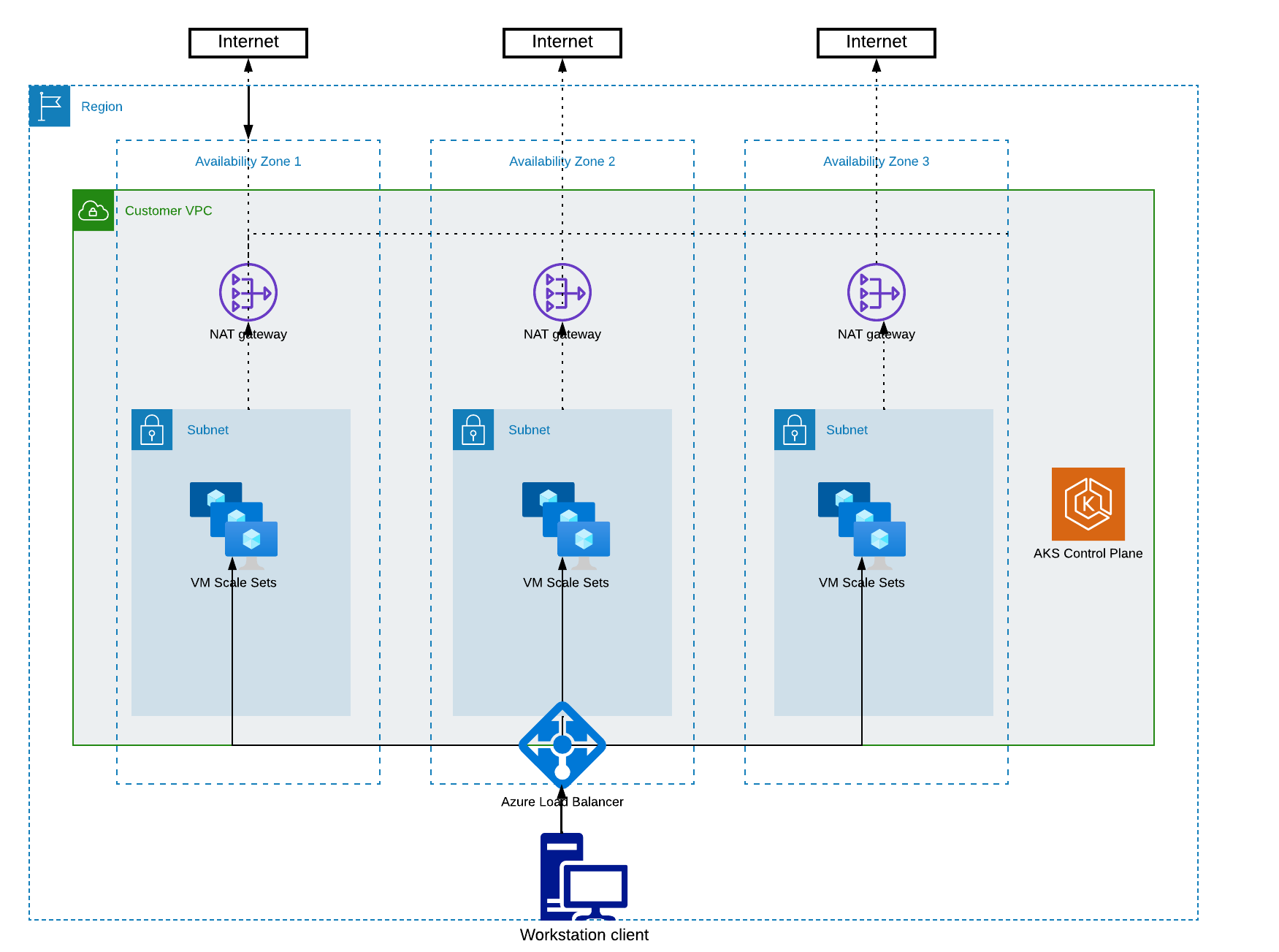

Screenshot
Illustration 1 - High Level Data Access Manager Deployment on Azure Architecture

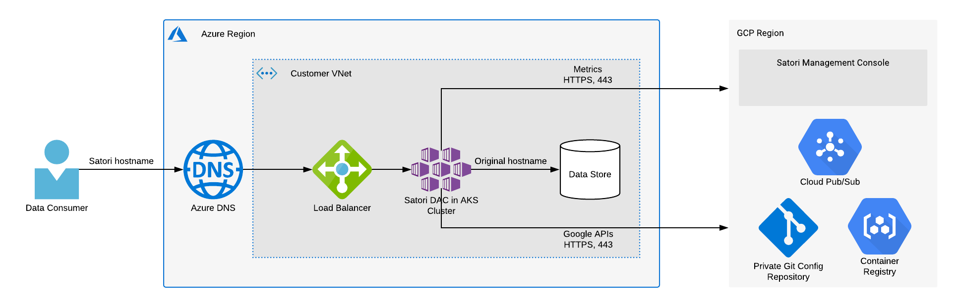

Screenshot
Illustration 2 - Kubernetes Cluster Architecture
The Satori CH DAC is accessed by the user, by using a dedicated hostname for each data store that the Satori CH DAC protects.
For example, to access a SQL Server database hosted in Azure East US at acme1.database.windows.net, data consumers will instead connect to acme1.eastus.z.p1.satoricyber.net..
The new hostname resolves to an internal-facing load-balancer that routes traffic to the Satori DAC inside the AKS cluster.
