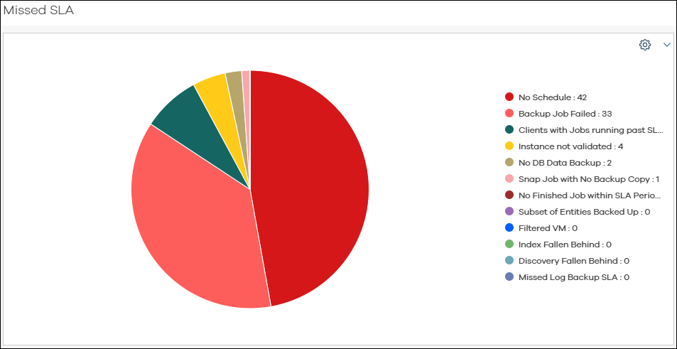

Missed SLA Chart
The Missed SLA chart displays the number of servers that missed the SLA threshold for each reason that backup jobs did not run.
To view this report, in the SLA Server Summary chart, click Missed SLA.
