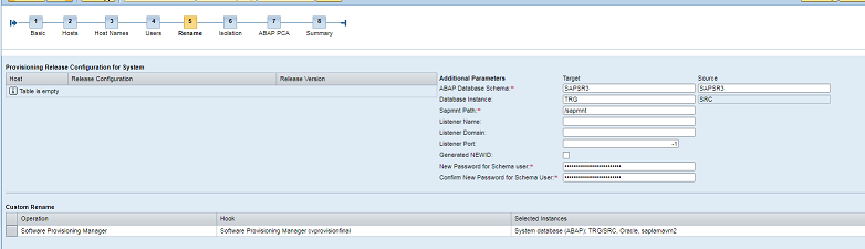

    2. On the Provisioning Release Configuration for System page, make sure that the Commvault provisions process is in the Hook field.
      Performing a Database Refresh (1)

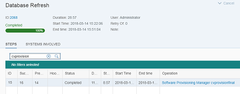

You can monitor the job in the SAP LaMa console. To get detailed information, click on the Database Refresh job, then in the search box, type the custom provisioning script name.
SAP LAMA Database Refresh Monitor
