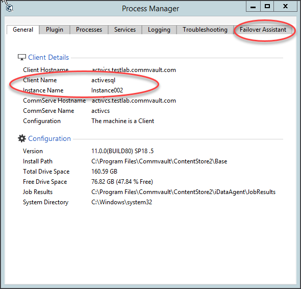

Click Commvault > Process Manager. Open the Process Manager associated with the SQL client.
The SQL client will have the Failover Assistant tab as shown in the following sample image.
On the Failover Assistant tab, select the following options:
From the Failover To list, click the name of the passive node that must be used for performing a test failover.
From the Failover Type list, click Test.
Click Initiate Failover.
On the Confirm prompt, type confirm and click Ok.
The failover is initiated and the sequence of tasks performed during the process is displayed in the Process Manager window.
