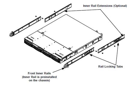

Identifying the Rack Rails
This rail will fit a rack between 26" and 33.5" deep.
The chassis package includes two rack rail assemblies in the rack mounting kit. Each assembly consists of two sections: an inner fixed chassis rail that secures directly to the server chassis and an outer fixed rack rail that secures directly to the rack itself.
Racking and Cabling (1)
Locking Tabs
Each inner rail has a locking tab. The tabs lock the server into place when installed and pushed fully into the rack. These tabs also lock the server in place when fully extended from the rack. This prevents the server from coming completely out of the rack when you pull it out for servicing.
Racking and Cabling (2)
The Inner Rail Extension (Optional)
The inner rails are pre-attached and do not interfere with normal use of the chassis if you decide not to use a server rack. Attach the inner rail extension to stabilize the chassis within the rack. If you are not using a rack, you do not have to install the inner rail extensions.
Use the following steps to install the inner rails:
  1. Place the inner rack extensions on the side of the chassis aligning the hooks of the chassis with the rail extension holes. Make sure the extension faces outward just like the pre-attached inner rail.
  2. Slide the extension toward the front of the chassis.
  3. Secure the chassis with two screws as illustrated. Repeat steps for the other inner rail extension.
Warning
Do not pick up the server by the front handles. They are designed to pull the system from a rack only.
Racking and Cabling (3)

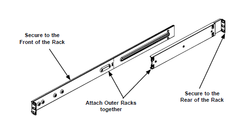

Outer Rack Rails
Outer rails attach to the server rack and hold the server in place. The outer rails for the SC815 chassis extend between 30 inches and 33 inches.
Use the following steps to install the outer rails to the rack:
  1. Attach the short bracket to the outside of the long bracket. You must align the pins with the slides. Also, both bracket ends must face the same direction.
  2. Adjust both the short and long brackets to the proper distance so that the rail fits snugly into the rack.
  3. Secure the long bracket to the front side of the outer rail with two M5 screws and the short bracket to the rear side of the outer rail with three M5 screws.
  4. Repeat steps 1-3 for the left outer rail.

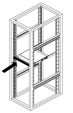

Installing the Chassis into a Rack
Use the following steps to install the chassis into a rack:
  1. Confirm that chassis includes the inner rails and rail extensions. Also, confirm that the outer rails are installed on the rack.
  2. Line chassis rails with the front of the rack rails.
  3. Slide the chassis rails into the rack rails, keeping the pressure even on both sides (it may be necessary to depress the locking tabs when inserting). When the server has been pushed completely into the rack, the locking tabs will click into the locked position.
  4. (Optional) Insert and tighten the thumbscrews that hold the front of the server to the rack.
Warning
Stability hazard. The rack stabilizing mechanism must be in place, or the rack must be bolted to the floor before you slide the unit out for servicing. Failure to stabilize the rack can cause the rack to tip over.
Racking and Cabling (4)
The above diagram is for illustrative purposes only. Always install nodes into racks from the bottom up.

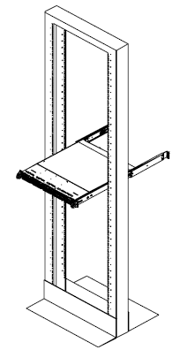

Installing the Chassis into a Mid-Mount Position (Telco) Rack
Use the following steps to install the chassis into a mid-mount position in the rack:
  1. Use the two L-shaped brackets on either side of the chassis (four total).
  2. Determine how far the chassis will extend out the front of the rack. Larger chassis should be positioned to balance the weight between front and back. If a bezel is included on your server, remove it.
  3. Attach the two front brackets to each side of the chassis, then the two rear brackets positioned with just enough space to accommodate the width of the telco rack.
  4. Finish by sliding the chassis into the rack and tightening the brackets to the rack.
