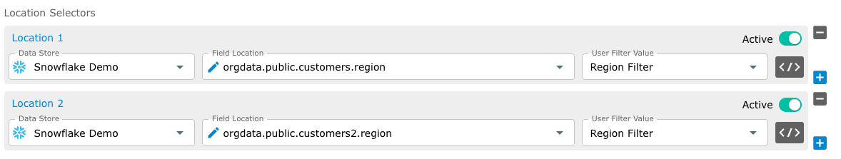

To add a location, select the data store and the field. You can add or remove locations by using the plus and minus buttons:

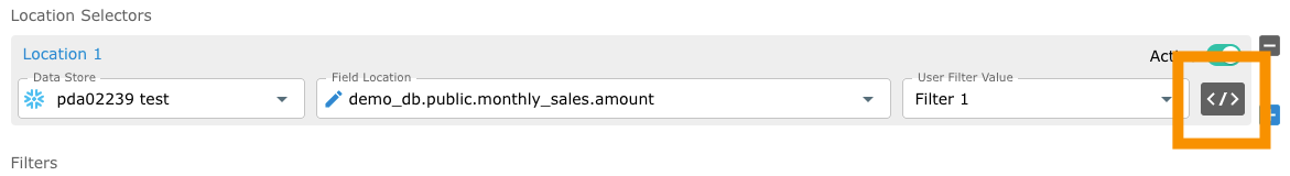

To access the Advanced Data Filter, select a data store and a location and then click the button on the right side of the User Filter Values input field.

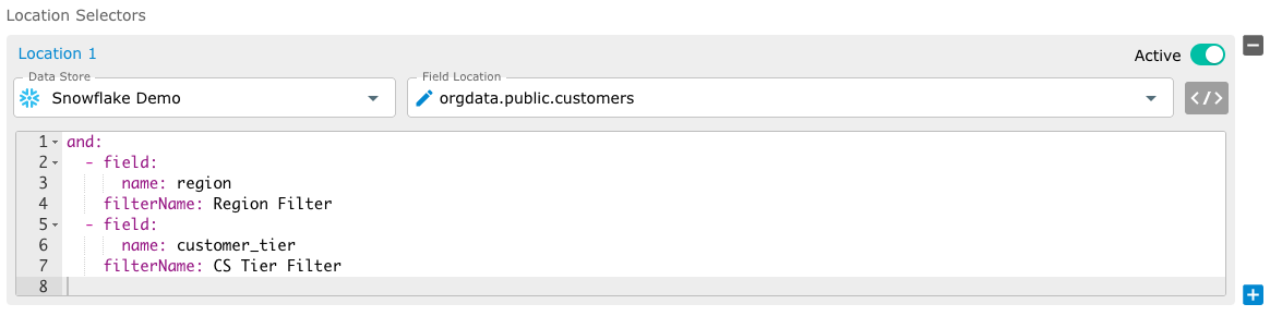

Writing the YAML Snippet
Consider the customers table from the previous example. If you want to filter the table by the customer_tier column for an EU team member who is also a member of the VIP Customer Success team, the filter would be comprised of two fields with a boolean AND relationship. In SQL, it would be represented as: region IN ('US') AND customer_tier IN ('VIP').
The following YAML snippet represents the structure of this filter:
Screenshot

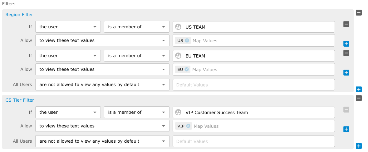

The following two user filter values sections define which values to dynamically use for each user:
Screenshot

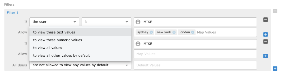

Once you select the users to filter data for, select which values they should see for the field you are configuring. You can choose from several options:

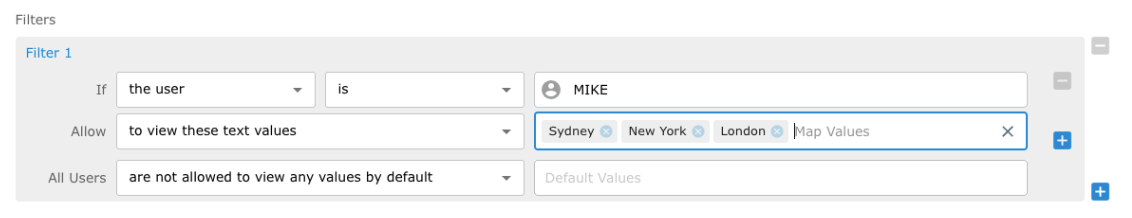

Example 1

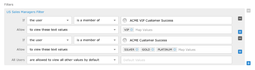

The following data filter example shows that MIKE is allowed to view the Sydney, New York and London values, while any other user will not be allowed to view any value.
Screenshot

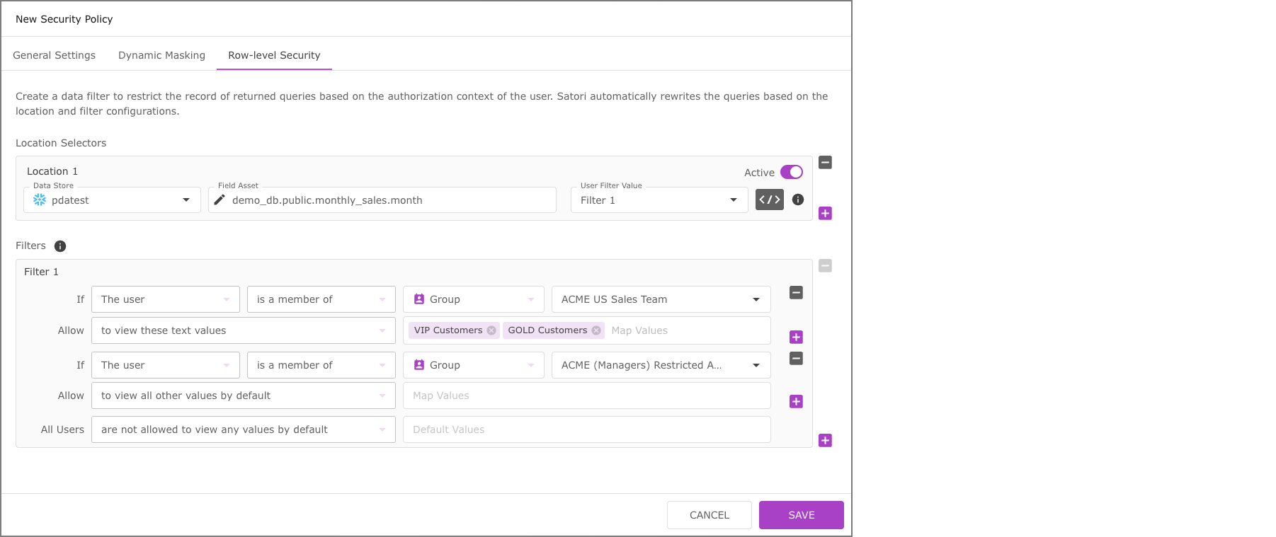

If you need to create a condition that includes a user and or a group to view specific data while excluding either a user or a group from viewing the same data value then you must create a multiple line If and Allow Condition rule.
Example 2
The following data filter example shows that member of the ACME VIP Customer Success team can view the VIP field value, members of the ACME Customer Success team they can view the SILVER, GOLD and PLATINUM field values and finally, all users can view field values except for VIP, SILVER, GOLD and PLATINUM.
Screenshot

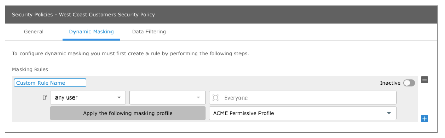

Renaming your Location Selectors and Data Filters
You can rename the locations and filters that you create with meaningful custom names or in accordance with your company naming policies.
  1. Place your mouse cursor over the name and click in the input field of your newly created rule of filter and rename it.
  2. Click in the blank space to save the new masking rule or filter name.
Screenshot
