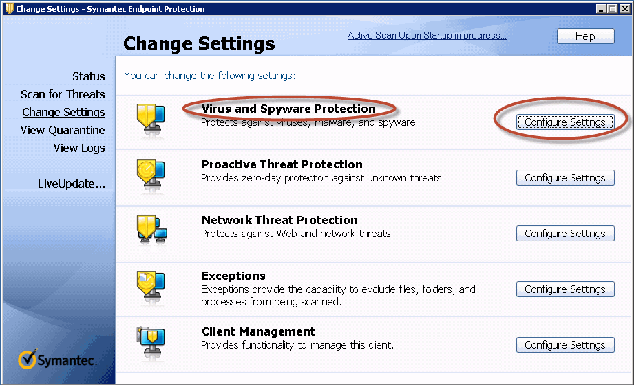

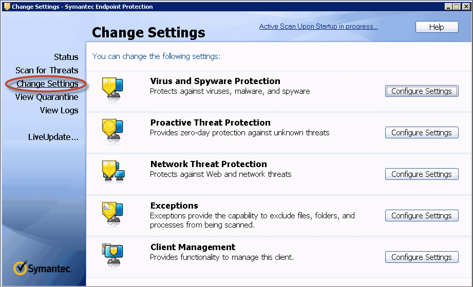

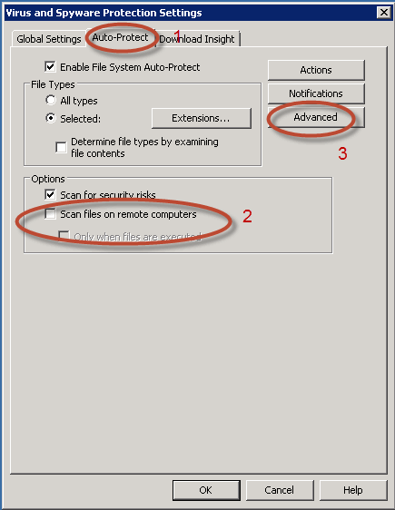

On the System Tray double-click the Symantec Endpoint Protection.
In the left pane click the Change Settings tab.
From the Virus and Spyware Protection section, click the Configure Settings button.

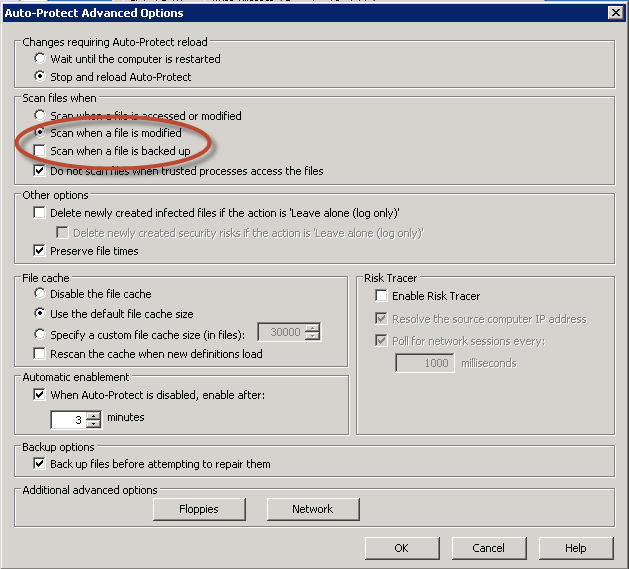

Click the Auto-Protect tab and clear the Scan files on remote computers checkbox. Click Advanced.
Under the Scan Files when section, click the Scan When a file is modified and clear Scan when a file is backed up checkbox. Click OK.

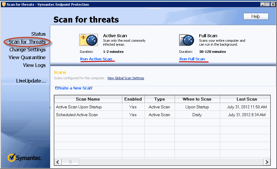

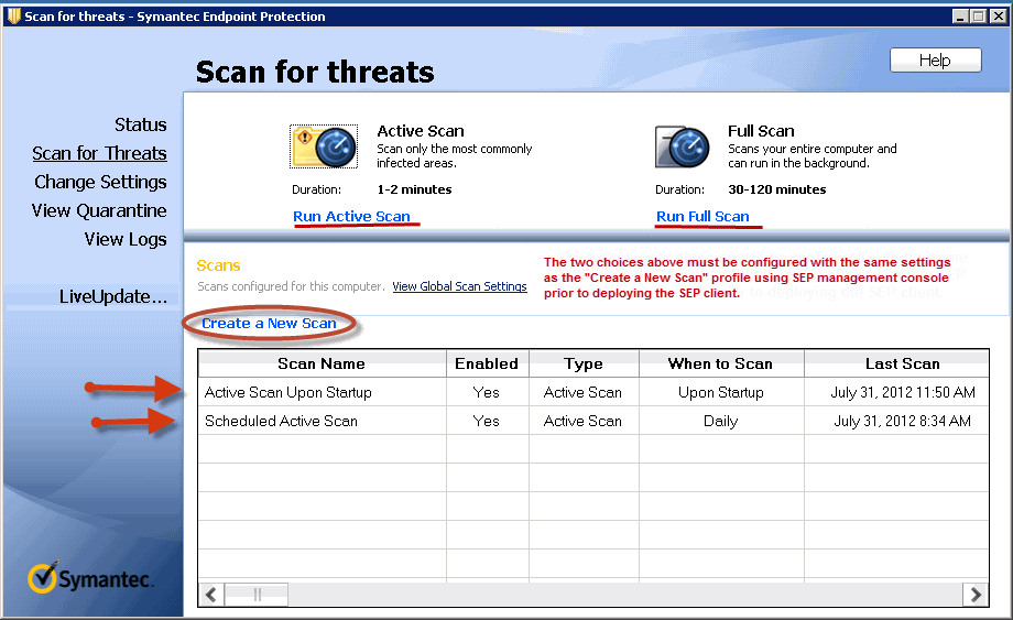

On the Symantec Endpoint Protection console click the Scan for threats tab.
For any Symantec Endpoint Protection Management Console (SEP MC) controlled or policy scheduled scans ensure that the "Run Active Scan" and the "Run Full Scan" profiles are configured prior to deploying the SEP Client.
This can be done through the SEP MC by setting up a Group Policy configuration that is enforced for the two choices.
Otherwise make sure to de-activate the two choices on the SEP Client server.
Creating Custom Scheduled Scans
Each scan type must have a profile created that follows the same settings. Make sure these profiles are the only ones used for Client side scheduled scans or for manual scans.
Follow the steps given below to create profiles for each type of scan:

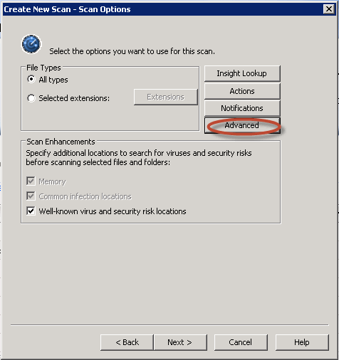

On the Symantec Endpoint Protection console click the Scan for threats tab and click Create a New Scan.
Click Next.

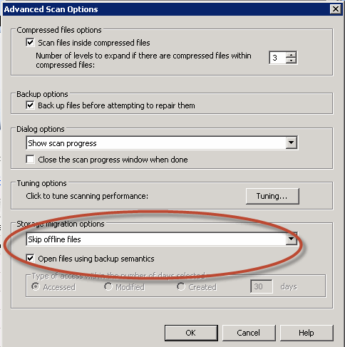

Click the Advanced button.
From the Storage Migration options list select Skip offline files.
Click the Open files using backup semantics checkbox.
