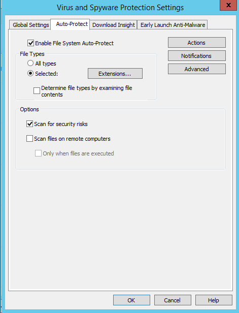

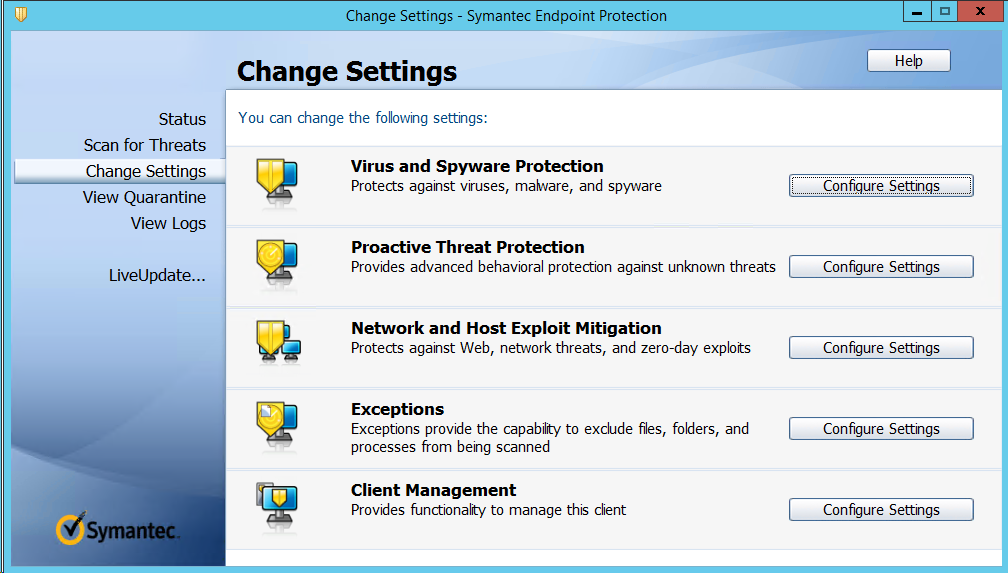

  1. On the System Tray double-click the Symantec Endpoint Protection.
    symantec_v12_1
  2. In the left pane click the Change Settings tab.
  3. From the Virus and Spyware Protection section, click the Configure Settings button.
    symantec_v14_3
  4. Click the Auto-Protect tab and clear the Scan files on remote computers check box.

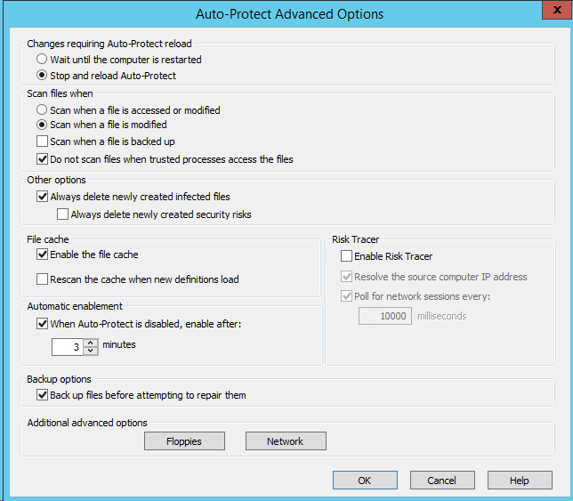

  5. Click Advanced.
    symantec_v14_4
  6. Under the Scan Files when section, click the Scan When a file is modified and clear the Scan when a file is backed up check box.
  7. Click OK.
    symantec_v14_5

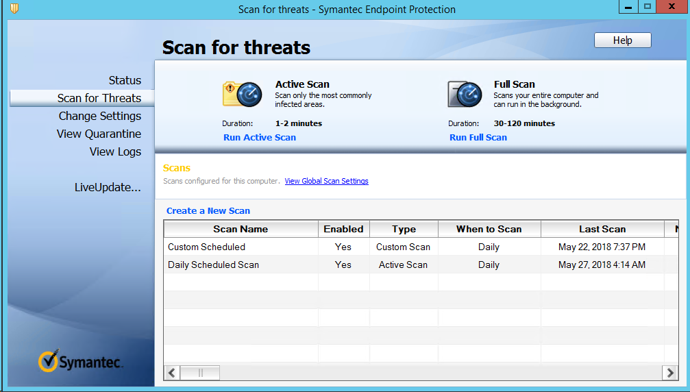

  8. On the Symantec Endpoint Protection console click the Scan for threats tab.
    For any Symantec Endpoint Protection Management Console (SEP MC) controlled or policy scheduled scans ensure that the "Run Active Scan" and the "Run Full Scan" profiles are configured prior to deploying the SEP Client.
    This can be done through the SEP MC by setting up a Group Policy configuration that is enforced for the two choices.
    Otherwise make sure to de-activate the two choices on the SEP Client server.
symantec_v14_2

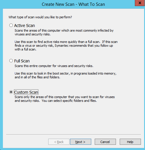

Creating Custom Scheduled Scans
Each scan type must have a profile created that follows the same settings. Make sure these profiles are the only ones used for Client side scheduled scans or for manual scans.
Follow the steps given below to create profiles for each type of scan:
  1. On the Symantec Endpoint Protection console click the Scan for threats tab and click Create a New Scan.
symantec_v14_2

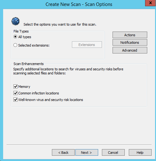

  1. Click Next.
    symantec07_v14
  2. Click the Advanced button.
    symantec_v14_7
  3. From the Storage Migration options list select Skip offline files.
    • Click the Open files using backup semantics checkbox.
    • Click OK.
    symantec_v14_8

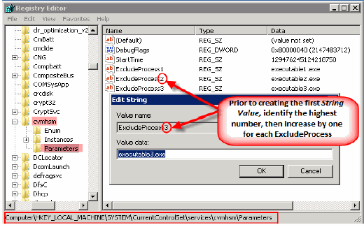

Configuring Windows Registry
Once the SEP Client is configured and before any scans are run please add the following changes to the Commvault Software registry section on the SEP Client server.
  1. Start the Registry Editor on the computer where the file archiver agent is installed.
  2. Navigate to HKEY_LOCAL_MACHINE\SYSTEM\CurrentControlSet\services\cvmhsm\Parameters\.
  3. Right-click Parameters, point at New and click String Value.
  4. In the Value Name box type ExcludeProcessX.
    Where X is the next consecutive number in the list (i.e. ExcludeProcess1, ExcludeProcess2, etc.)) for any process that should not initiate recalls.
    All ExcludeProcess names must be truncated to a maximum 15 character string value or the Windows OS Kernel Mode will not process the exclusion properly. This would result in the exclusion being ignored, unexpected recalls occurring and other unexplained stub activities.
    For example:
    Processnamelong (Truncated from Processnamelongerthen15characters.exe to meet 15 character limit)
    Ensure that in addition to registry keys with environment specific executables, ExcludeProcess registries are also created with the following as their respective value:
    RtvScan.exe
    ccApp.exe
    ccSvcHst.exe
    Smc.exe
    Snac64.exe
  5. Restart the Commvault services for the registry to take its effect.
  6. In a cluster setup repeat all the above mentioned steps on all the physical machines.
