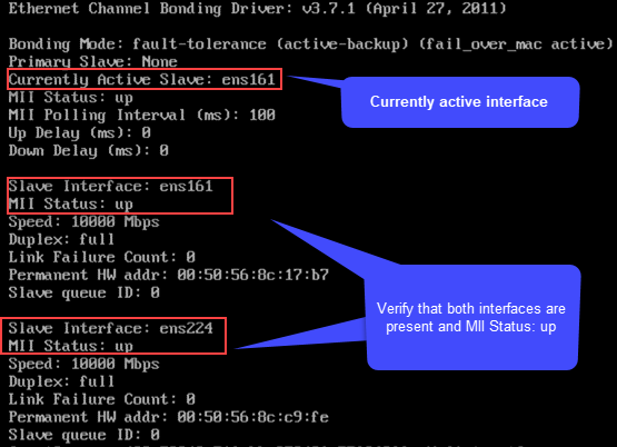

  1. Run the following command:
    cat /proc/net/bonding/<bond interface>
    For example:
    cat /proc/net/bonding/bond1
    You should see an output similar to the one shown in the following image:
    Verifying Active-Backup Bonding Configuration (1)
