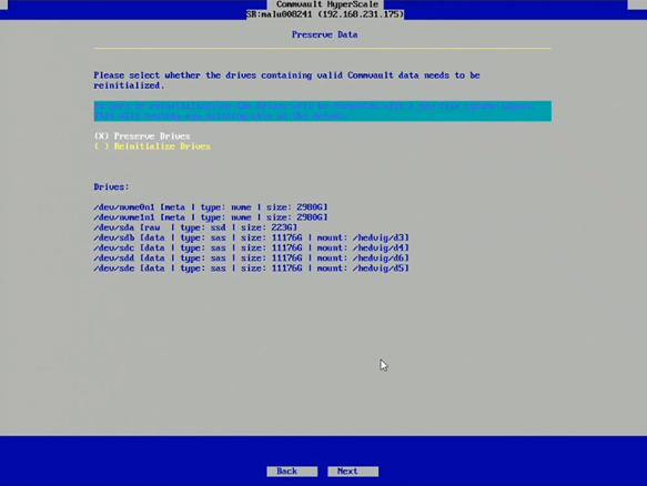

  7. The Preserve Data screen is displayed.
    Recovering an HyperScale X Appliance Node (2)
    Choose the Preserve Drives option and then click Next.
    The installation process will be started. This process will take some time to complete.

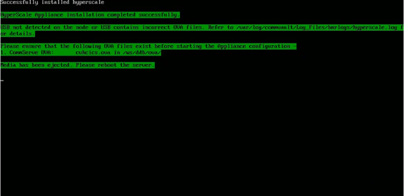

    The following message will be displayed once the installation is complete.
    Recovering an HyperScale X Appliance Node (3)
