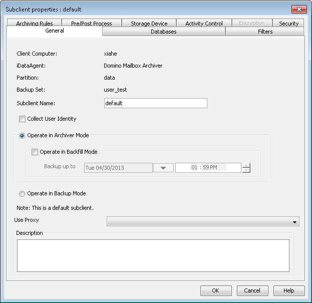

Archiver Mode
This mode is selected by default for all subclients. Domino Mailbox Archiver Agent will perform archive operations based on the rules established in the Archive Rules tab of the Subclient Properties dialog box.
  1. From the CommCell Browser, navigate to Client Computers | <Client> | Archive Set.
  2. Right-click the Subclient, and then click Properties.
  3. Select the Operate in Archiver Mode tab.
  4. Click OK.

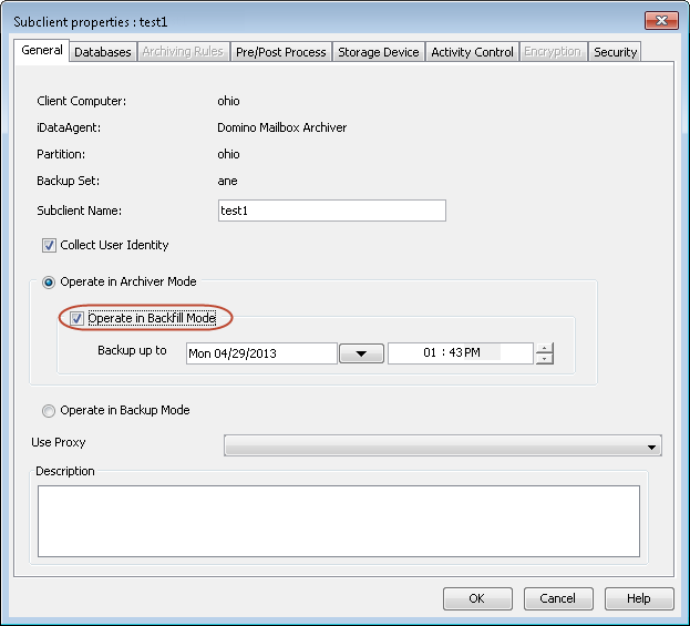

Backfill Mode
This mode further refines the Archiver Mode option and is designed for compliance archiving operations only.
When selected, this mode allows you to back up and populate the content index with messages that were sent and/or delivered before the point-in-time at which archives of the journaling mailbox begin. This is useful if you are newly using the Domino Mailbox Archiver Agent for compliance archiving and want to ensure all messages that predate the defining of the journal mailbox are archived along with the journal mailbox content. The Archive Rules tab of the Subclient Properties dialog box is disabled and the archive operation runs as a full backup with no stubbing phase.
You cannot discover a journal mailbox. To protect the emails in the database, on the Database tab, go to Content, and then click Add Mailbox to enter the journal mailbox name.
Follow these steps to select the Backfill mode:
  3. Select the Operate in Backfill Mode tab.
  4. Click OK.
    backfill_mode
Once the initial archive has occurred using this mode and you are ready to begin using the journaling mailbox for further archive operations, you must perform the following steps:
  1. Define the journal mailbox as the content for the subclient. Note that the journaling mailbox should be configured as Unmanaged and Non-filtered in the Domino.
  2. Unselect this mode in the General tab of the Subclient Properties dialog box.
  3. Select the Do Not Create Stub option in the Archive Rules | Stub Rule tab of the Subclient Properties dialog box.
This mode only needs to be used once, as all subsequent archives will be conducted through the journaling mailbox. Using this mode more than once for the same subclient may return unexpected results (such as duplicate data) during data recovery operations.

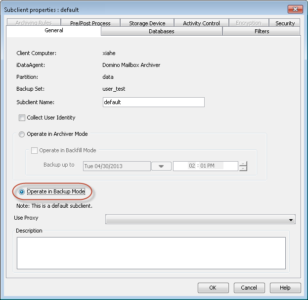

Backup Mode
This mode is designed for content indexing purposes only. It allows full, incremental, differential, or synthetic full backups of mailbox databases using the Domino Mailbox Archiver Agent. The Archive Rules tab of the Subclient Properties dialog box is disabled, archive operations run with no stubbing phase, and all mailbox data (with the exception of design documents) is backed up in a similar fashion to the Notes Document iDataAgent.
For Backup Mode, follow the steps:
  3. Select the Operate in Backup Mode tab.
  4. Click OK.
    backup_mode
Data backed up using Backup Mode will be retained according to the Archiver Days Retention criteria. Regular Days/Cycles Retention criteria will not be honored.

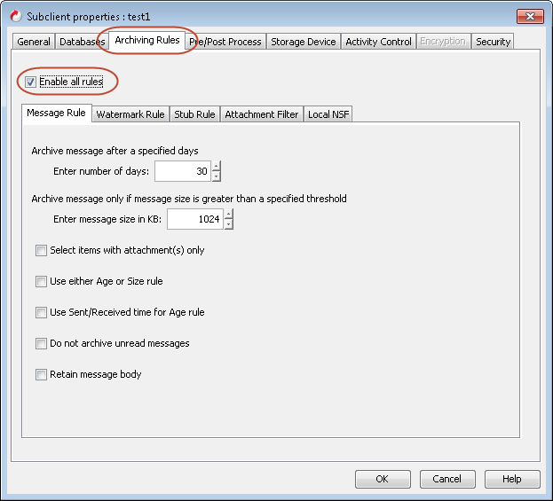

Archiving rules specify the criteria for the type of data to be archived. Messages that meet this criteria are rendered available for archiving if they satisfy any or all the archiving rules.
Based on Message Properties
You can set rules to archive messages based on the messages properties. All the messages matching with this criteria will be archived.
  3. Select the Archiving Rules tab.
  4. Select the Enable all rules check box.
  5. In the Archive message after specified days box, type or select the number of days old that a message must be in order for the message to be archived.
  6. In the Archive message only if size is greater than box, type or select the size a message must be of in order for the message to be archived
  7. You can select one or more from the following options:
    • Select the Select items with attachment only check box to archive the messages that have attachments.
    • Select Use either Age or Size rule check box check box to archive if either the Age or Size of the message/item matches the respective rule.
    • Select the Use Sent/Received time for Age rule check box.
    • Select the Do not archive unread messages check box.
    • Select the Retain Message Body check box if you do not want the body of the message to be removed during the stubbing process.
  8. Click OK.

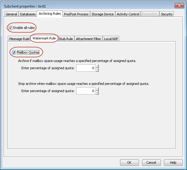

Based on Mailbox Space Quota
You can set rules to archive based on a specified amount of used disk space on the database which hosts this mailbox. You can also establish a mailbox quota rule, which will archive messages when the mailbox has exceeded the specified threshold.
  5. Click the Watermark Rule tab.
  6. Select the Mailbox Quotas check box.
    • In the Archive if size of mailbox reaches box, type or select the mailbox size high watermark value.
    • In the Stop archive when mailbox reaches box, type or select the mailbox size low watermark value.
    mail_quota

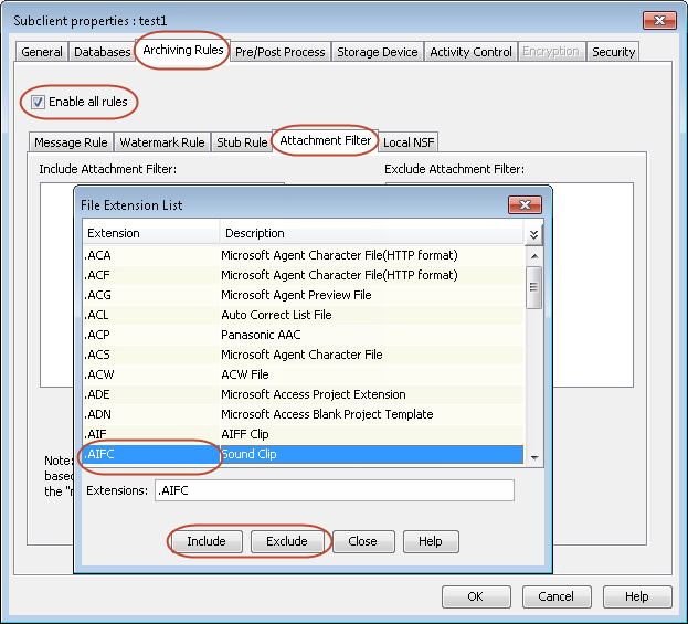

Based on Attachments
  5. Select the Attachment Filter tab.
  6. Click Include or Exclude to include or exclude file extensions on the list.
  7. Click Close.
  8. Click OK.

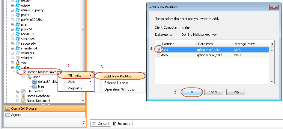

Configuring Domino Partition
On Windows
For Windows, available partitions will be automatically shown. To add partitions, follow these steps:
  1. From the CommCell Browser, navigate to Client Computers | <Client> |Domino Mailbox Archiver.
  2. Right-click the Domino Mailbox Archiver, and then click All Tasks | Add New Partition.
The Add New Partition dialog box appears.
  1. Under the Partition column, select the partition to add and click OK.
  2. Click OK.
    partition - configurationklzzwxh:0449omino_mailboxklzzwxh:0450artition.png

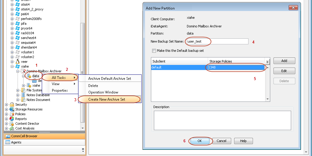

Configuring User Defined Archive Set
User defined archive sets allows for content to be specified as an external input at the time of initiating an archiving operation. To configure a user define archive set, follow the steps below:
  1. From the CommCell Browser, navigate to Client Computers | <Client> | Partition.
  2. Right-click the Partition, and then click All Tasks | Add New Archive Set.
  3. Type a name in the New Backup Set Name box.
  4. Under the Storage Policies column, select a storage policy.
  5. Click OK.

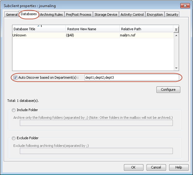

Configuring Department-Based Auto Discovery
Configuring department-based auto discovery associates a subclient to all the mailboxes that belong to a particular department. This association saves time and effort by automatically assigning new mailboxes to a subclient based on department names.
To configure department-based auto discovery, first configure the Notes Domino Directory by changing the person document to reflect the assigned departments. Then, configure the Commvault software by associating the required departments to the subclient.
  1. Configure the Notes Domino Directory:
    1. From the Domino Administrator, select the server that stores the Domino Directory to modify.
    2. Edit the person document to assign a department to the user.
      1. From the People and Groups tab, select People from the left navigation pane.
      2. Double-click the Person document for the user you want to modify.
      3. On the Work tab, click Department.
  2. Configure the Commvault CommCell:
    1. From the CommCell Browser, expand Client Computers | Client | Archive Set.
    3. On the Databases tab, select the Auto Discover based on Department(s) check box.
    4. Provide department names.
      In case of multiple department names, separate the departments with semicolon (;).
    5. Click OK.
  3. Run an archive backup job.
    All user mailboxes with the specified department names are assigned to the subclient.
    department_based
For the default subclient, filters take precedence over department. For example, if a mailbox matches the department name and it is part of filters, that mailbox will not be added to the subclient.
Department names are case sensitive.

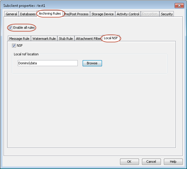

Activating NSF File Archiving on a User-Defined Subclient
To specify the archiving of NSF files and enable this subclient of the Domino Mailbox Archiver Agent, first create the local NSF folders and database and then associate them to the local NSF location.
Creating the NSF Folders and Database
Click to browse for the root folder where all the NSF directories are located, then:
  1. Create a new folder, e.g., “localnsf” under the domino data path.
  2. Create a subfolder of "localnsf" named exactly the same as the user name.
  3. Create a new database in the subfolder created in step 2.
    We recommended you to use the same database template, preferably the mail template, for all the NSF files.
Associate Folders to the Local NSF location
Follow the steps below to activate archiving for .nsf files on a subclient.
  1. In the CommCell Browser, expand Client Computers | <Client Name> | Domino Mailbox Archiver | <Partition Name> | <Archive Set Name>.
  2. In the Archive Set tab, right-click the name of a user-defined subclient, and then click Properties.
  3. In the Subclient Properties dialog box, click the Archiving Rules tab, and then click the Local NSF sub-tab.
  4. Select NSF.
  5. In the Browse box, enter the location of the folder that contains all of the user mailbox folders where NSF directories reside.
    You must specify full path of the folder that contains all user mailbox folders so that all NSF directories are included in the archiving process.
Note: Local NSF files cannot be archived when using a proxy client.
nsf

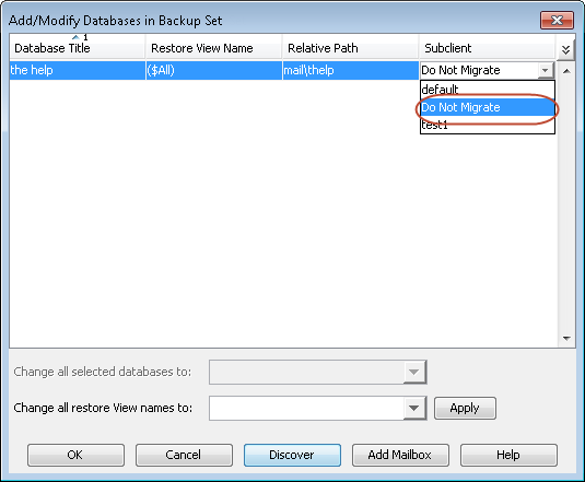

Excluding Specific Mailboxes from Archiving
By default, the system creates a Do Not Archive subclient. You can assign mailboxes to this subclient so that they will not be archived.
  3. Click the Databases tab.
  4. Click Configure.
  5. Click Discover to reveal all mailboxes.
  6. Under the Subclient column, select Do Not Migrate.
    Alternatively, you can click the desired mailbox, and select Do Not Migrate from the Change all selected mailboxes to box.
  7. Click OK.
  8. Click OK.
    do_not_migrate

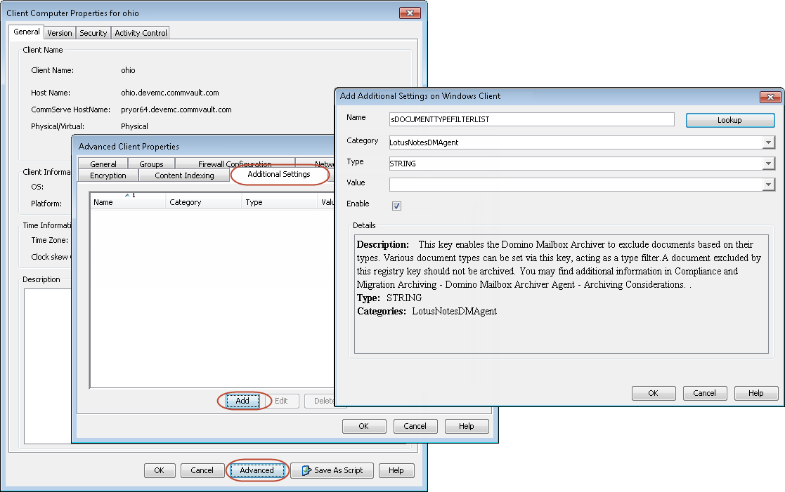

Excluding Specific Documents from Archiving
To exclude documents based on their type (e.g. memo, appointment, task). Once a document is excluded by this key, it should not be archived.
  2. Right-click <Client> and then click Properties.
  3. Click Advanced.
  4. Select Additional Settings tab.
  5. Click Add.
  6. In the Name box, type sDOCUMENTTYPEFILTERLIST. The Category and Type details will be automatically populated.
  7. In the Value box, type the list for exclusion such as Memo, Appointment, Task, and so on. Use semicolon to type multiple values.
  8. Click OK.
    exclusion_types

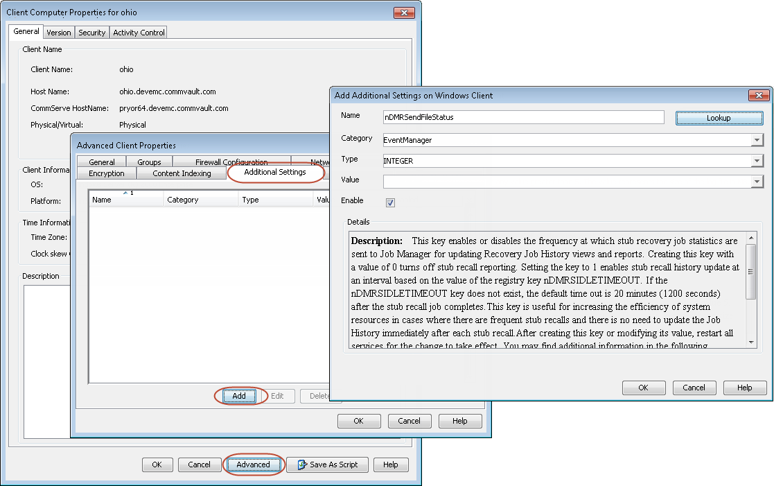

Configuring Recovery of Multiple Files from Stubs
Stub recall history can be turned on with following the steps:
  3. Click Advanced.
  5. Click Add.
  6. In the Name box, type nDMRSendFileStatus. The Category and Type details will be automatically populated.
  7. In the Value box, type 1.
  8. Click OK.
    multiple_files_stubs

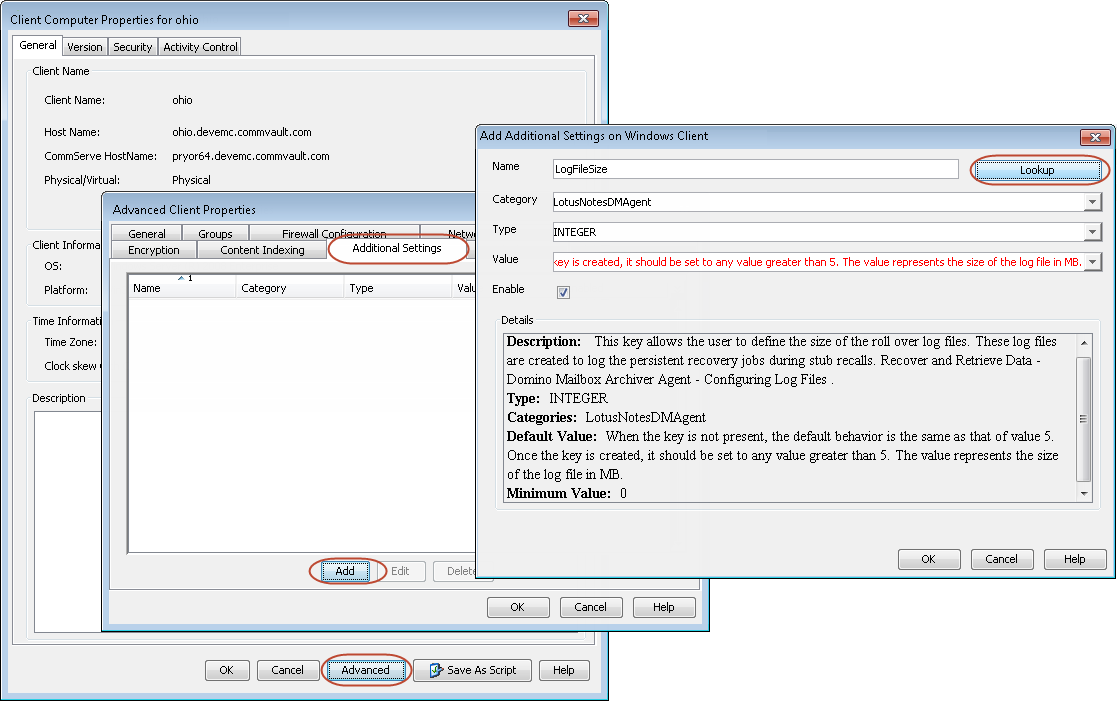

Configuring Log Files
During persistent recovery job log files are created. These log files contain details of all the stubs that were recovered and can be viewed at any point of time. By default 5 log files are created of 5 MB each. Every time a log file reaches 5 MB worth of data a new file is created. The newly created log file will have "_n" appended to the original file name with cvlnDMHook.log_1 being the latest rolled log file. In order to increase the size of each log file and also the number of log files that can be created follow the steps given below:
Windows
  3. Click Advanced.
  5. Click Add.
  6. In the Name box, type LogFileSize. The Category and Type details will be automatically populated.
  7. In the Value box, type a value greater than 5.
  8. Click OK.
  9. Click Add.
  10. In the Name box, type NumLogFiles. The Category and Type details will be automatically populated.
  11. In the Value box, type a value greater than 5.
  12. Click OK.
  13. Click OK.
    log_files

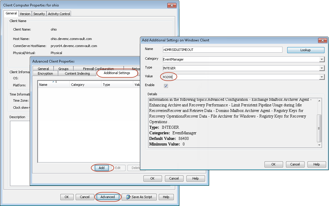

Configuring Persistent Pipeline
To change the default value of how long the persistent pipeline will stay open during idle periods of a recovery operation, use the following steps:
  3. Click Advanced.
  5. Click Add.
  6. In the Name box, type nDMRSIDLETIMEOUT. The Category and Type details will be automatically populated.
  7. In the Value box, type a value such as 43200.
  8. Click OK.
    persistent_pipeline
The pipeline stays persistent for 24 hours (86400 seconds) by default.
To ensure the additional setting settings take effect, it is recommended that you restart the CommVault Client Manager Service (ClMgrS).

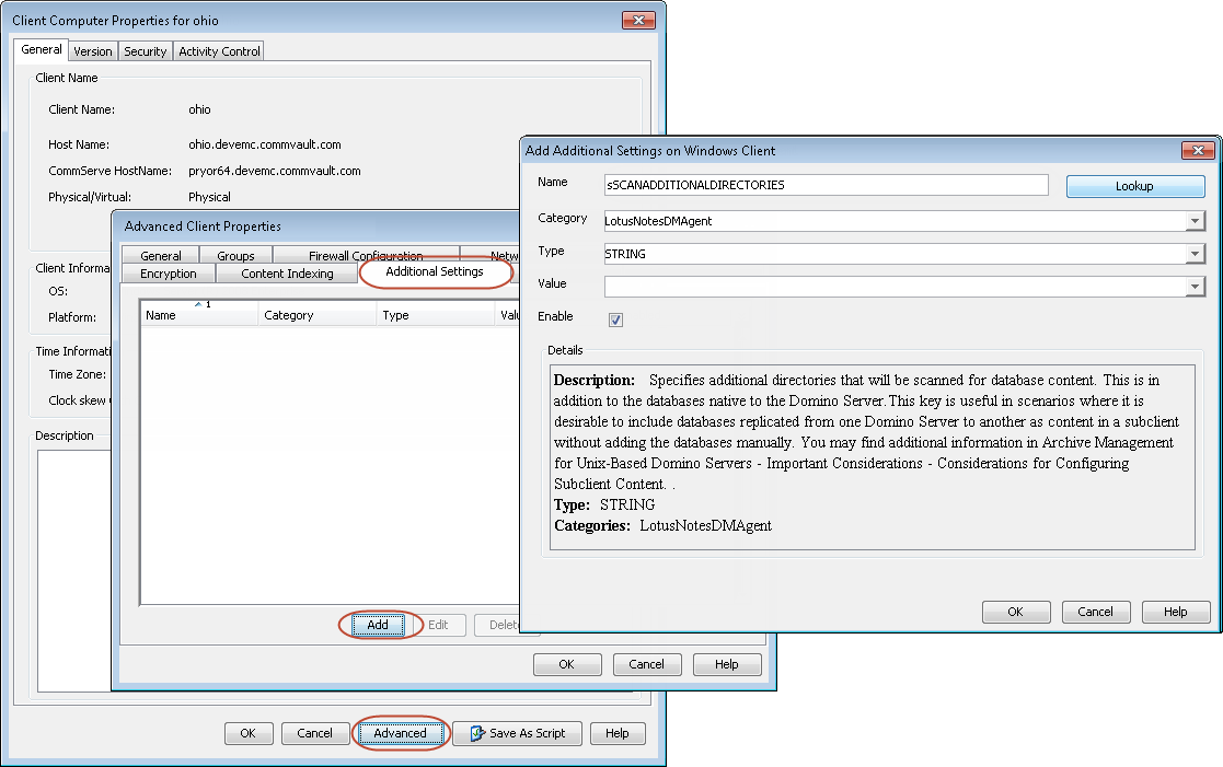

Configuring Discovery of Replicated Database
By default, the Domino Mailbox Archiver Agent only discovers databases native to the Domino from which discovery takes place. Any replicated databases will thus need to be added manually to the subclient. Follow the steps:
  3. Click Advanced.
  5. Click Add.
  6. In the Name box, type sSCANADDITIONALDIRECTORIES. The Category and Type details will be automatically populated.
  7. In the Value box, type the name of the directories relative to Domino data directory. For example, Folder1.
  8. Click OK.
    discovery_replicated
Domino Mailbox Archiver Agent will scan any directories specified in the additional setting and automatically assign any databases contained within those directories to the subclient.

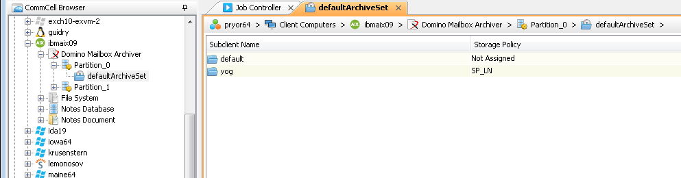

Modifying an Agent, an Archive Set, or a Subclient
The following table describes the properties that can be configured from the agent, Archive Set and subclient levels.
Option
Related Topics
Rename Archive Set and Subclient
You can rename an Archive Set and subclient:
Renaming Archive Sets:
  1. From the CommCell Browser, navigate to Client Computer| <Client> | Domino Mailbox Archiver.
  2. Right-click the Archive Set, and then click Properties.
  3. In the Archive Set box, type the Backup Set name.
  4. Click OK.
    Renaming subclients:
  5. From the CommCell Browser, navigate to Client Computer| <Client> | Domino Mailbox Archiver.
  6. Right-click the Subclient, and then click Properties.
  7. In the Subclient name box, type the subclient name.
  8. Click OK.
