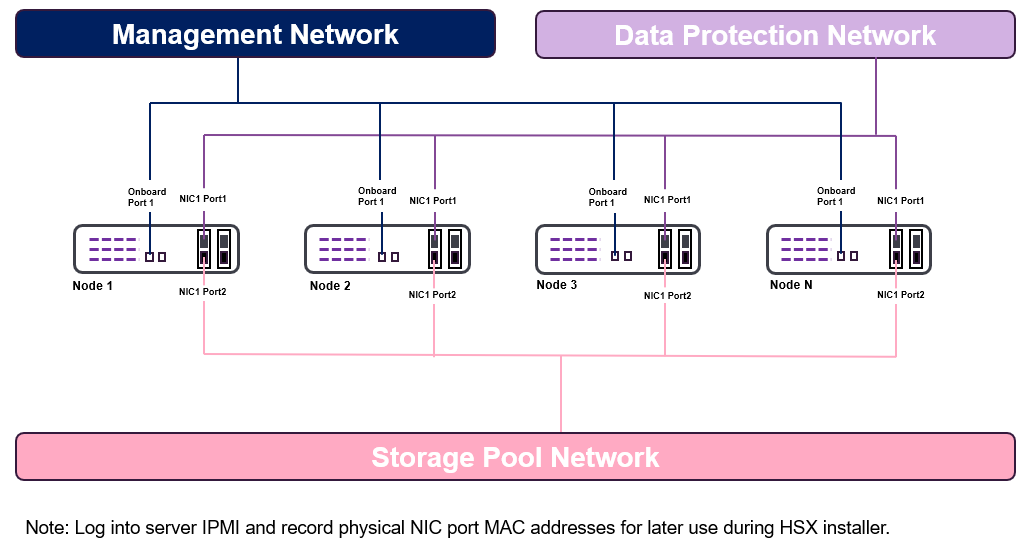

Basic Topology With 1 GbE Management Network
This topology combines the basic topology with a 1 GbE management interface.
This can be used in cases where the data protection network will be on a non-routable backup network, and therefore an additional management interface is required. This topology leverages one of the built-in 1 GbE copper interfaces for management traffic and will require additional cabling.
In this topology, each node requires connections to 3 separate network as follows:
  • 1 - 10 GbE port for data protection network, which transfers data to and from the clients being protected and connect to the CommServe server.
  • 1 - 10 GbE port for storage pool network, which is a dedicated private network, used for communication and replication between the HyperScale X nodes.
  • 1 - 1 GbE port for management network, which is used exclusively for all management related communication, such as connecting to the CommServe server, accessing the DNS server, etc.
Basic topology is the easiest option to setup and deploy. However, this topology does not provide network redundancy, and is recommended only for non-production use, or if you do not have the required port availability for redundant connections. Combine the basic topology with a Management network if the HyperScale X nodes are located in an isolated backup network.
embd_1GbE_topology_desc (1)

  • 1 - 10 GbE port for the data protection network,which transfers data to and from the clients. This requires a corresponding IP address for the data protection network.
  • 1 - 10 GbE port for the storage pool which is a dedicated private network, used for communication and replication between the HyperScale X nodes. This requires a corresponding IP address for the storage pool network.
  • 1 – 1 GbE port for the management network, which is connected to a routable network with DNS access. This requires a corresponding IP address for the management network.
Data Protection, storage pool and management networks MUST be on separate subnets.
