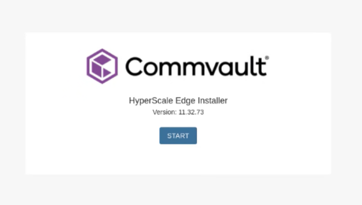

    The HyperScale Edge Installer page appears.
    robo_install_start
  3. Click Start.

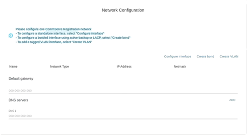

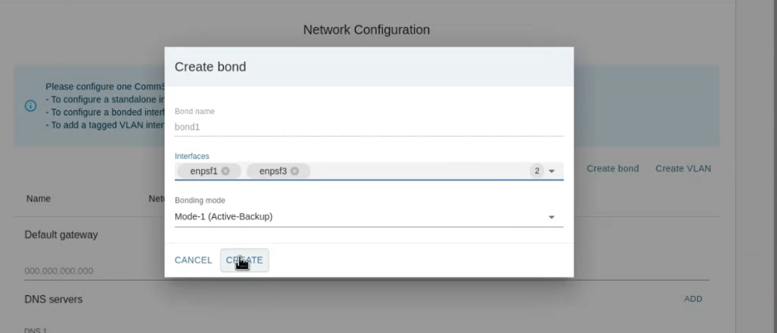

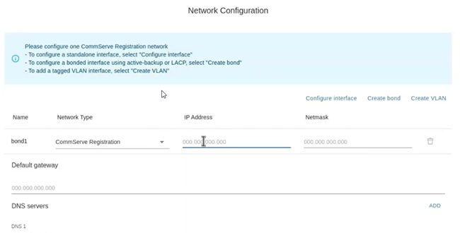

  4. Create a data protection interface bond as follows:
    1. Click Create bond.
    2. From the Interfaces list, select the data protection interfaces. (enpsf3 or enpsf5)
    3. From Bonding mode list, select either active-backup (Mode 1) or LACP (Mode 4).
    4. Click CREATE. robo_linux_bond_install_bond2
    5. From the Network Type list, select CommServe Registration
    6. Add the IP Address and Netmask in the respective boxes.
      robo_linux_bond_install_bond3

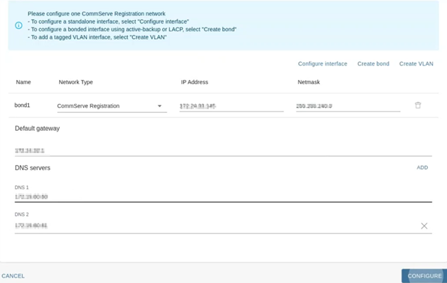

  5. Configure the DNS server(s) as follows:
      robo_linux_bond_install_bond4
    3. Click CONFIGURE.
      robo_linux_bond_install_bond5
  6. Verify the network configuration and then click CONTINUE.

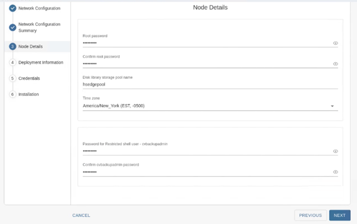

    The Node Details dialog box appears.
    robo_linux_install5
  7. Add the following information:
    5. Click NEXT.

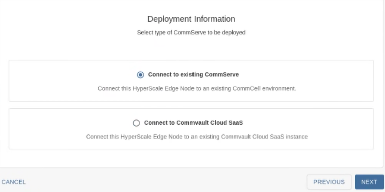

  8. Click Connect to existing CommServe, and then click NEXT.

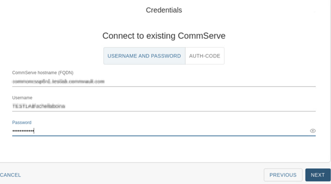

    The Credentials page appears.
    robo_linux_install7
  9. Choose one of the following options to connect to the CommServe:
      When you install using an authorization code, the installation process does not create the storage pool automatically. You must manually create the storage pool from the Command Center after the installation. For more information, see Creating a Disk Storage Pool.

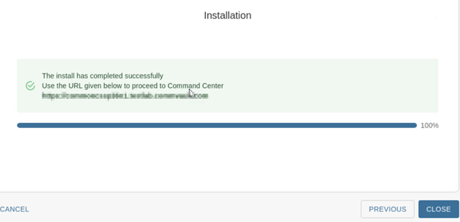

  10. Click CLOSE.
