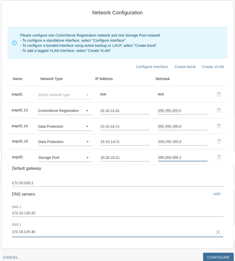

  5. Configure additional data protection VLAN interfaces as follows:
    (Repeat this step to add all the VLANs available in your environment.)
    1. Click Create VLAN.
      The Create VLAN dialog box appears.
      Tagged VLAN (8)
    3. In the VLAN ID box, enter the VLAN ID associated with the VLAN network and then click CREATE.
      The interface appears with the VLAN ID in the Network Configuration page.
    4. From the Network Type list, select Data Protection.
      Repeat this step to configure ALL the VLANs available in your environment.
      Once completed your screen should be similar to the one shown in the following image: (The VLAN IDs and the number of VLANs will be different, depending on the VLAN configuration in your environment.)
    embd_TaggedVLAN1 (7)
      Tagged VLAN (9)
    3. Click CONFIGURE.
  7. Verify the network configuration and then click CONTINUE.
