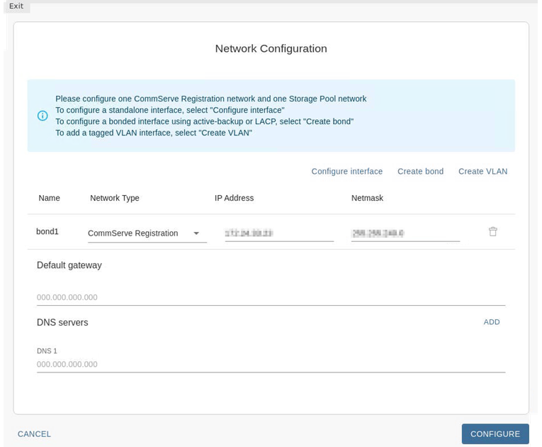

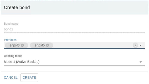

Create a data protection interface bond as follows:
Click Create bond.
From the Interfaces list, select the data protection interfaces. (enpsf3 or enpsf5)
From Bonding mode list, select either active-backup (Mode 1) or LACP (Mode 4).
Click CREATE.
From the Network Type list, select CommServe Registration
Add the IP Address and Netmask in the respective boxes.

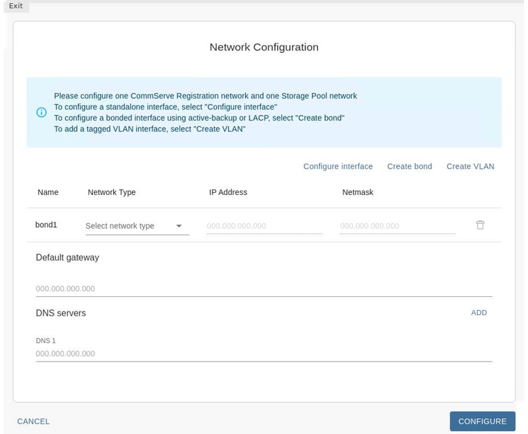

Configure the storage pool interface (bonded) as follows:

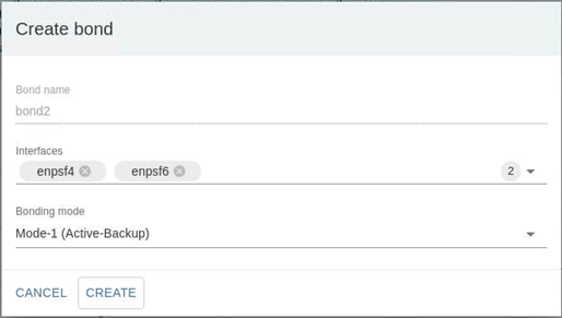

Click Create bond.
From the Interfaces list, select the 2 interfaces that will form the storage pool bond. (For example, enpsf4 and enpsf6 .)
Click CREATE.

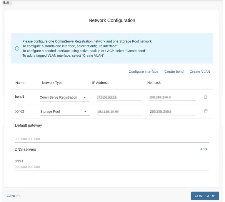

From the Network Type list, select Storage Pool. This interface will be used exclusively for communication and replication between the HyperScale nodes.

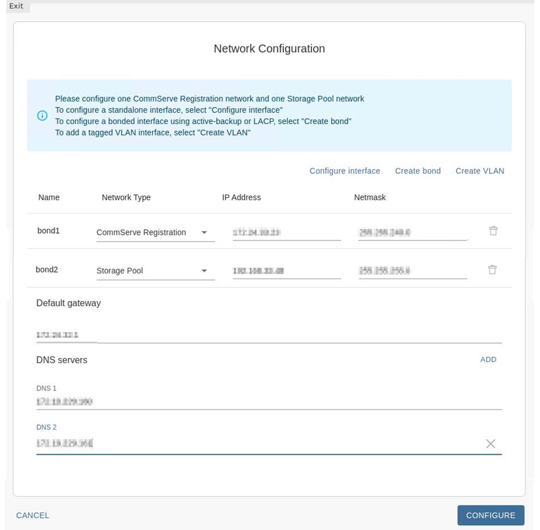

Configure the DNS server(s) as follows:
In the Default Gateway box, add the IP address associated with the default gateway.
In the DNS Servers box, add the IP address associated with the DNS Server.
Click CONFIGURE.

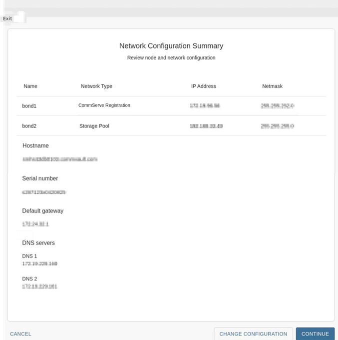

Verify the network configuration and then click CONTINUE. Verify the following information.
IP address and netmask for the data protection interface is accurate.
IP address and netmask for the storage pool interface is accurate.
Hostname and serial number associated with the node is accurate.
Default gateway and DNS servers are accurately configured.
