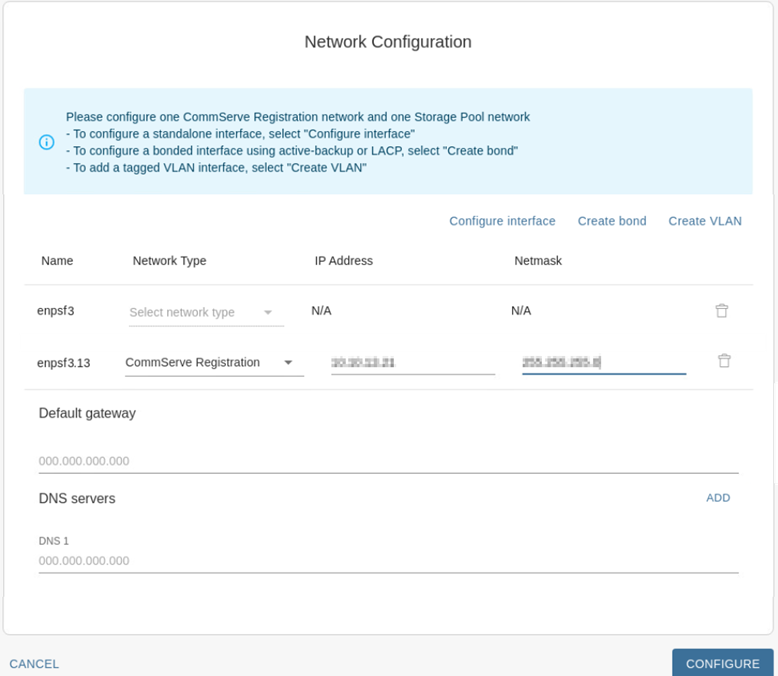

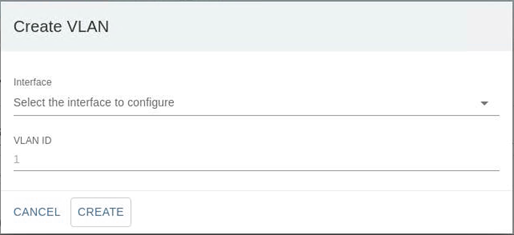

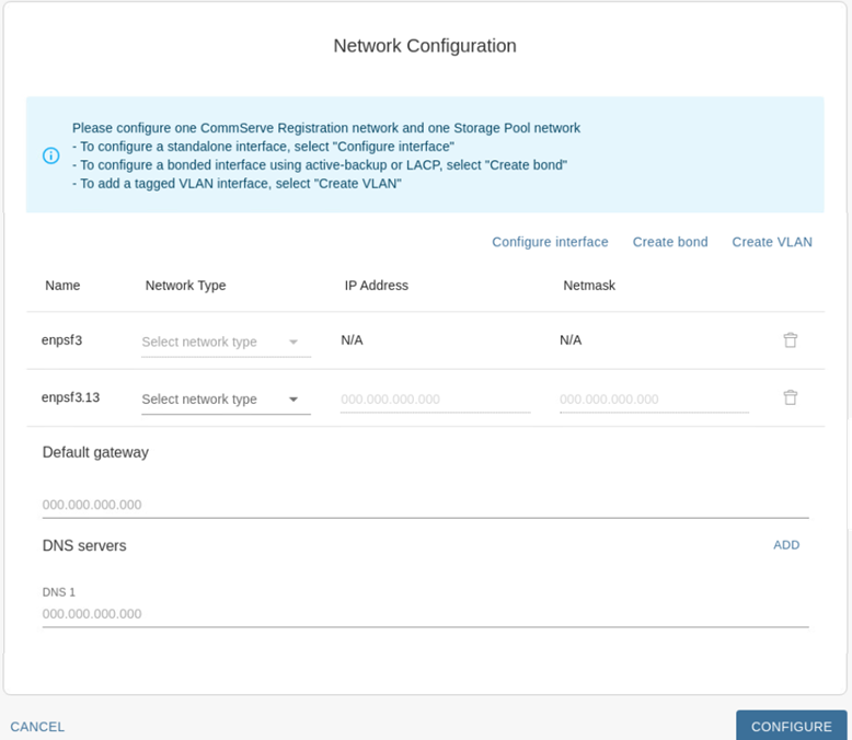

  3. Configure the routable data protection VLAN interface as follows:
    1. Click Create VLAN.
      The Create VLAN dialog box appears.
      Tagged VLAN (8)
    3. In the VLAN ID box, enter the VLAN ID associated with the routable VLAN network and then click CREATE.
      The interface appears with the VLAN ID in the Network Configuration page. (The VLAN ID will be different, depending on the VLAN ID in your environment.)
      embd_TaggedVLAN1 (5)
      embd_TaggedVLAN1 (6)

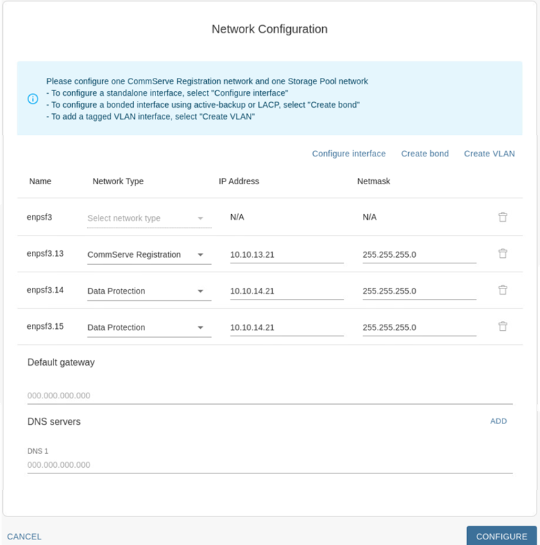

  4. Configure additional data protection VLAN interfaces as follows:
    (Repeat this step to add all the VLANs available in your environment.)
      Tagged VLAN (8)
    3. In the VLAN ID box, enter the VLAN ID associated with the VLAN network and then click CREATE.
    4. From the Network Type list, select Data Protection.
    6. Repeat this step to configure ALL the VLANs available in your environment.
      Once completed your screen should be similar to the one shown in the following image: (The VLAN IDs and the number of VLANs will be different, depending on the VLAN configuration in your environment.)
    embd_TaggedVLAN1 (7)

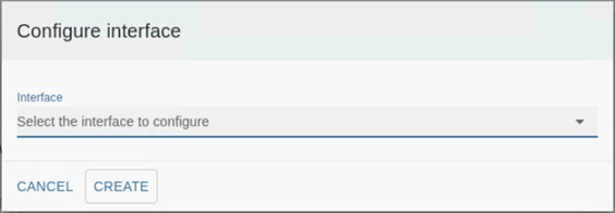

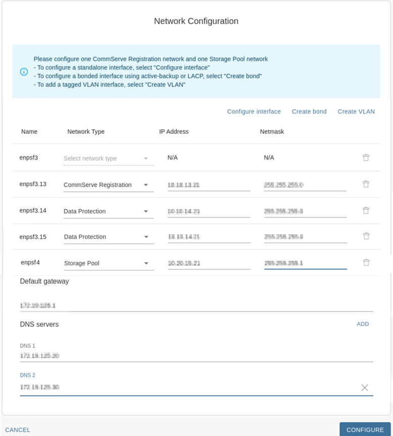

  5. Configure the storage pool interface as follows:
    1. Click Configure interface.
    3. Click CREATE.
    4. From the Network Type list, select Storage Pool. This interface will be used exclusively for communication and replication between the HyperScale nodes.
      embd_TaggedVLAN2 (2)
      Tagged VLAN (10)
  7. Click CONFIGURE.
    Tagged VLAN (15)

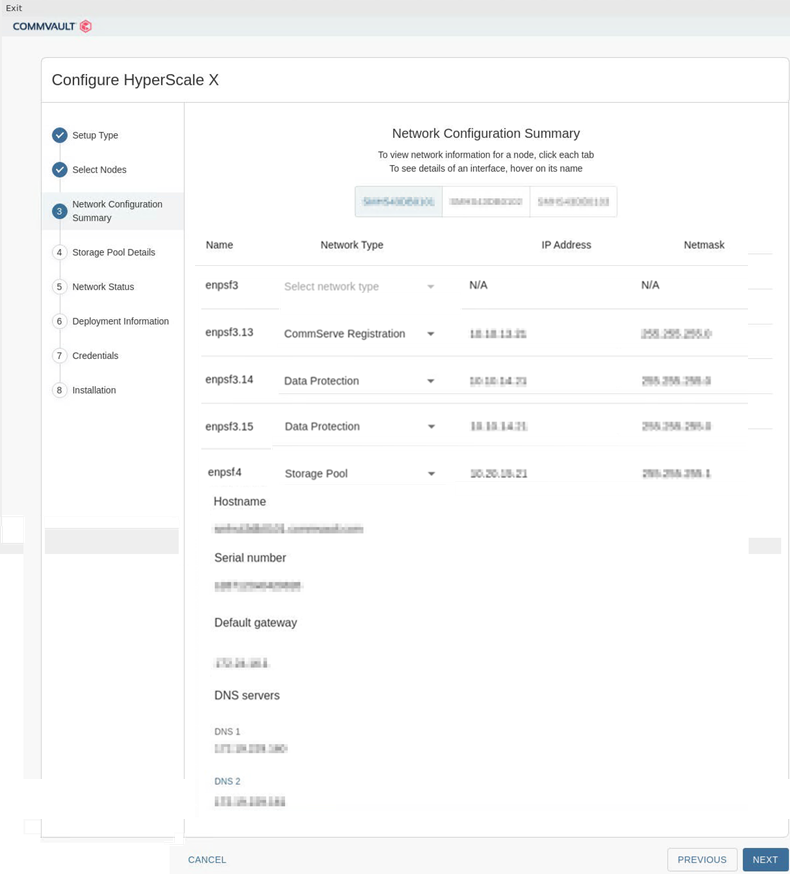

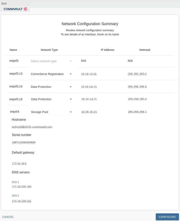

    • All the VLANs are included.
    • IP address and Netmask for the VLANs are accurate.
    • IP address and Netmask for the storage pool is accurate.
    Tagged VLAN (7)
      Repeat the steps (step 1 through 10) from another node.

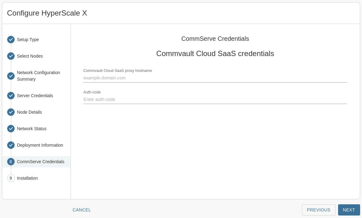

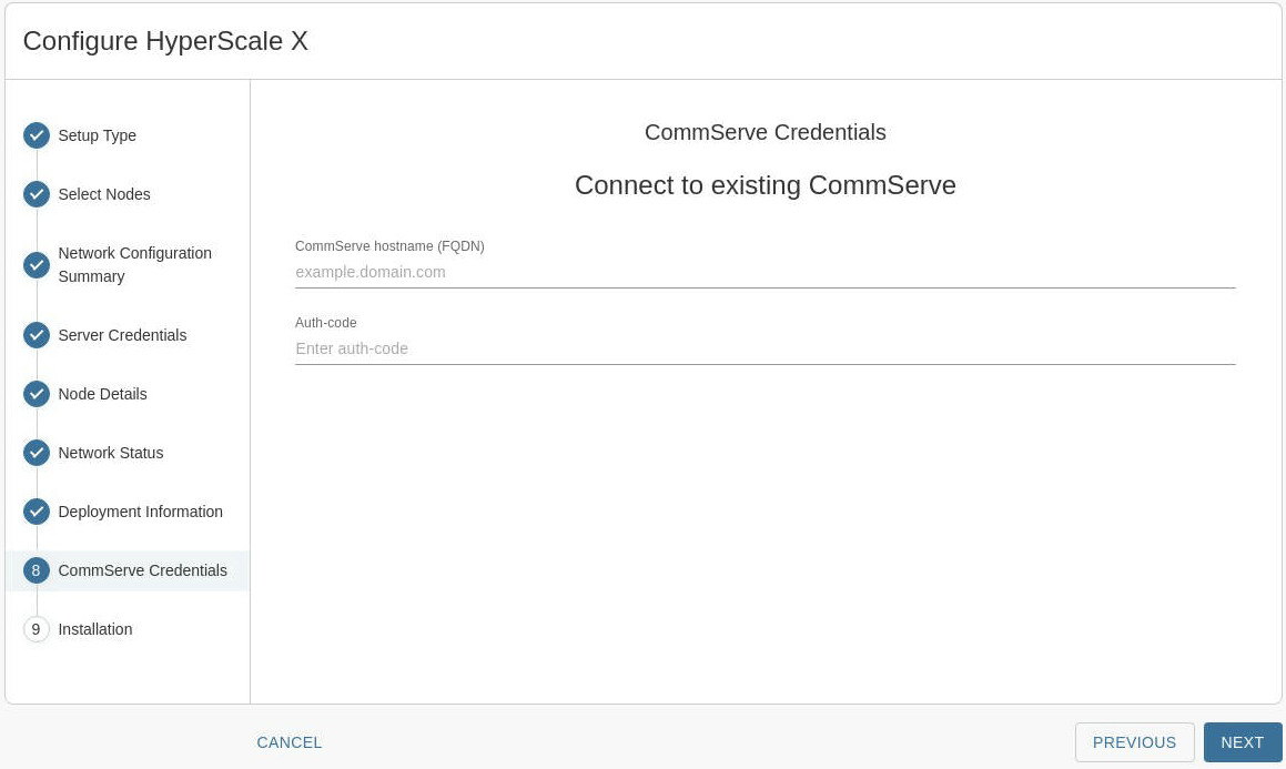

  15. The steps to connect to the CommServe differ based on your environment.
    • In a Software environment, complete the following steps:
      1. Click Connect to existing CommServe, and then click NEXT.
        The CommServe Credentials page appears.
      2. In the CommServe hostname (FQDN) box, enter a fully qualified host name of the existing CommServe server that you are connecting to.
      3. In the Auth-code box, enter the authorization code to connect to the CommServe server.
      4. Click NEXT.
    • In a SaaS environment, complete the following steps:
      1. Click Connect to Commvault Cloud SaaS, and then click NEXT.
      2. In the Commvault Cloud SaaS proxy hostname box, enter the fully qualified host name of the existing backup gateway that you are connecting to.
      4. Click NEXT.
