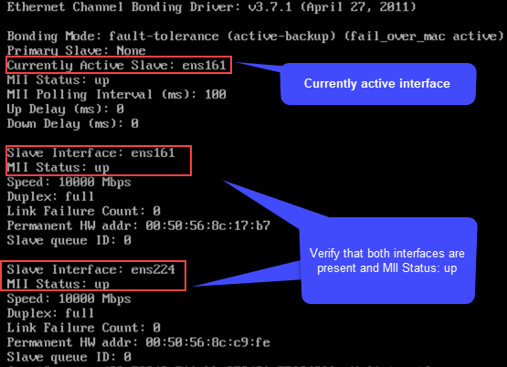

    cat /proc/net/bonding/<bond interface>
    For example:
    cat /proc/net/bonding/bond1
    You should see output similar to the following:
    Verifying Active-Backup Bonding Configuration (1)
  2. Starting with the data protection interface, ping the gateway or another HyperScale node to verify that the currently active interface is working correctly.
