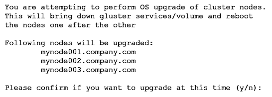

      3. Use the following command to install OS updates on all the cluster nodes:
        ./cvupgradeos.py -no_vm_management
    Installing Operating System Updates (1)
    Important
    Make sure that all the nodes in the cluster are listed.
  7. Type y and press Enter to continue.
