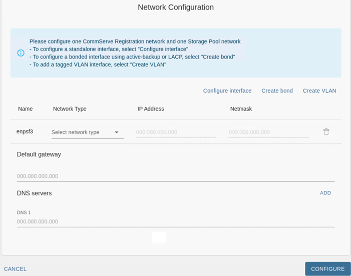

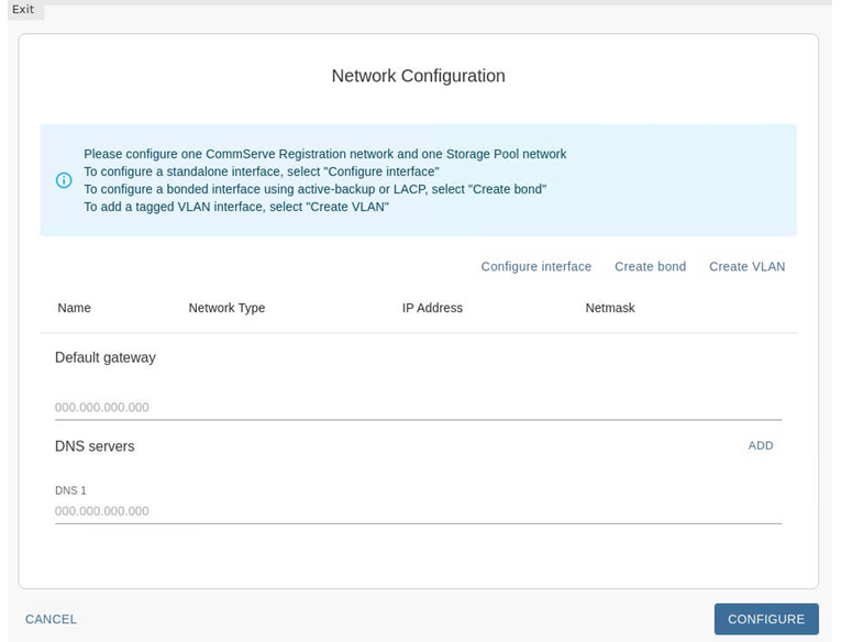

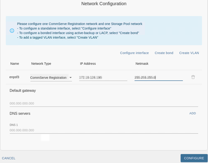

    1. Click Configure interface.
    3. Click CREATE.
    3. Click CREATE.
    4. From the Network Type list, select Storage Pool. This interface will be used exclusively for communication and replication between the HyperScale nodes.
  5. Configure the management interface as follows:

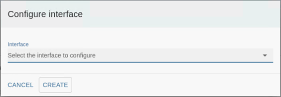

    2. From the Interfaces list, select one of the management interfaces. (For example, enpsf1 or enpsf2.)
    3. Click CREATE.
    4. From the Network Type list, select Management. This interface will be used for all management related communication, such as connecting to the CommServe server, accessing the DNS server, etc.
      Basic Deployment With 1 GbE Managment Network (6)
      Basic Deployment With 1 GbE Managment Network (4)
  7. Click CONFIGURE.
    Basic Deployment With 1 GbE Managment Network (8)

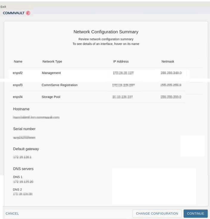

    • IP address and netmask for the management interface is accurate.

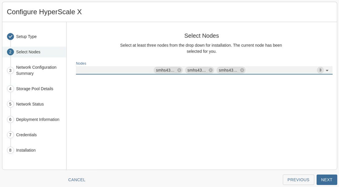

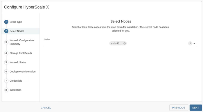

      The Setup Type page appears.
      Tagged vLAN and Bonding (26)
    Tagged vLAN and Bonding (27)
    3. Click NEXT.

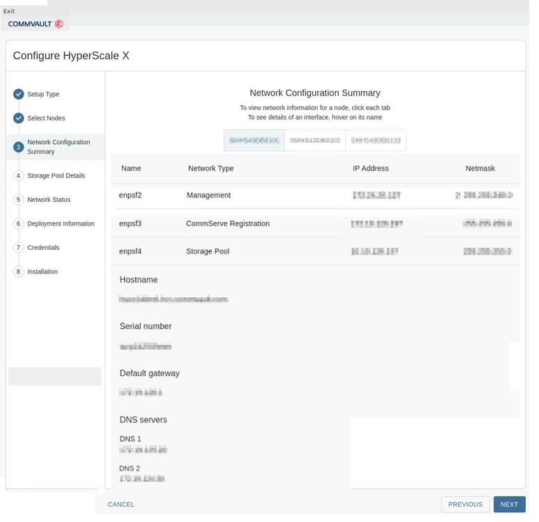

      Basic Deployment With 1 GbE Managment Network (9)

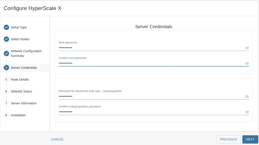

    gridinstall8
    1. Add the following information:
    2. In the Root password and Confirm root password boxes, type a secure password for the nodes.
    3. In the Password for Restricted shell user - cvbackupadmin and Confirm cvbckupadmin password boxes, type a secure password for the cvbackupadmin user.
    4. Click NEXT.

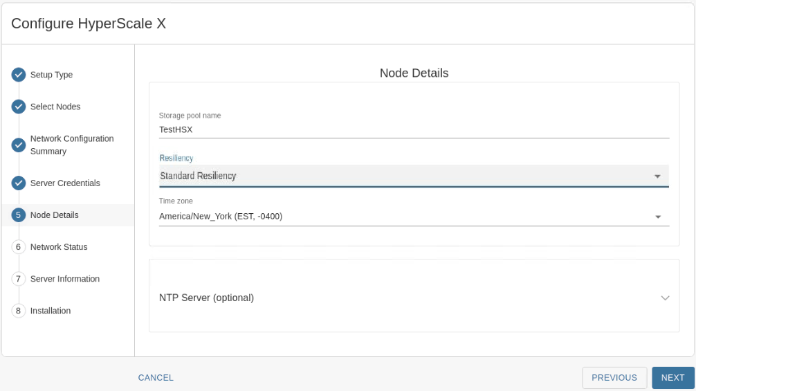

    gridinstall8
    1. In the Storage pool name box, type a name for the storage pool associated with the cluster.
    2. From the Resiliency list, select the resiliency applicable to the storage pool that you are creating.
    4. In the NTP server box, type a name for the storage pool associated with the cluster.
    5. Click NEXT.

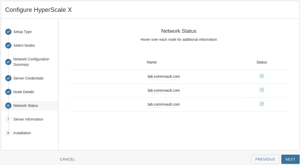

  14. Check the status to ensure that all the nodes have a green status to indicate that the network settings is validated and accurate.
  15. Click NEXT.

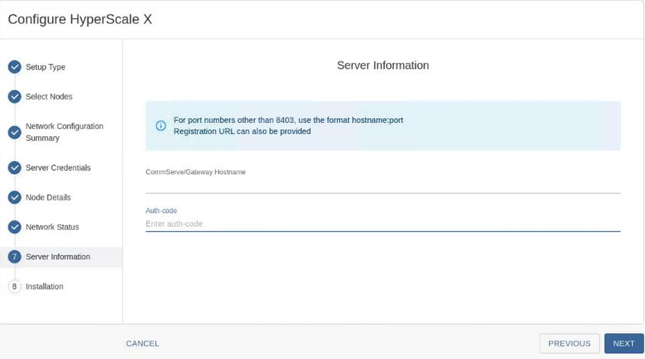

    The Server Information page appears
    gridinstall10
  16. Add the following information:
    1. In the CommServeGateway Hostname box, enter the fully qualified domain name (FQDN) of the CommServe server based on the endpoint type used in your deployment.
      Endpoint Type Example Applicable to SaaS Deployment
      CommServe FQDN Registration test.commvault.com No
      Backup Gateway (default port) test.eastus2.cloudapp.azure.com Yes
      Backup Gateway (non-default port) test.eastus2.cloudapp.azure.com:443 Yes
      Registration URL (Metrics) https://metrics.metallic.io Yes
      Registration URL (CommServe) https://test.commvault.com No
    2. In the Auth-code box, enter the authorization code to connect to the CommServe server.
    3. Click NEXT.

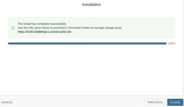

    If the storage pool creation fails during the installation, you can manually create the storage pool from the Command Center. For more information, see Creating a HyperScale Storage Pool.
  17. Click CLOSE.
