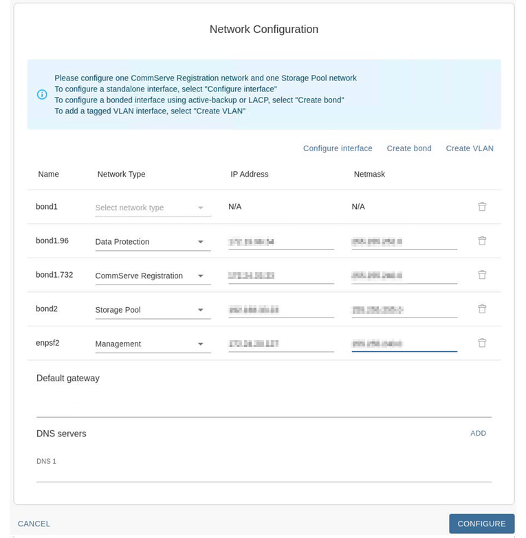

Configure the routable data protection VLAN interface (bonded) as follows:
Click Create bond.
From the Interfaces list, select the 2 interfaces that will form the data protection bond. (For example, enpsf3 and enpsf5)
From Bonding mode list, select either active-backup (Mode 1) or LACP (Mode 4).
Click CREATE.
Click Create VLAN.
The Create VLAN dialog box appears.
From the Interface list, click bond1.
In the VLAN ID box, enter the VLAN ID associated with the routable VLAN network and then click CREATE.
The bond1 interface appears with the VLAN ID in the Network Configuration page. (The VLAN ID will be different, depending on the VLAN ID in your environment.)
From the Network Type list, select CommServe Registration.
Add the IP Address and Netmask in the respective boxes.

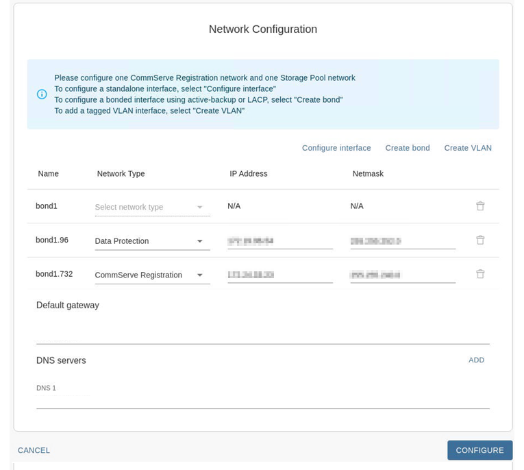

Configure additional data protection VLAN interfaces (bonded) as follows:
(Repeat this step to add all the VLANs available in your environment.)
Click Create VLAN.
In the VLAN ID box, enter the VLAN ID associated with the additional data protection VLAN network.
Click CREATE.
The new bond1 interface appears with the VLAN ID in the Node and Network Configuration page.
From the Network Type list, select Data Protection.
Repeat this step to configure ALL the VLANs available in your environment.
Once completed your screen should be similar to the one shown in the following image: (The number of VLANs may vary depending on the number of VLANs available in your environment.)

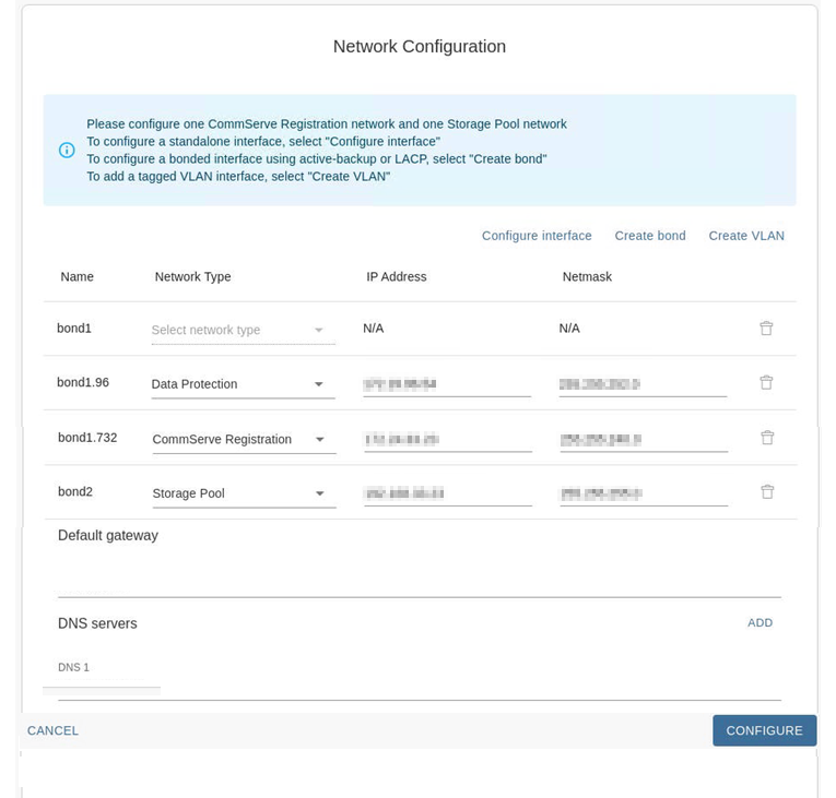

Configure the storage pool interface (bonded) as follows:
Click Create bond.
From the Interfaces list, select the 2 interfaces that will form the storage pool bond. (For example, enpsf4 and enpsf6 .)
Click CREATE.
From the Network Type list, select Storage Pool. This interface will be used exclusively for communication and replication between the HyperScale nodes.
Configure the management interface as follows:
Click Configure interface.
From the Interfaces list, select one of the management interfaces. (For example, enpsf1 or enpsf2.)
Click CREATE.
From the Network Type list, select Management. This interface will be used for all management related communication, such as connecting to the CommServe server, accessing the DNS server, etc.

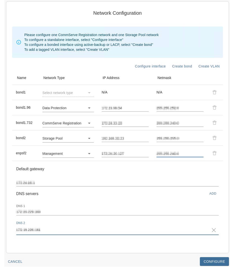

Configure the DNS server(s) as follows:
In the Default Gateway box, add the IP address associated with the default gateway.
In the DNS Servers box, add the IP address associated with the DNS Server.
Click CONFIGURE.

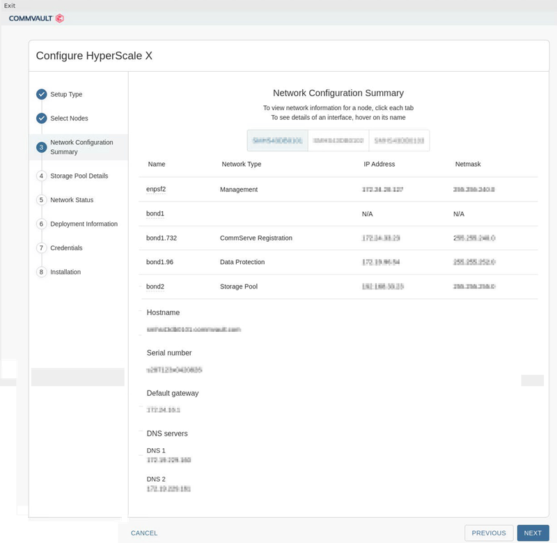

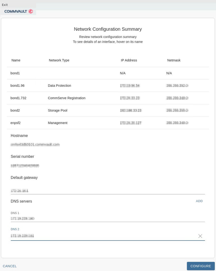

Verify the network configuration and then click CONTINUE.
All the VLANs are included.
IP address and Netmask for the VLANs are accurate.
IP address and Netmask for the storage pool is accurate.
Hostname and serial number associated with the node is accurate.
Default gateway and DNS servers are accurately configured.

Verify the summary for each node by clicking the tabs associated with each node. Ensure that the nodes are accurately configured and then click NEXT.
All nodes have the same number of VLANs.
All nodes have identical information for the VLANs.
All nodes have identical information for the default gateway and DNS servers.
