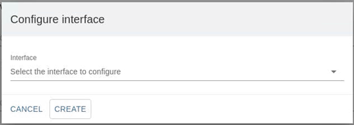

    1. Click Configure interface.
      Tagged VLAN (2)
    3. Click CREATE.

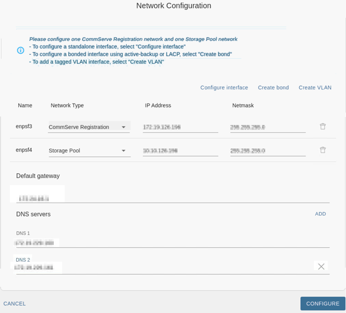

    4. From the Network Type list, select CommServe Registration
      Tagged VLAN (2)
    3. Click CREATE.
      The selected interface appears in the Node and Network Configuration page.
    4. From the Network Type list, select Storage Pool. This interface will be used exclusively for communication and replication between the HyperScale nodes.
  5. Configure the DNS server(s) as follows:
    Basic Deployment (1)
  6. Click CONFIGURE
  7. Verify the network configuration and then click CONTINUE.

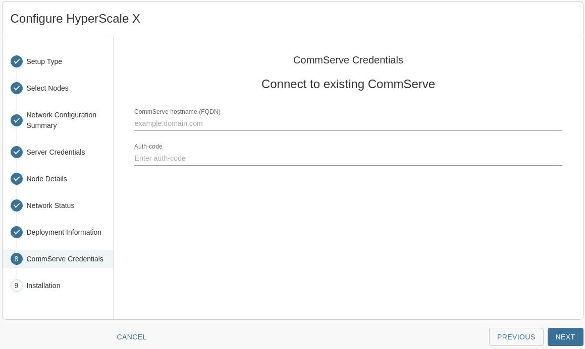

  14. The steps to connect to the CommServe differ based on your environment.
    • In a Software environment, complete the following steps:
      1. Click Connect to existing CommServe, and then click NEXT.
        The CommServe Credentials page appears.
      2. In the CommServe hostname (FQDN) box, enter a fully qualified host name of the existing CommServe server that you are connecting to.
      3. In the Auth-code box, enter the authorization code to connect to the CommServe server.
      4. Click NEXT.

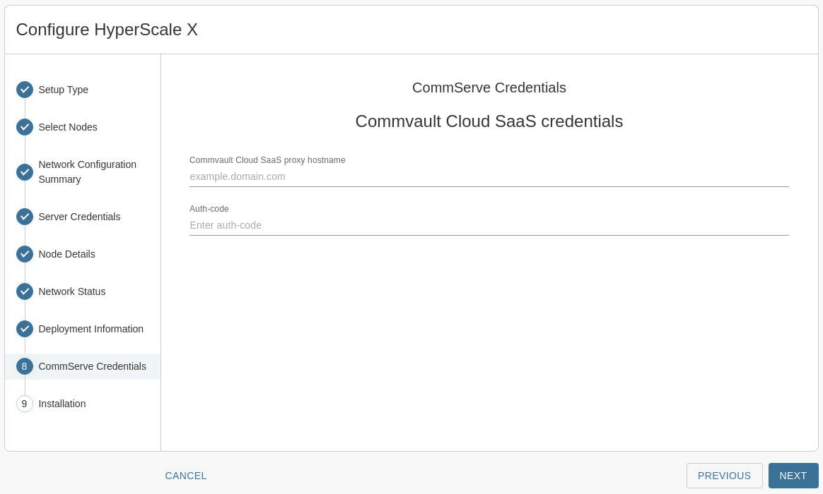

    • In a SaaS environment, complete the following steps:
      1. Click Connect to Commvault Cloud SaaS, and then click NEXT.
      2. In the Commvault Cloud SaaS proxy hostname box, enter the fully qualified host name of the existing backup gateway that you are connecting to.
      4. Click NEXT.
