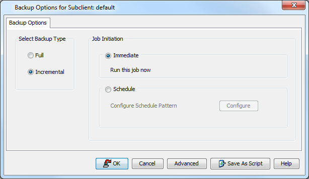

Starting an Incremental Backup
  1. From the CommCell Browser:
    • Navigate to Client Computers | <Client> | Documentum | <Instance>.
    • Right-click the default subclient and click Backup.
  2. By default, Immediate is selected as backup type.
  3. In the Job Initiation section select the Backup Schedule.
    • Click Immediate if you want to run the backup now.
    • Click Schedule if you want to schedule the backup for a specific time.
  4. Click OK. You can track the progress of the job from the Job Controller window of the CommCell console. Once the job is complete, view the job details from the Backup History. Right-click the Subclient and select Backup History.
    inc_backup
