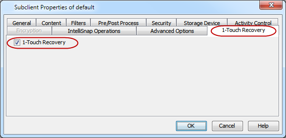

After you install the File System iDataAgent, follow the steps given below to enable 1-Touch for the default subclient:

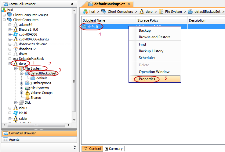

  1. From the CommCell Console, navigate to <Client> | File System iDataAgent | defaultBackupSet.
    Right-click the default subclient and click Properties.
  2. In the Subclient Properties dialog box, click Advanced.
  3. In the Advanced Subclient Properties dialog box, click the 1-Touch Recovery tab.
    Select the 1-Touch Recovery check box.

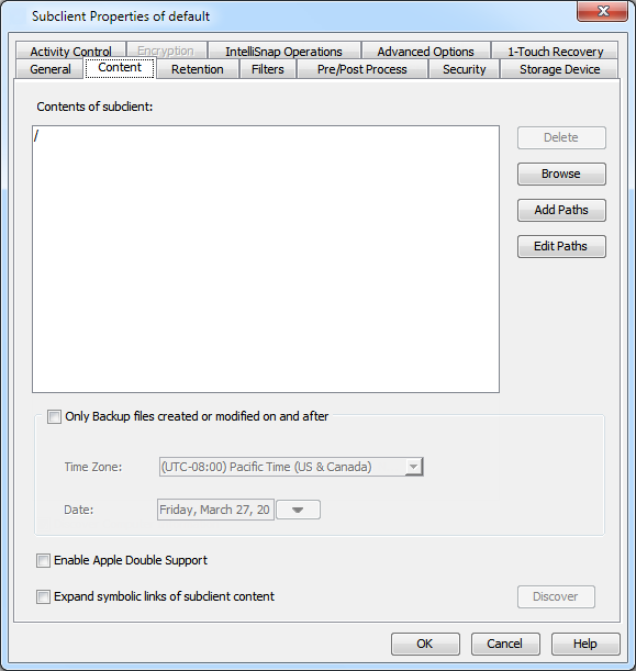

    Right-click a <Subclient>, and click Properties.
  2. Click the Content tab.
    Click Browse.
    Select the root directory (/), and click Add.
    Note: Use filters to exclude specific directories and mount points. Verify that the system mount points are not excluded from backups; otherwise, 1-Touch recovery fails.
    Your backup must contain all files required to turn on the computer and run applications. Do not filter out any OS directories or application files.

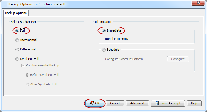

  4. Right-click the <Subclient>, and click Backup.
  5. Click Full as backup type and then click Immediate.

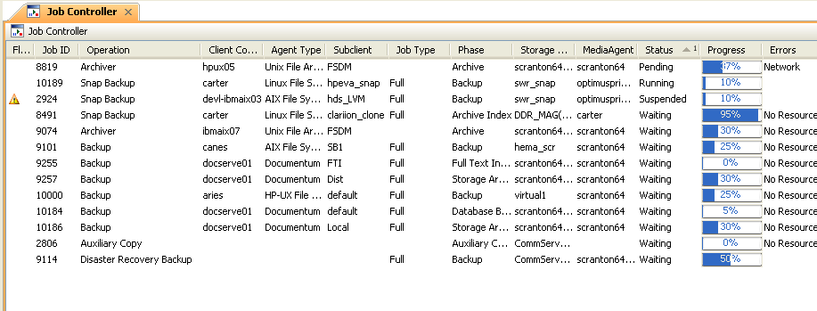

  6. You can track the progress of the backup job from the Job Controller window of the CommCell Console.

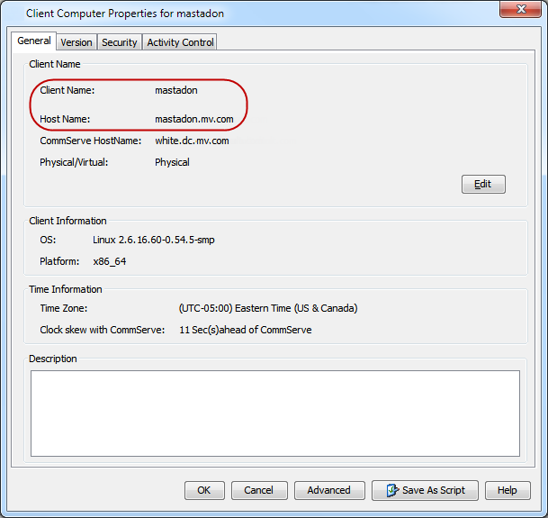

  1. From the CommCell Console, navigate to <Client>.
  2. Right click the <Client> and click Properties.
  3. Select General tab.
  4. Note down the Client Name and Host Name.

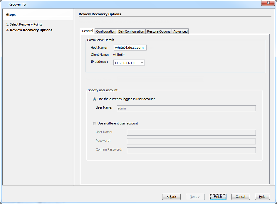

  3. Note down the following related information in the client information checklist:
    • CommServe Host Name
    • CommServe Client Name
    • CommServe IP Address

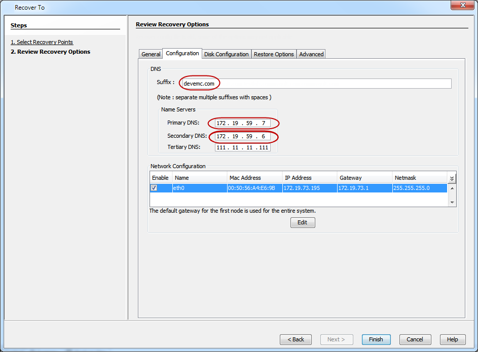

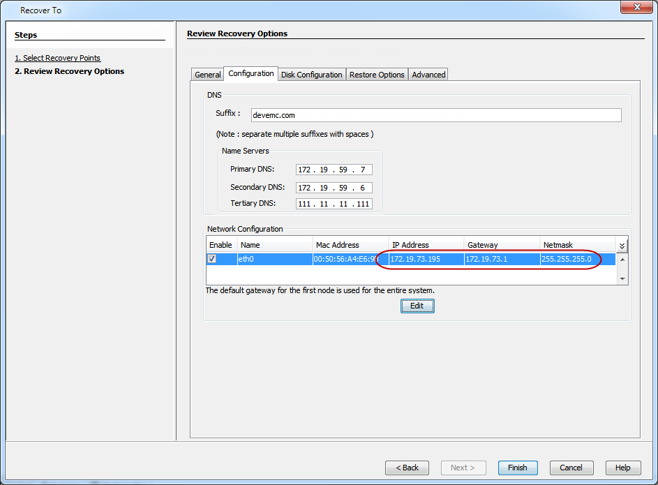

  4. Click the Configuration tab and note down the following information in the client information checklist:
    • DNS Suffix
    • Primary and Secondary Name Server IP address
  5. From the Configuration tab, note down the following information in the client information checklist:
    • Client IP Address
    • Client Gateway
    • Client Netmask
  6. Click Cancel to close the dialog box.

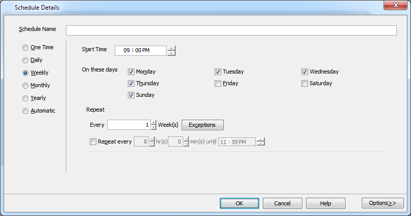

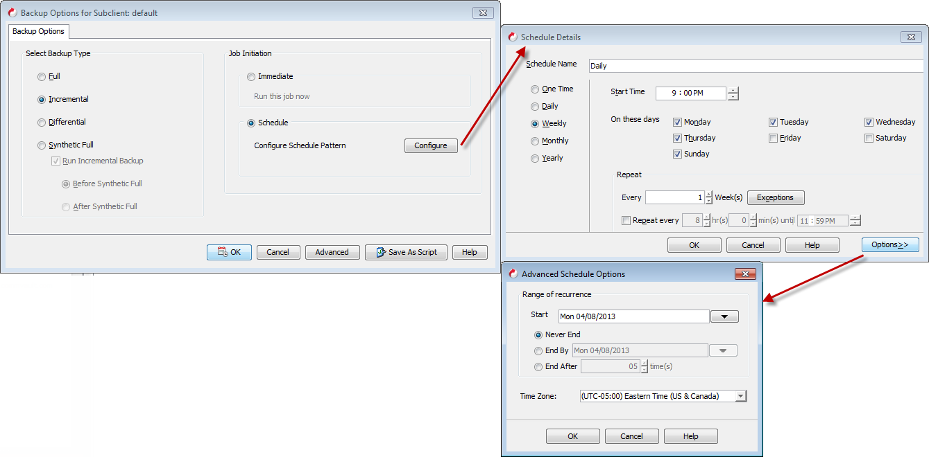

Schedule a Backup
    Right-click the subclient, and click Backup.
  2. Click Schedule to schedule the backup for a specific time.
    Click Configure to set the schedule for the backup job.
  3. Select the appropriate scheduling options. For example:
    • Click Weekly.
    • Check the days you want the run the backup job.
    • Click OK to close the Backup Options dialog
