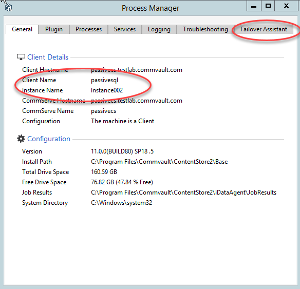

  3. Open the Process Manager associated with the SQL client.
    The SQL client will have the Failover Assistant tab as shown in the following sample image.
    Unplanned Failovers (1)
