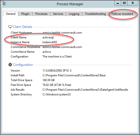

  1. Log on to either the production CommServe host computer, or the standby CommServe host computer.
  2. Click Start and point to All Programs.
  3. Click Commvault > Process Manager. Open the Process Manager associated with the SQL client.
    The SQL client will have the Failover Assistant tab as shown in the following sample image.
    Failover steps (1)
  4. On the Failover Assistant tab, select the following options:
    • From the Failover To list, click the name of the passive node that must be used for performing the failover.
    • From the Failover Type list, click Production.
  5. Click Initiate Failover.
  6. On the Confirm prompt, type confirm and click Ok.
  • The failover is initiated and the sequence of tasks performed during the process is displayed in the Process Manager window.
  • A DDB Resynchronization job will also be automatically initiated after the failover.
