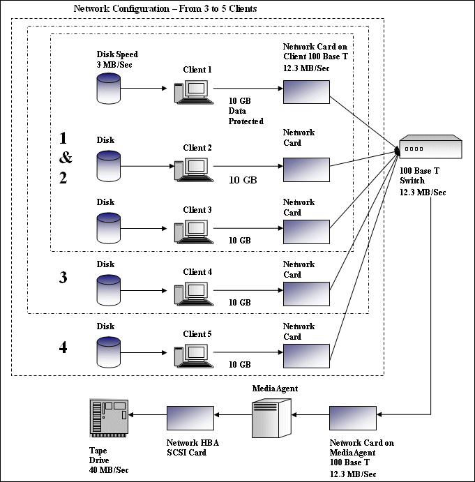

The following examples illustrate a typical network configuration of three to five clients, and calculations are provided based on the data protection time needed to protect these clients, with and without data multiplexing.
See the following examples:
Example Of Multiplexing
Example 1 - Without Multiplexing
In the example above, three clients with disk read speeds of 3 MB/Sec are protecting 10 GB of data sequentially. The clients are connected to a switch with a speed of 12.3 MB/Sec, then are connected to a MediaAgent, and are connected to a tape drive with a speed of 40 MB/Sec. Without multiplexing, the time taken to protect 30 GB of data is as follows:

Example 2 - With Multiplexing of Three Clients
In the same example, if the multiplexing factor is set to 3, Client 1, Client 2, and Client 3 will perform their data protection operations in parallel, and:

Example 3 - With Multiplexing of Four Clients
In the same example, if the multiplexing factor is set to 4, Client 1, Client 2, Client 3, and Client 4 will perform their data protection operations in parallel, and:

Note that all four clients in this example are going to a network switch that has a speed of 12.3 MB/Sec. The total tape drive throughput of all clients that are multiplexed should not exceed this speed.
Example 4 - With Multiplexing of Five Clients (Over Multiplexing)
In the same example, if the multiplexing factor is set to 5, Client 1, Client 2, Client 3, Client 4, and Client 5 will perform their data protection operations in parallel, and:

However, because the network switch has a maximum speed of 12.3 MB/Sec, the maximum throughput of the drives cannot exceed 12.3 MB/Sec. Therefore:
The total tape drive throughput of all clients that are multiplexed has exceeded the speed of the network switch, and you have over-multiplexed.
Backups of the clients have even become slower, reducing their speed to 2.46 MB/Sec.
