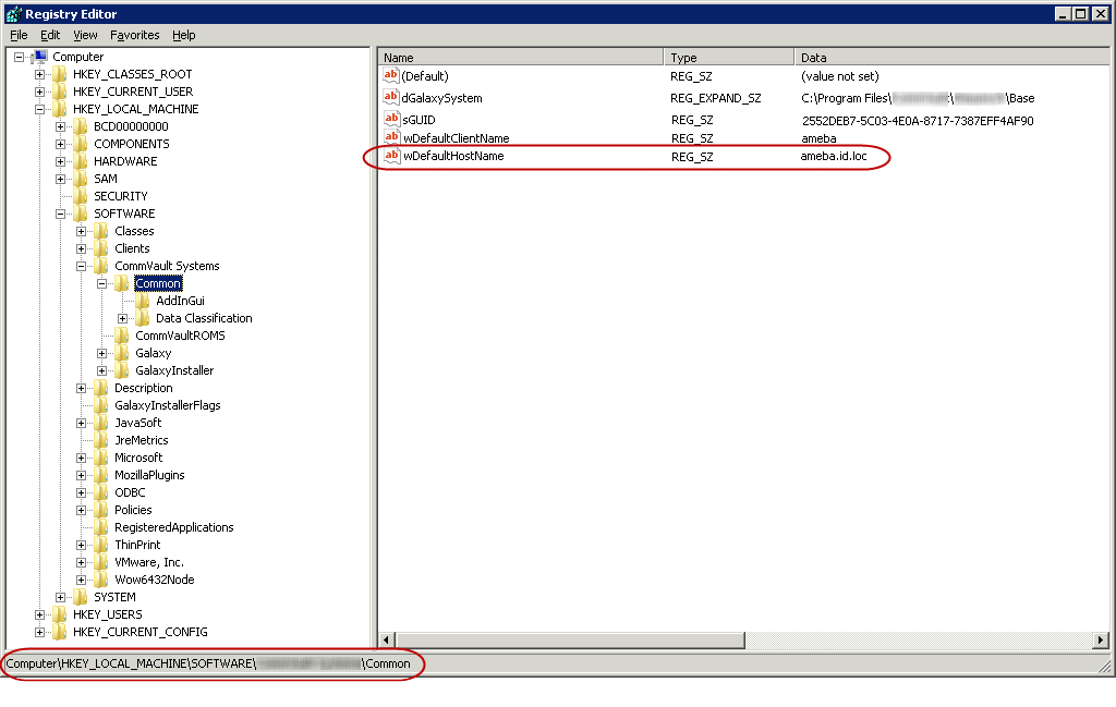

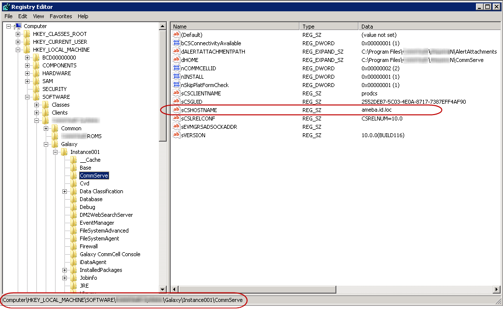

The registry on the CommServe (CS) will have two locations that show the CS Host Name when it also has a Client (CL) installed. For the CommServe Name used by the Clients other then the CommServe Client the registry entry for sCSHOSTNAME is located under \HKLM\Software\Commvault Systems\Galaxy\Instance001\CommServe  For the CommServe with a Client (CL) File System Agent installed, the name is hosted at this registry location. Registry entry for wDefaultHostName is located under \HKLM\Software\Commvault Systems\Common
Now to get the information for the MediaAgent (MA) or the Client (CL), locate the MA or CL in the CommCell Browser window, right click, and then click Properties. On the General tab, the host name and the CommServe host name will be displayed.
Now once the MediaAgent (MA) and/ or Client (CL) CommCell information is confirmed, go to the MA and/or CL and review the registry entries for the Name. -

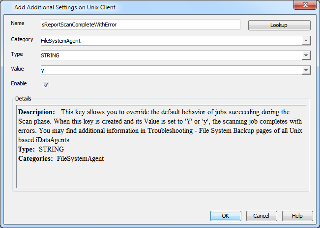

Unable to open a directory during scan To view the "Completed w/ one or more errors" message in the Job History in the Scan phase, follow the steps given below:
From the CommCell Browser, navigate to Client Computers.
Right-click the <Client> and click Properties.
Click Advanced and then click Additional Settings tab.
Click Add.
In the Name field, type sReportScanCompleteWithError. The Category and Type fields are populated automatically.
In the Value field, type y or Y to enable the error message display or n or N to disable the error message display..
Click OK.  During backups the jobs will be marked partial success and reported into Failures.cvf, in the following scenarios:

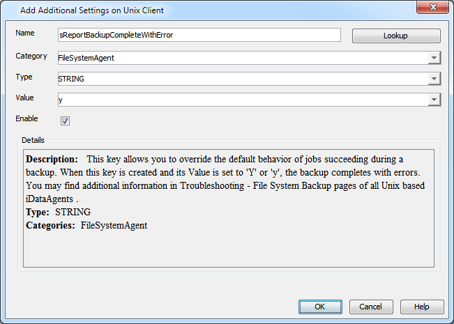

To view the "Completed w/ one or more errors" message in the Job History after a backup, follow the steps given below:
Click Add.
In the Name field, type sReportBackupCompleteWithError. The Category and Type fields are populated automatically.

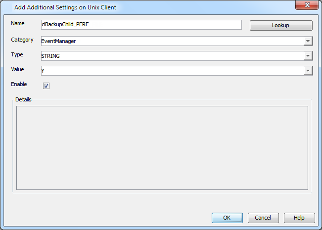

In the Name field, type clBackupChild_PERF. The Category and Type fields are populated automatically.
In the Value field, type Y.
Displaying Performance Details for Each File in a Backup Job In addition to viewing the performance details for a backup job, you can also view the performance details of each file in the backup job. Note that the file names are not printed in the log. Procedure -

Check the sCSHOSTNAME additional setting. -
Right-click the <Client> or <MediaAgent>, and then click Properties.
Click Add.
In the Name box, type sCSHOSTNAME.
In the Value box, if the current string value has _Disabled_ appended at the front of the string value, remove it to allow communication to the CommServe.
Click Add.

 Special Case Scenario: This resolution does not work if the pNET password on the MediaAgent or Client and the entry in the CommServe database do not match. -
Check the CVD.log on the MediaAgent or Client for these entries: 3756 d98 04/25 16:17:23 ### [ClientSessionWrapper::connectToCS] Error connecting to svc [AppManager network access] on CS. [150994982-[CVSession::authenticateClient]:Remote system [servernameFQDN]. Failed authentication returned from server.] 3756 d98 04/25 16:17:23 ### ClientInterfaceNet::lookup() - [ClientSessionWrapper::connectToCS] Error connecting to svc [AppManager network access] on CS. [150994982-[CVSession::authenticateClient]:Remote system [servernameFQDN]. Failed authentication returned from server.] 3756 d98 04/25 16:17:23 ### ::UpdateClientInfo() - Failed to do the client lookup for CLHostName 3756 d98 04/25 16:17:23 ### ::UpdateClientInfo() - Session connect failed with error code 150994982 - [CVSession::authenticateClient]:Remote system [servernameFQDN]. Failed authentication returned from server., Generic error 150995034 3756 d98 04/25 16:17:23 ### ::UpdateClientInfo() - Setting nChaterFlag to 1 to stop all communications 3756 d98 04/25 16:17:23 ### ::UpdateClientInfo() - Setting nDISABLE_CVFWD to 1 to stop all communications 3756 d98 04/25 16:17:23 ### ::UpdateClientInfo() - CS Host Name set to _Disabled_servernameFQDN to avoid any contact from this client to CS
Check for a matching entry with same Date/Time stamp in the CVD.log file on the CommServe: 4532 92c 04/25 15:08:33 ### EvSANVolMgr::DiscoverFLRSupportedApps() - CVSession::attach() to [ipaddress*CLHostName*8400*8402] returned error 9000026 4532 92c 04/25 15:08:33 ### ::sendResponse() - FAILED [Failed to connect to remote host [ipaddress*CLHostName*8400*8402].] 3196 bc0 04/25 16:17:23 ### [CVD ] ** CVD_CVSESSION_ERROR: RemoteHost=ipaddress? Error replying to attach on socket: 900002a=[CVSession::authenticateServer]:Remote system [ipaddress]. Password received from client did not match the database password for that client - authentication failed.
