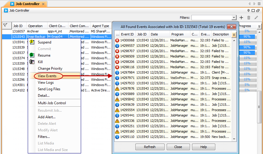

Viewing Events
You can view the events occurring within a CommCell from the Job Controller. By default, an event is automatically created in the Event Viewer for all the jobs and operations running in a CommCell.
Use the following steps to view the events of an active job in the Job Controller:
From the CommCell Console ribbon, click the Home tab and then click Job Controller.
Right-click any running job and click View Events. All the events associated with the selected job will be displayed.
