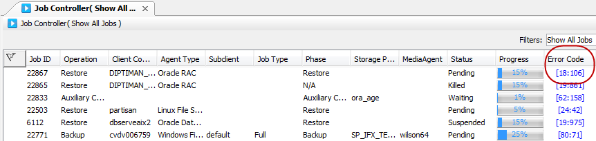

Viewing the Error Codes for a Job
If a job has not completed successfully, the Error Code column will display a unique code linking to available troubleshooting and knowledgebase article(s) relevant to that error from the customer support website. These articles may include special considerations for the type(s) of job(s) you are running, suggested workarounds for issues, and common causes for that particular error.
If an error code pertains to more than one issue, the customer support website will display links to all articles for which the code is relevant. Conversely, if an error code does not have any articles associated with it, the customer support website will display a message indicating that no articles exist for that code.
Note that jobs which fail Data Integrity Validation will be moved to pending status. Review the error code and description of the pending job from the Job Controller to identify the reason for failure. See Handling Data Integrity Validation Errors for troubleshooting Data Integrity Validation errors.
Use the following steps to view the error codes of a job which has not completed successfully:
From the CommCell Console ribbon, on the Home tab, click Job Controller.
  1. In the Job Controller window, right-click any column heading and click Choose Columns | Error Code.
    The Error Code column is displayed in the Job Controller window.
  2. For a failed job, click on the error code in the Error Code column to launch the Customer Support website.
    view_error_code
  3. Enter your credentials for the Customer Support website.
  4. Review the troubleshooting articles related to the error code.
    The Customer Support website displays links to all relevant articles. If an error code does not have articles associated with it, the customer support website displays a message indicating that.

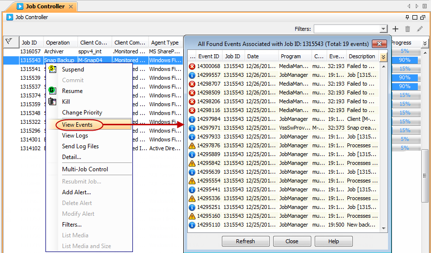

Viewing Events
You can view the events occurring within a CommCell from the Job Controller. By default, an event is automatically created in the Event Viewer for all the jobs and operations running in a CommCell.
Use the following steps to view the events of an active job in the Job Controller:
  1. From the CommCell Console ribbon, click the Home tab and then click Job Controller.
  2. Right-click any running job and click View Events.
    All the events associated with the selected job will be displayed.
view_events
