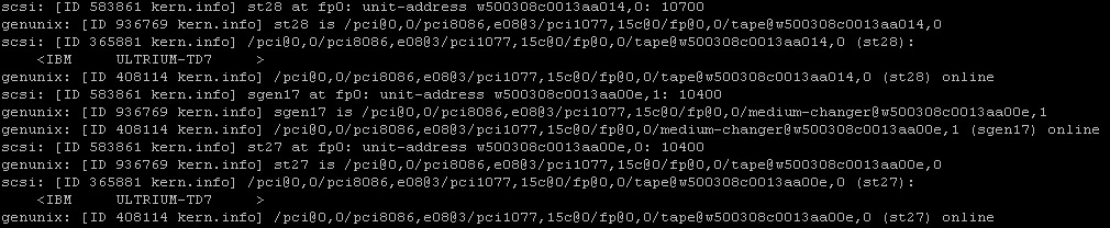

  1. Confirm that the st driver is bound to the connected drives through /var/adm/messages log.
    • If the drives are not bound to the st driver in the message log, go to step 2.
    • If the drives are bound to the st driver in the message log, go to step 6.
    Example of a library with two drives of like model type:
    Note: IBM ULTIUM-TD7 drives are bound to st27 and st28 in the image.

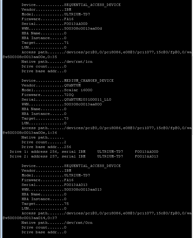

  7. Run the ScanScsiTool found in the <software installation path>/Base folder to obtain the native path for each drive type connected.
    Example of ScanScsitool output for a library and two like model drives:
    lib_example01
  8. Run ScanScsiTool with –T and [native path] of drive.
    For example:
    lib_example02
    Note: The output of the ScanScsiTool with –T and [native path] of each drive type will be required if the library has mixed drive types, or there are several libraries with different drive types attached to the Solaris MediaAgent.
