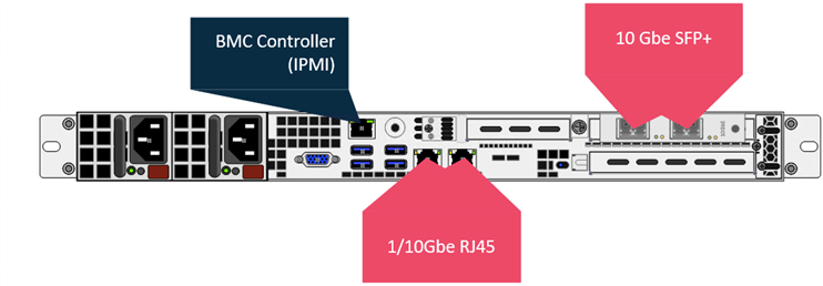

  • Make sure that the appliance is properly racked and secured as described in Racking and Cabling the Remote Office Appliance RO1200.
  • Connect the IPMI (or BMC Controller) port to the IPMI network.
    Click here to view the IPMI port for RO1200

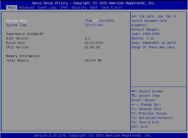

  1. Power on the appliance.
  2. Press <DEL> during the boot splash screen. The Setup Utility will be displayed.

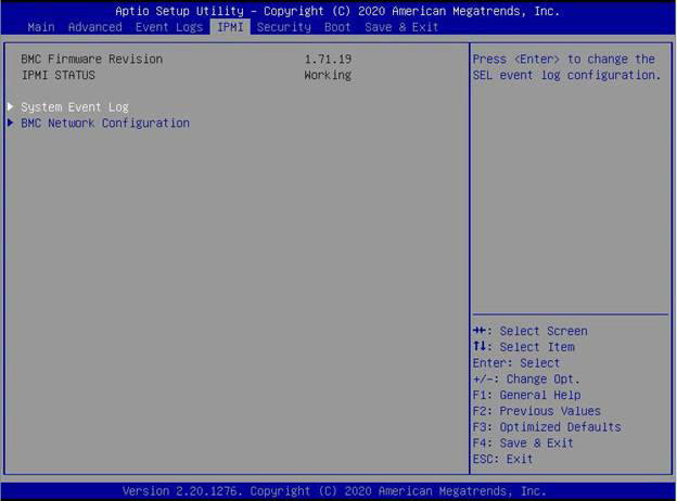

  3. Navigate to the IPMI tab.
    Setting up a Static IP For IPMI (3)

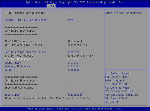

  4. Navigate to the BMC Network Configuration option.
    Press <Enter> to select the option.
  5. Set Update IPMI LAN Configuration to [Yes].
  6. Set Configuration Address Source to [Static].
    Setting up a Static IP For IPMI (2)
  7. Enter values for the Station IP Address, Subnet Mask, and Gateway Address for the selected appliance.
  8. Press <F4> to save and exit the Setup Utility.

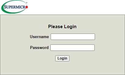

    1. Open a web browser from a remote workstation and enter the static IP of the IPMI.
    2. The login screen will be displayed.
      Setting up a Static IP For IPMI (4)
    3. Type in the credentials for the default administrator account as follows:
      Username: ADMIN
      Password: ADMIN
      The IPMI password can be changed later from the IPMI Web Server interface. For more information, see Changing the IPMI Password on Remote Office Appliance RO1200.
    4. Click Login.

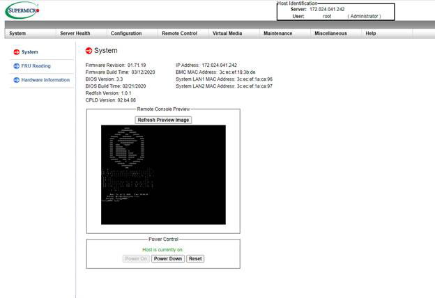

      The IPMI Web Server interface is displayed.
      Setting up a Static IP For IPMI (5)
  10. Launch the Remote Console window as follows:
    1. Click inside the Remote Console preview.
      This will launch a Java Applet.
    2. Run the Java applet to start the Remote Console Window.

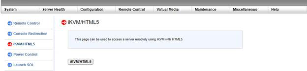

      Alternatively, if you do not want to use Java Applet, you can use HTML5 viewer. Click Remote Control > iKVM/HTML5 and then click the iKVM/HTML5 button.
      Setting up a Static IP For IPMI (6)
