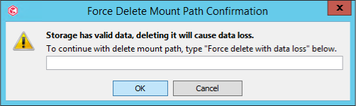

    • If you shared the mount path with a MediaAgent that is online with write access and with Feature Release 21 or later version, then the following dialog box appears.
      Delete_Mount_Path_With_Data_FR21

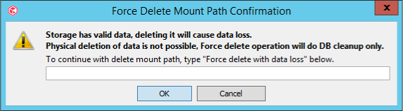

    • Otherwise, the following dialog box appears.
  4. Enter Force delete with data loss, and then click OK.
