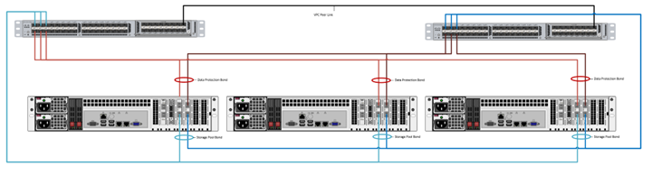

Can HyperScale X be dual-homed to multiple switches using Cisco Virtual Port Channel (VPC)?
Yes, HyperScale X supports using LACP over Cisco VPC.
HyperScale X fully supports multi-switch link aggregation implementations from most vendors including Cisco VPC, Arrista mLAG, and Mellanox mLAG.
See the following image for an example of the cabling configuration using Cisco VPC:
When configuring the network for Commvault HyperScale X nodes with multi-switch link aggregation implementations, use the configuration steps described in LACP Bonding.
