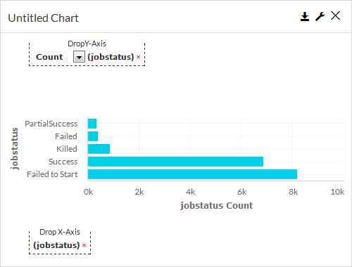

Horizontal bar charts display data in a series of bars that run from left to right. Horizontal bar graphs use the y-axis for labeling categories, while numeric data is measured along the x-axis. This type of chart is useful if the label text for categories is particularly long.
horizontal_bar
Drop Y-Axis
In a horizontal bar chart, the y-axis includes numeric information, such as the number of client computers or jobs in each status.
Drop X-Axis
In a horizontal bar chart, the x-axis includes text-based information, such as client computer names or job statuses.
