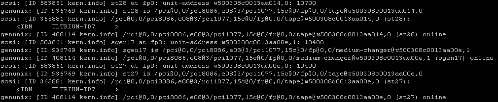

Example of a library with two drives of like model type:
Note: IBM ULTIUM-TD7 drives are bound to st27 and st28 in the image.
