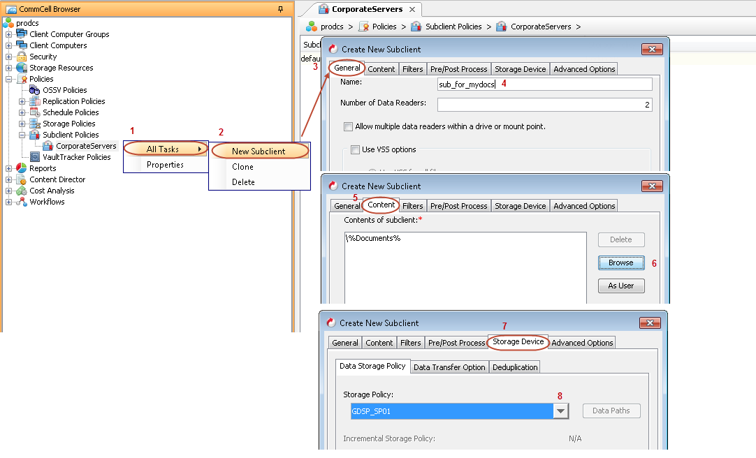

Creating User-Defined Subclients for a Subclient Policy
Use the following steps to create a user-defined subclient for an existing subclient policy:
  1. From the CommCell Browser, go to Policies > Subclient Policies.
  2. Right-click an existing subclient policy and click All Tasks > New Subclient.
  3. Enter the name for the new subclient in the Name box.
  4. Click the Content tab.
  5. Enter the contents for the subclient by browsing to them or by entering their path.
  6. Click the Storage Device tab.
  7. Select the storage policy from the Storage Policy drop-down list.
  8. Click OK.
    The user-defined subclient is automatically created for all clients where the subclient policy is associated.
user_def_sub

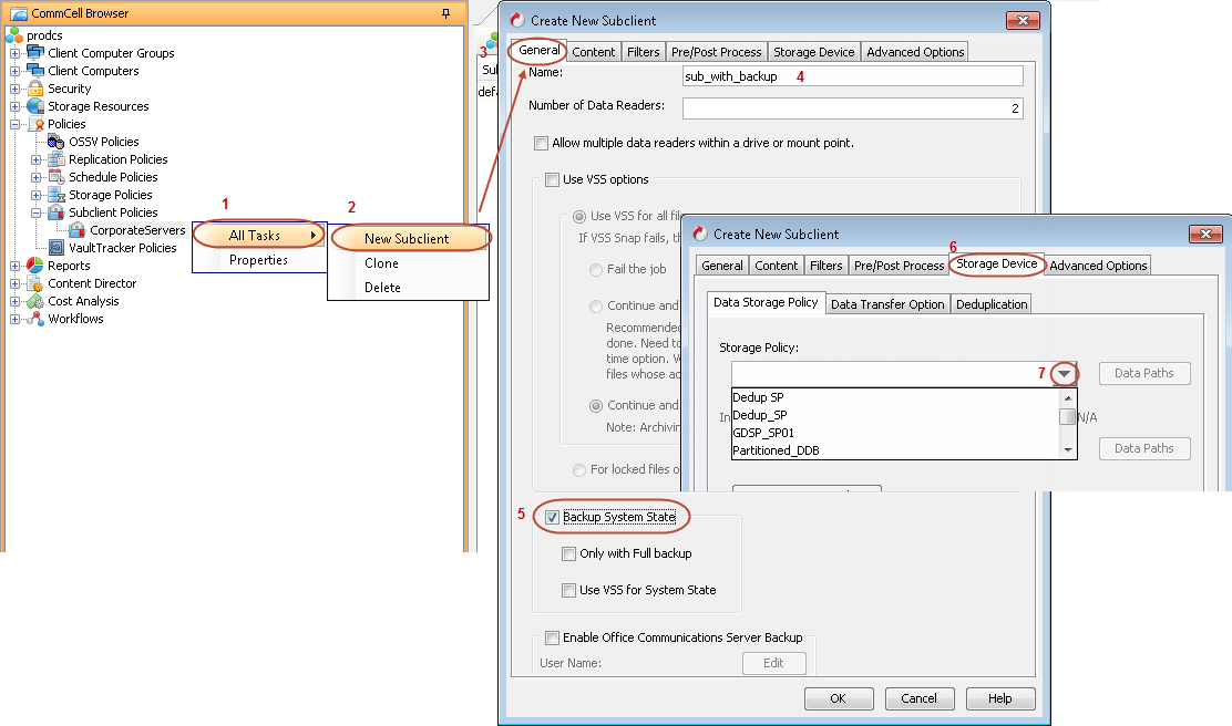

Creating a System State Backup Subclient Policy
Use the following steps to create a system state backup policy:
  4. Select the Backup System State check box.
  5. Click the Storage Device tab.
  6. Select the storage policy.
  7. Click OK.
adv_sys_st

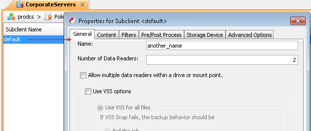

Renaming the Subclients Associated with a Policy
Use the following steps to rename a subclient:
  1. From the CommCell Browser, go to Policies > Subclient Policies > policy.
  2. Right-click the subclient and then click Properties.
  3. Enter a new name in the Name box.
  4. Click OK.

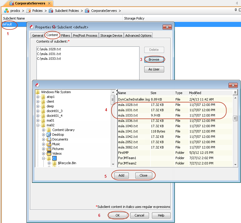

Modifying the Content
Use the following steps to modify the content:
  3. Click the Content tab.
  4. Click Browse, go to the path that you want to define as the subclient content, and click Add. After defining the content, click Close.
    You can also use wildcards to define the subclient content. For more information on available wildcards, see Supported Wildcards.
    If the subclient content consists of wildcard characters and no eligible files are found for backup, then the backup operation will complete successfully even though no files were backed up.
  5. Click OK.

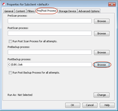

Adding Pre-processes and Post-processes
Use the following steps to add pre-processes and post-processes:
  4. Click Browse next to the type of pre-process and post-process that you want to add, go to the path to the file with the process, and click Add. Once the path is added, click Close.
  5. Click OK.
adv_sub_sc_9

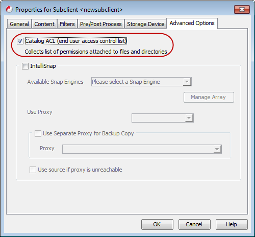

Enabling End-User Access Control during Backups
You can limit CommCell users to browse/find the files and directories on which they have access. Other files will be filtered out and made invisible during the browse operations.
Use the following steps to configure a subclient with this restriction:
  3. Click the Advanced Options tab.
  4. Click the Catalog ACL (end user access control list) check box.
    If you select/clear this option between backup jobs, it is recommended to run a full backup for the selected option to take effect.
  5. Click OK.
subclient_acl_catalog

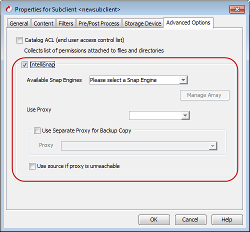

Configuring a Subclient to Run IntelliSnap Backups
Use the following steps to start running IntelliSnap backups for a subclient:
  4. Click the IntelliSnap check box.
  5. Select a snap engine from the list of Available Snap Engines list.
  6. Click Manage Array if you need to configure the storage array to be used by the IntelliSnap backups.
  7. Select the client computer from the Proxy list.
  8. Click OK.
subclient_snap_config

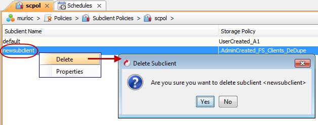

Deleting User-Defined Subclients from a Policy
When you delete a user-defined subclient, it is removed from the subclient policy and the client to which it is associated.
Use the following steps to delete a user-defined subclient:
Default subclients cannot be deleted.
  1. From the CommCell Browser, go too Policies > Subclient Policies >policy.
  2. Right-click a subclient in the window to the right and click Delete.
  3. Click Yes.
delete_subclient

Deleting a Subclient Policy
When you delete a subclient policy, its associated clients retain the properties of the policy.
Use the following steps to delete a subclient policy:
  2. Right-click an existing subclient policy and then click All Tasks > Delete.
  3. Click Yes in the message.
