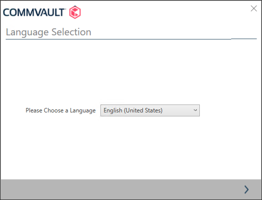

    The Language Selection page appears.
    embd_Installing the Standby CommServe Host procedure (10)
  4. Select the language from the Please Choose a Language list, and then click the arrow to proceed.

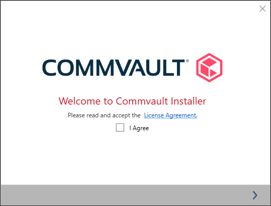

    The Welcome page appears.
    embd_Installing the Standby CommServe Host procedure (11)
  5. Select the I Agree check box, and then click the arrow to proceed.

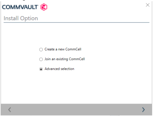

    The Install Option page appears.
    embd_Installing the Standby CommServe Host procedure (30)
  7. Select Advanced selection, and then click the arrow to proceed.

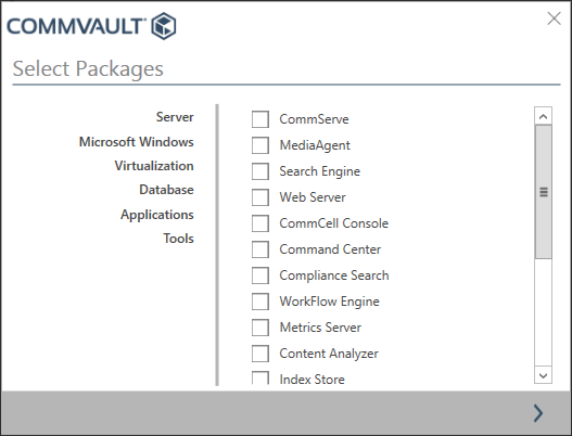

    The Select Packages page is displayed.
    embd_Installing the Production CommServe Host procedure (29)
  8. Select the following check boxes, and then click the arrow to proceed.
    • CommServe check box
    • CommServe Failover check box (Scroll through the list to locate this package.)
      The CommServe Failover package automatically installs the SQL Server agent and the CommServe Failover packages in a new instance. (No additional user intervention is needed.)

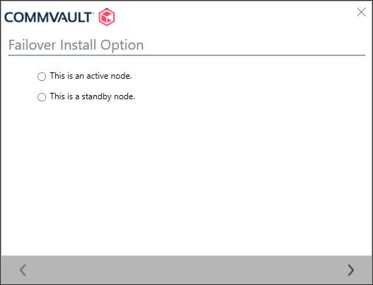

  10. The Failover Install Option page appears.
    embd_Installing the Standby CommServe Host procedure (14)
  11. Select This is a standby node, and then click the arrow to proceed.

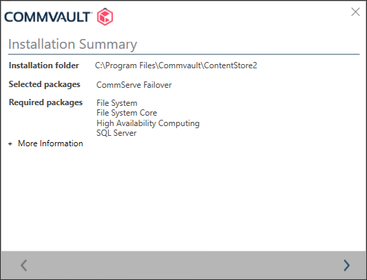

    The Installation Summary page appears.
    embd_Installing the Standby CommServe Host procedure (16)
  13. Verify the list of packages, and then click the arrow to proceed.

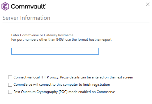

  15. Select / enter the following information:
    • Type the Fully Qualified Domain Name (FQDN) of the production CommServe host.
    • Select the CommServe will connect to this computer to finish registration later option if the CommServe computer must initiate communications with the client.
    • Select Post Quantum Cryptography (PQC) mode enabled on Commserve if PQC is enabled on the CommServe server. PQC encrypts and decrypts data to protect it from attacks by quantum computers.
      • Post Quantum Cryptography does not work in multi-CommCell environments.
      • Post Quantum Cryptography can be enabled only when setting up a new CommCell environment. It cannot be enabled on an existing CommCell environment in which the CommServe computer is already installed.
      • For information about enabling PQC, see Enabling Post Quantum Cryptography.
    Click the arrow to proceed.

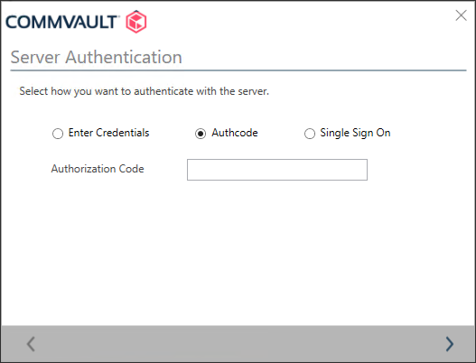

    The Server Authentication page appears.
    embd_Installing the Standby CommServe Host procedure (20)
  16. Select an authentication method for accessing the production CommServe host, and then click the arrow to proceed.

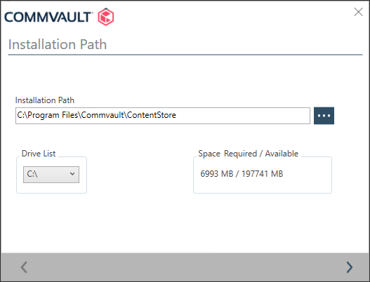

    The Installation Path page appears.
    embd_Installing the Standby CommServe Host procedure (22)
  18. Verify the path (or specify a new the path) for the standby CommServe server, and then click the arrow to proceed.

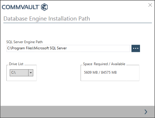

    The Database Engine Installation Path page is displayed.
    embd_Installing the Production CommServe Host procedure (34)
  20. Verify the database engine installation path (or specify a new path) and then click the arrow to proceed. (This is the path for installing Microsoft SQL Server.)

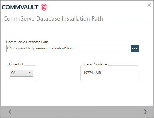

    The CommServe Database Installation Path page appears.
    embd_Installing the Standby CommServe Host procedure (24)
  21. Verify the CommServe database installation path (or specify a new path) and then click the arrow to proceed. (This is the path for storing the CommServe server databases.)

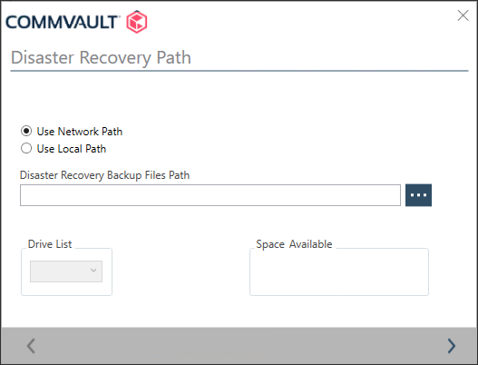

    The Disaster Recovery Path page appears.
    embd_Installing the Standby CommServe Host procedure (25)
  22. Select Use Network Path or Use Local Path, enter the path in Disaster Recovery Backup Files Path, and then click the arrow to proceed.

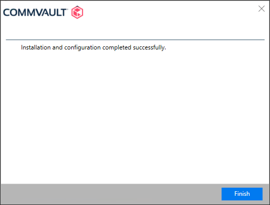

    The software creates the databases and services. This process may take a few minutes.
    A message similar to the following appears:
    embd_Installing the Standby CommServe Host procedure (27)
  24. Click Finish to complete the installation.
  • To troubleshoot errors that occur before the installation summary page, check the %allusersprofile%\Commvault Systems\Galaxy\LogFiles\Install.log file.
If the error occurs after the summary page, check the installation logs in the software_installation_directory\Log Files folder.
