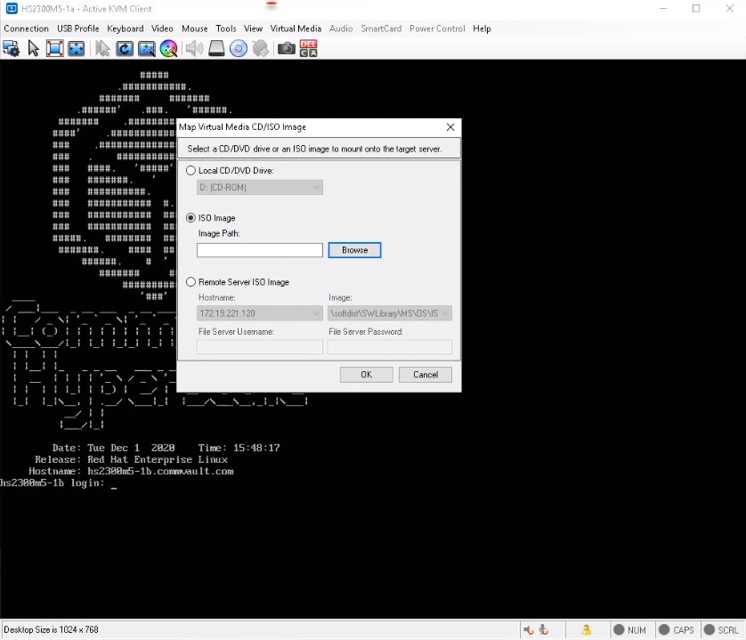

Access the node using the KVM management console in your environment.
Map the downloaded ISO image as a virtual media from the KVM Management console.
Click here to view a sample image.

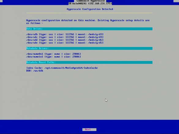

The HyperScale Configuration Detected screen is displayed.
Choose Next.

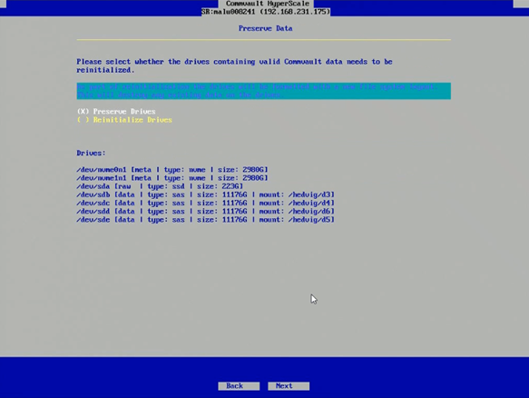

The Preserve Data screen is displayed.
Choose the Preserve Drives option and then click Next.

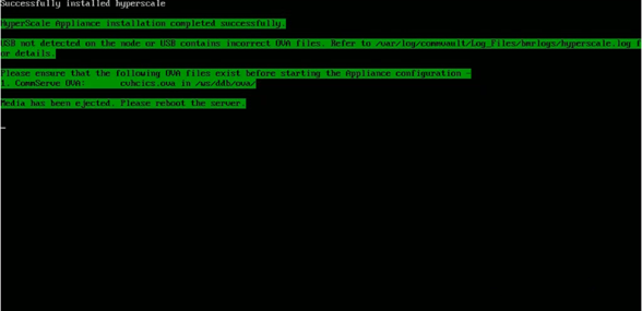

The installation process will be started. This process will take some time to complete.
The following message will be displayed once the installation is complete.
Reboot the node.
